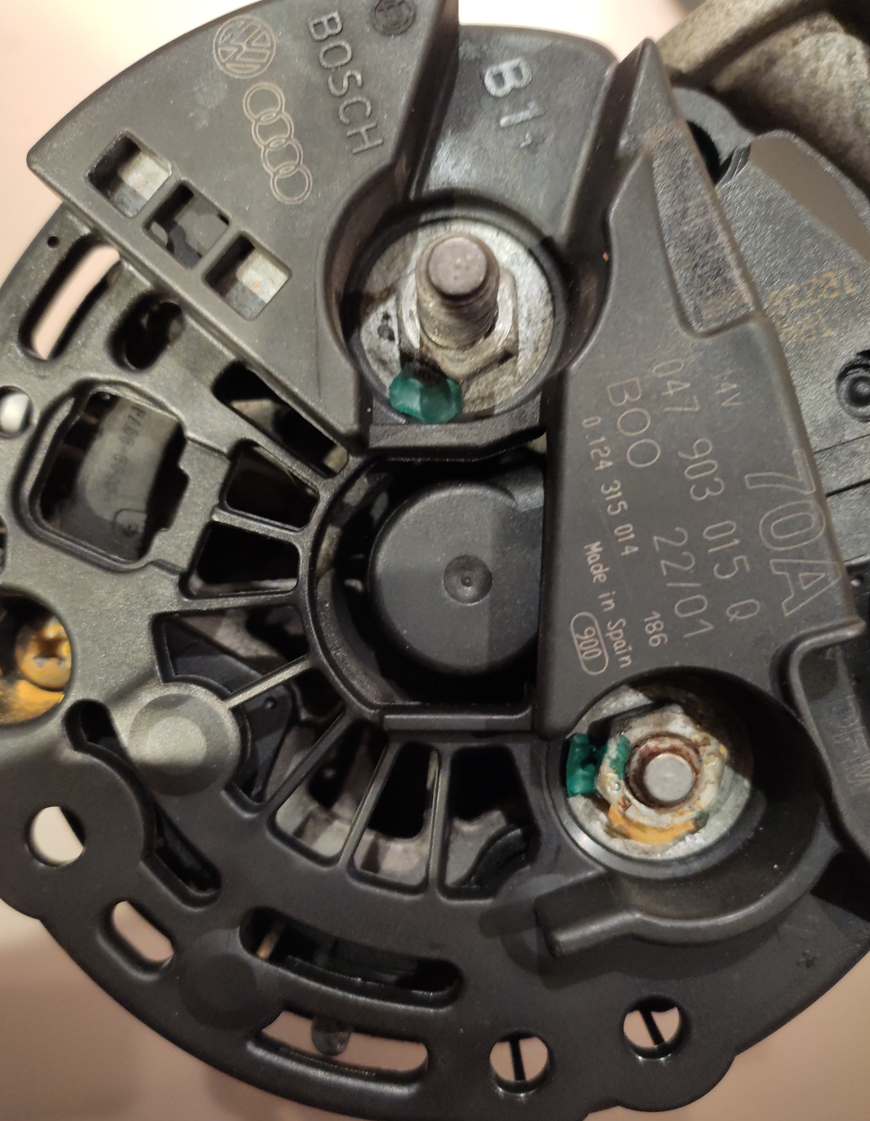

P.S, I made a post in 2017 about the old alternator, and the L and DFM voltages are still the same now as back then. The load was reported correctly even in the VAGCOM logs. I hope I still can get a new alternator that will meet the OEM specs of the 047903015Q. "* The two signal cables (L1 and DFM) at the alternator read 11.5v from the car with the contact on (not running) and the signal cables and connectors look good. Battery light stays off when the alt. signal connector is disconnected when on contact > ok " Here are some pics of my BCM in case anyone need them (if they have issues with L1). Including some pics of the relaybox and positive connections in front of it. -

Thank you Pete. I've already ordered a new alternator (Dynamo Volkswagen 70A 305.526.070.010 PlusLine) that will arrive tomorrow because this one is not trustworthy or serviceable anymore. An alternator is replaceable, but your 'men's best friend' is not. But I'll do a proper testing sequence soon when I have enough time to focus. That is useful information about the two wires. What is the correct workflow of the battery light on the dash? contact on > battery light on > engine starts > alternator starts > regulator modulates the voltage over the blue wire > ECU sees regulator is working > ECU turns off battery light? -

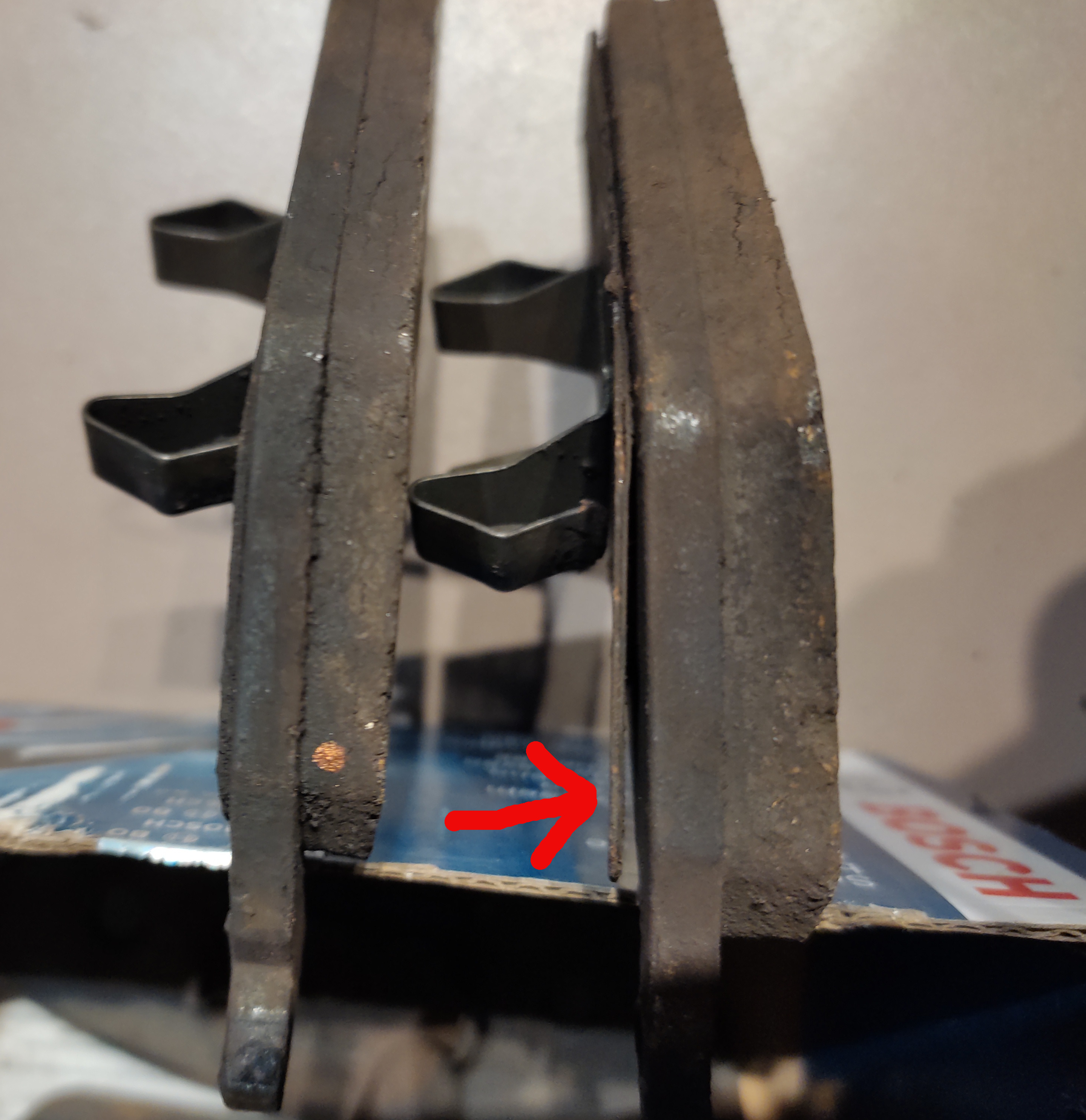

Thank you. So that is normal, though it was turned a bit around it axis. I guess these pads were long past their service-life indeed.

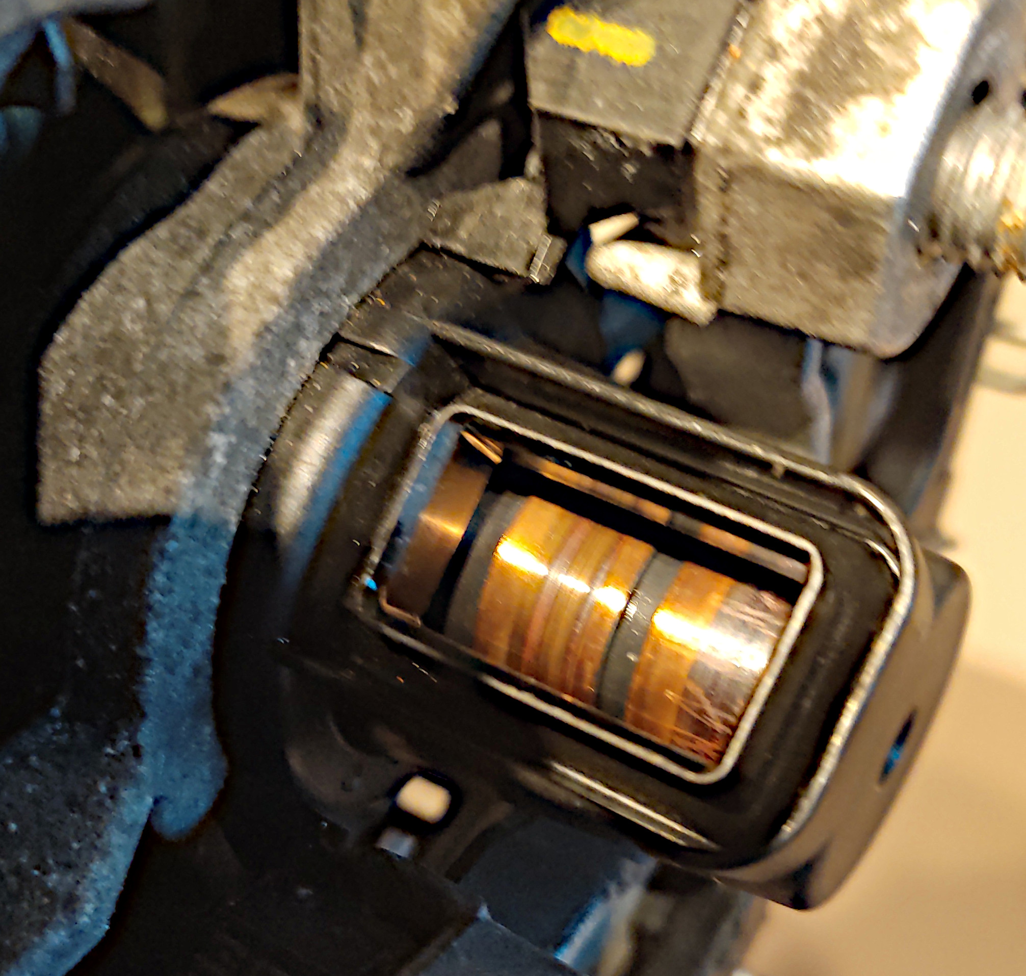

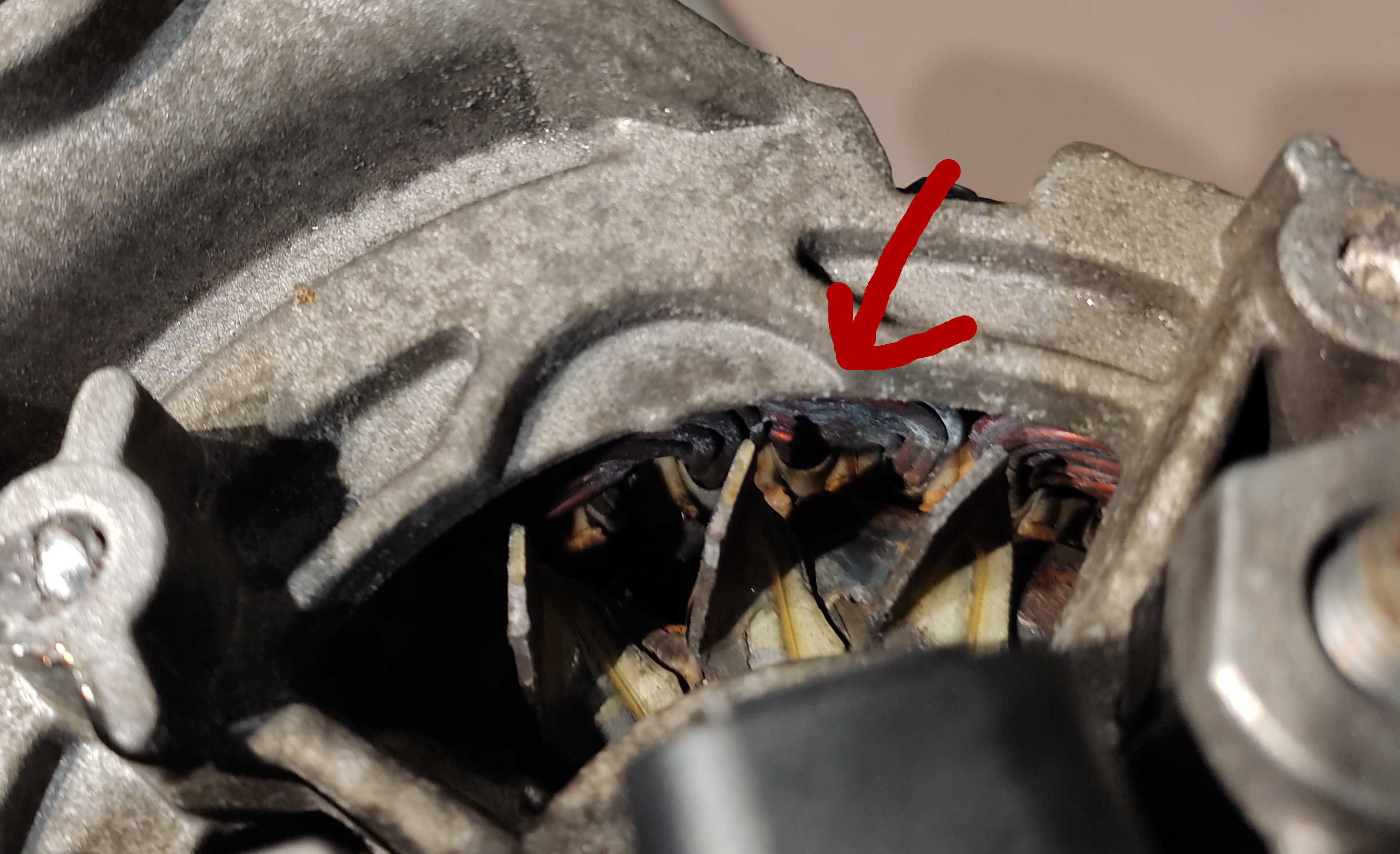

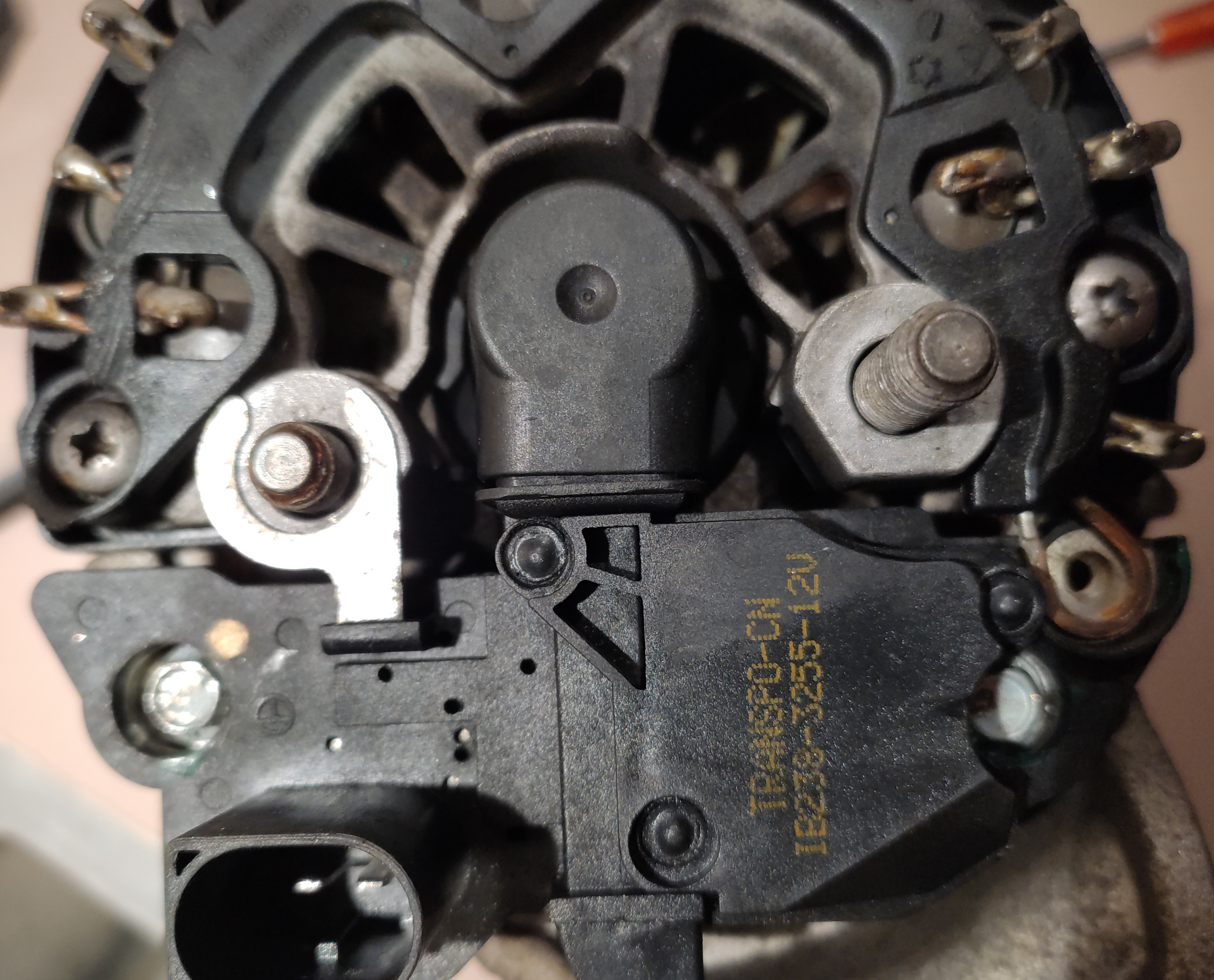

My 22yo alternator failed after the rainy a stormy days of storm Ciarán. Normally the battery light goes on while making contact, and it should go out after a second or one/two after starting the car. This time the battery light stayed on and I measured 12.17v on the cigarette lighter > alternator not working, so I shut off the car. 30 min later the alternator was working again at 14.2v, but the voltage dropped to 13.90v when my lights where on. 13.75v with the blower at 2500rpm (it's been that way for many years). I measured the voltage drop between the alternator > battery (pos and ground) on all major locations, which are the same including the battery itself: 0,06v on the pos, and 0,01v on the grnd, 0,07v together, which is nearly perfect. No AC voltage, but if you measure around 2/2,2x the DC voltage in AC, try reversing the polarity with your multi-meter. If it then reads 0V, then the alternator is ok, but you're meter is budget ( I noticed) I charged the battery at home at 14.4v and the charge amp dropped under 2A within 5 minutes (battery nearly full) to 0.5A after around 20/30 min. When I stressed the battery with a 55W 12V lamp for 5 minutes, the battery voltage eventually goes back to 12.56V after some rest. So the battery seems OK too even after 6 years of use (I use an additional max 120ma cigarette lighter solar panel in the car to keep the battery charged all the time because normally it's out after 3/4 years). From what I understand: To keep a full battery (float) charged or to charge a battery to 80% (not fully), you'll need a voltage between 13.5 and 13.8v. To fully charge a battery to 100%, you'll need a voltage between 14.2v-14.5v. 14.6v an higher will eventually boil your battery (gassing voltage). 14.2-14.4v is the sweetspot. From my prospective, it seems that the original ( 047903015Q ) 70A Bosch alternator / regulator has issues maintaining the right voltages since it easily plummets voltage under load compared to the baseline voltage w/o load. Some say this is normal, but I assume this is on full load otherwise you can replace the battery every two/three years. Last time, a few years ago, it dropped to 12.9v under full load. In the old days, the 2-wire (one-way) signal-load from the alternator informed the ECU about it's load, resulted in a slightly higher stationary RPM when I switched on the rear window heater when stationary. But I haven't noticed this for many years. Lets take a look at the alternator itself. This oldy was serviced in 2017 with new bearings, a cheap Chinese 'Transpo' regulator, by a 'specialist' that found it necessary to solder the statorwires to the plate so I cannot remove the protective cap of the sliprings to service them, evenly vile off the copper sliprings (that's ok), replace the Philips screws of the regulator with some weird size bolts, which only can be taken out with a special or thin socket wrench. So I had to drill them out which gone terribly wrong... but I already expected trouble ahead and it needed to be checked at this moment. Back in 2017 I'd gone back twice to that specialist because the voltage was dropping too much in my opinion... he said that the alternator was OK after testing it on a bench. What i also found there were crooked voltage regulator brushes, though even worn. And one of the two sliprings had regular wear, while the other had none, though fully blackened (scratches are from a screwdriver). In my opinion, one of the brushes did almost no job, but I'm not sure anymore what is considered to be 'normal' anymore. So I hope someone with more experience can inform me and maybe other with similar issues. The info online is often inconclusive, and I still have a feeling that the 'specialist' was gaslighting me to avoid his responsibility / warranty back then.
I've paid around 90 euro's for a set of Bosch discs and pads. These new Bosch discs have an all-on special grey coating that stays on the discs where the brakepads do not touch the metal, which reduces rust around the edges. No complains after 4 months. 19mm is the limit, replaced mine at 20mm with brakepads at 4/5mm and some uneven wear. One of the OEM brakepads has gone lose after 21 years and 140k and has turned around a bit. Seems that they are not only held by a simple bolt, but also some glue-like substance that simply came of, and then you can turn the pad a bit on it's holder. So it's important to check if they are still firm and tight, you don't want it to seize into the caliper <> brake disc. Look for a split on one of these pads, then they can move.

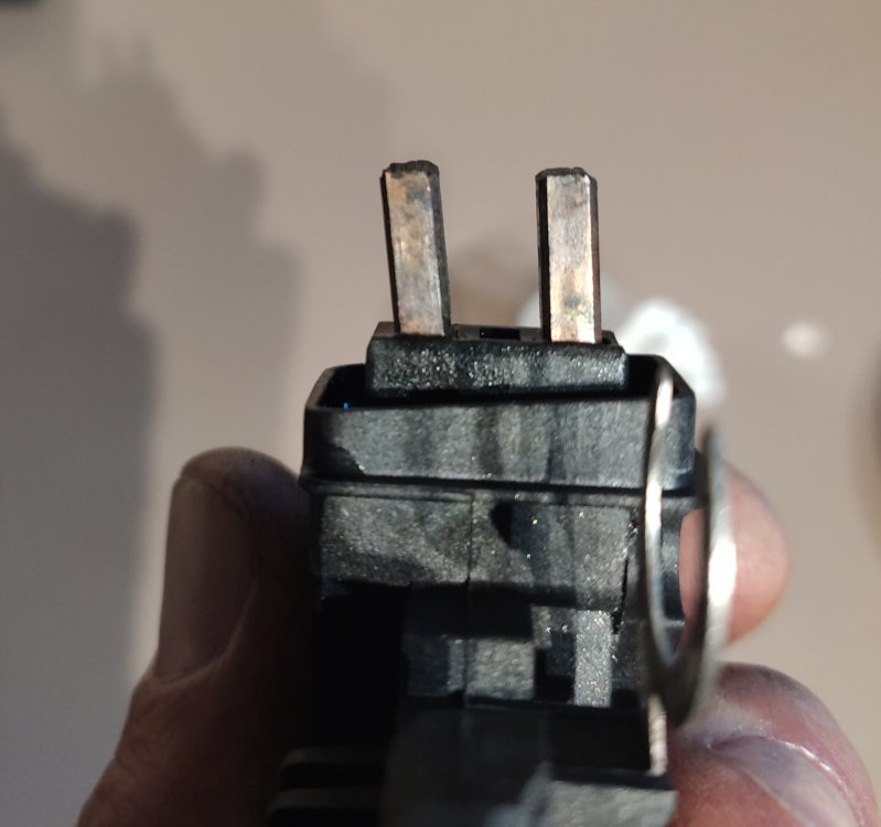

After some maintenance on the electronics on my old Fabia, I forgot to place back the connector of the blue clutch pedal switch (see image below which is borrowed from this forum). The function of this switch is for the car to notice when the clutch pedal is pressed in, and then the engine quickly reduces it's RPM to be more in line with the RPM of the gearbox. When the switch is faulty, the car thinks you are using your clutch every time you release the gas, which causes a shocking / shaking experience while driving. The car doesn't produce any warnings or fault codes, so those who have a similar problem could check this switch and its wiring.
