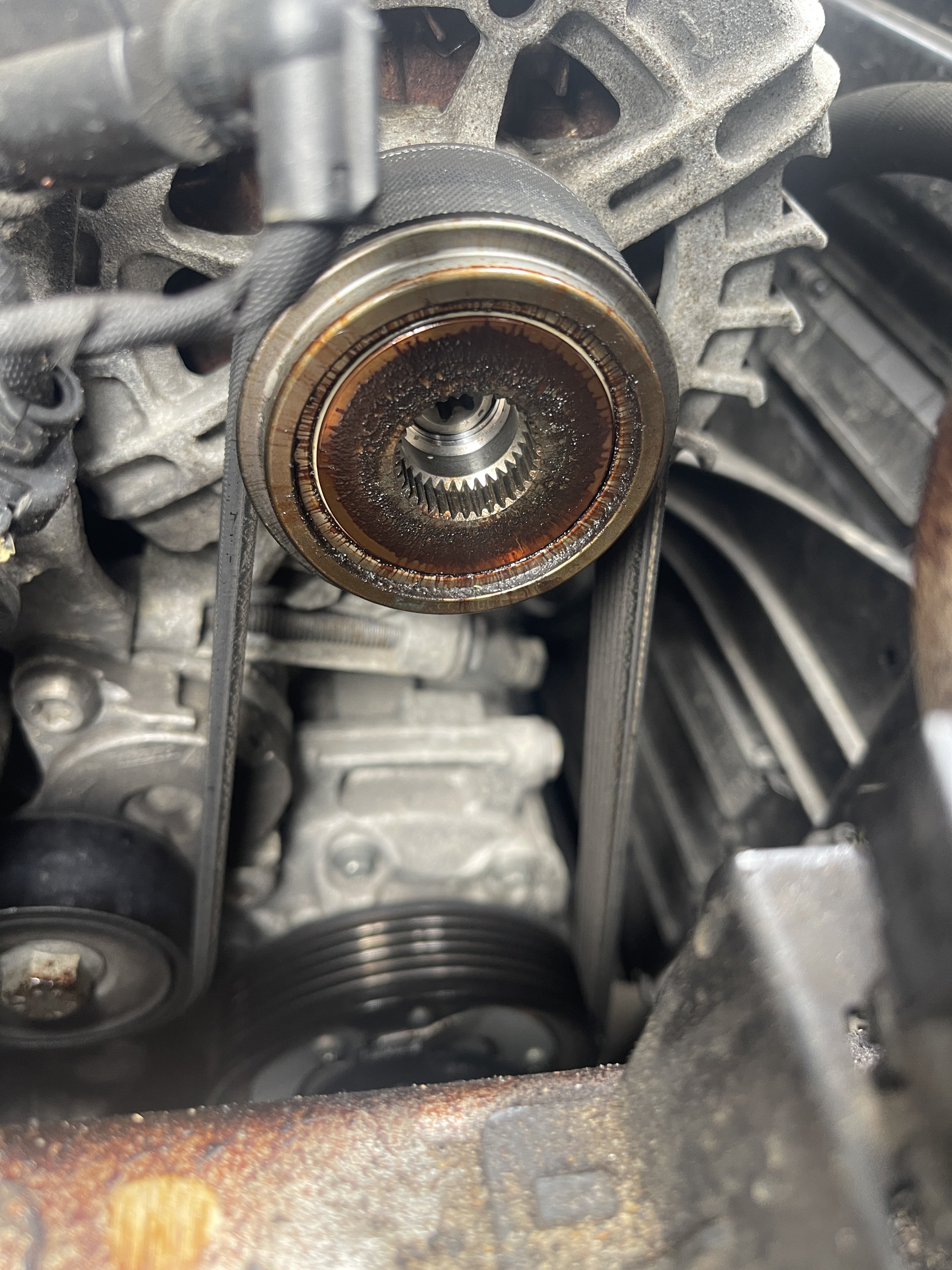

  6. Yeah. That was the same as mine. It’s blows of the black cap the only issue is the back of the pulley itself as some are recessed and some are flat. Mine was a flat one. To be fair it didn’t take too long to replace to be fair. I would recommend getting a pulley kit from Amazon I think my one was £25. Basically saving £400 not having to buy the whole alternator from Skoda.
  7. So to give you guys an update . Have changed the pulley and it's been fine since. Have ran it for about 2 weeks now with no issue in regards to that. The pulley I used was this one; https://www.autodoc.co.uk/ina/2386771 you will need the tools remove it though as well. Luckily we had them at work already.
  8. That’s what i think. My start stop is still functioning so the battery is still ok. Just want to replace this before I delve into the £517 for a new alternator. Just wondered if anyone has had to replace there’s previously and if so what did they use. If the clutch is seized does it need the whole new alternator?
  9. Thanks for your comments. It’s defo coming from the pulley. The pressure builds up which boots the plastic cover off. There’s oil/greasy substance literally splashed directly opposite this. Battery was replaced last year as it was old and turning the car on was getting sluggish. This is recent. No other leaks that can be seen

  11. Hi, can anyone point me in the right direction of where to get an alternator pulley? Mine has decided to boot off the cover and start leaking oil. Went to Skoda and they don't sell it on its own only with the alternator for £517. I have looked online and everyone I look at shows it's not a fit. Has anyone had to replace there's? Mines a 2ltr petrol 2017
