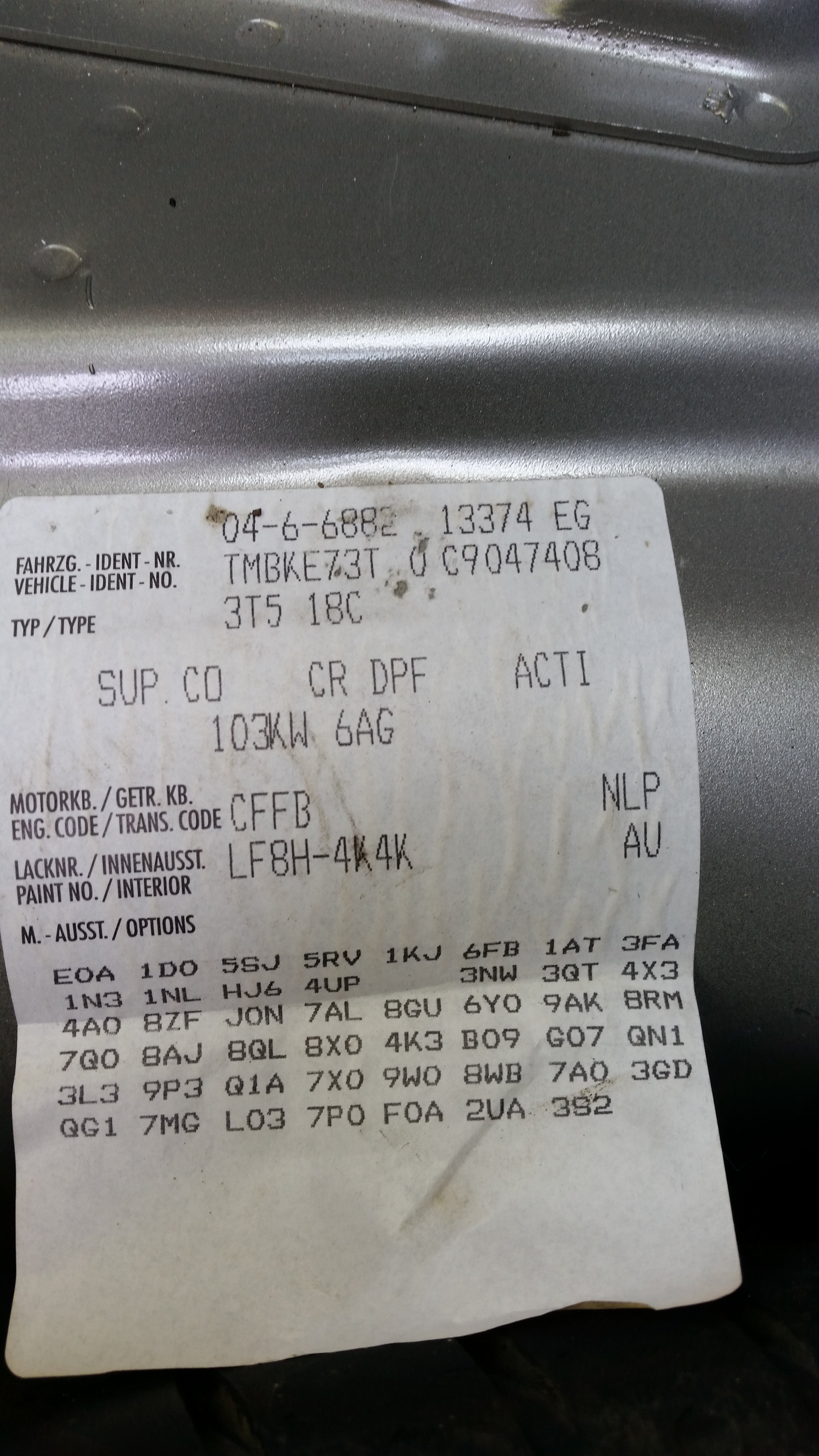

OK. Finally managed to register with erwin, to find out what springs were originally fitted. Entered the VIN and it said ' This vehicle has outstanding field measures! Please visit an authorised dealer'. I cannot progress further in erwin. Argggggg. Any ideas? I just want to be able to go to the VW dealer at 8.00 tomorrow and convince him that I need at least weight 6 ( or better 7 or 😎 rated springs fitting. Not the currently fitted weight 4. Thanks, Fats -

JR - We lived in Charente Maritime for 16 years before moving back to UK last year (family reasons), so am well conversant with the vagaries of French garages.. Picked up the van from storage near where we lived and are taking it back to the UK after this 'holiday'. Don't think I can tow it back 1500kms on two broken springs.. My springs are colour coded white, orange, orange which seems to indicate weight range 4. From what I have read most UK cars were fitted range 6, so would not be strong enough anyway? I tried to find the PR code for original fitted but can't make any sense of the codes on the sticker in the boot. Can anybody decifer it for me? Thanks. -
