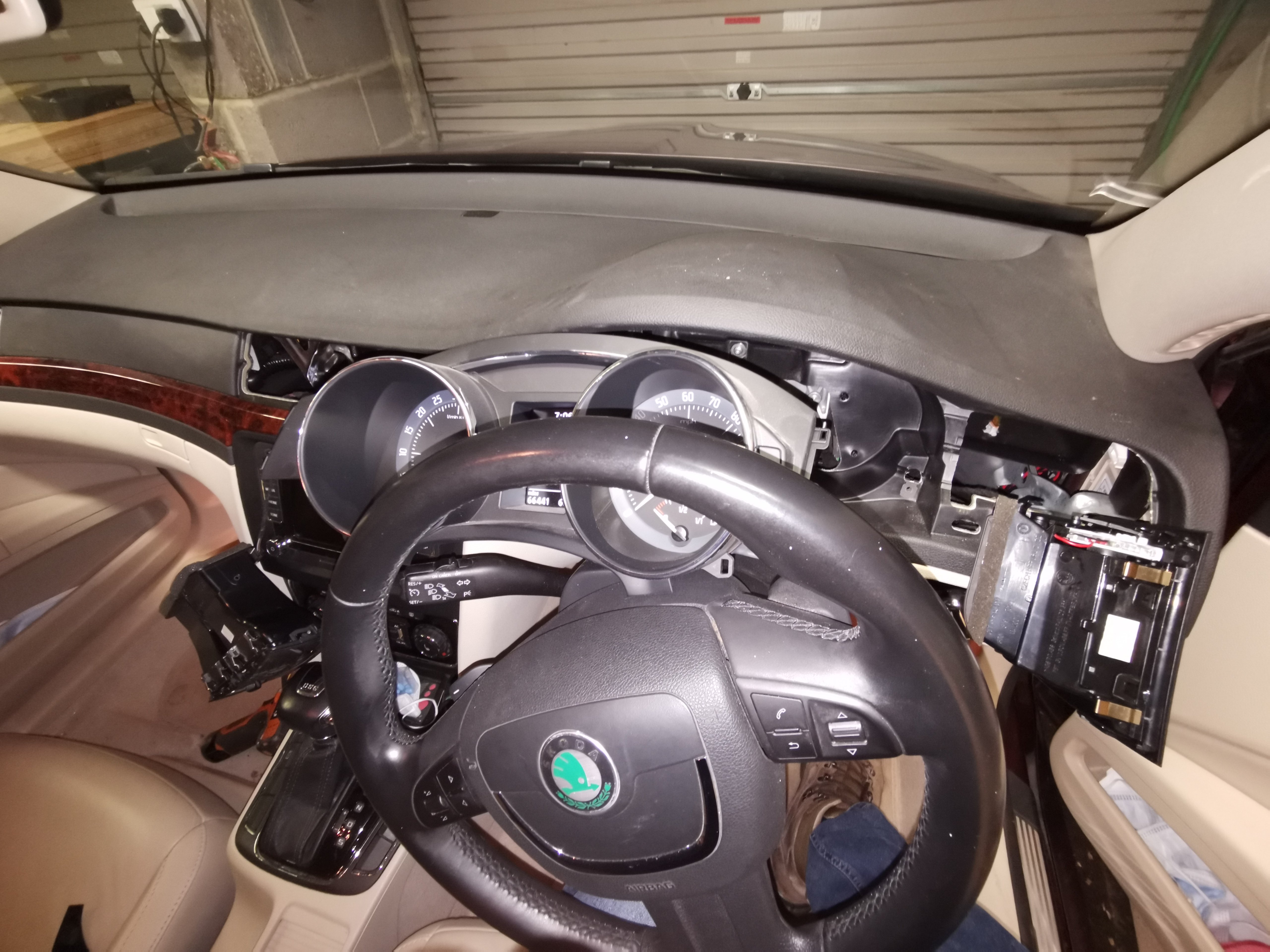

Well I had a go found a video on YouTube on how to remove dash panel. And bingo removed old buzzer put new one in and works. Over the moon lol. You can see the two holes behind the bit I removed. Hope this helps anyone. Was very easy to do I can send a link to video if anyone reds it- front parking buzzer
hello hope i can get some help here. been looking for a while on how to change the front parking buzzer for a skoda superb mk 2. parking sensors have stopped working so got a fault reader and found out 01625 - Front Parking Aid Warning Chime (H22) 009 - Open or Short to Ground so iv ordered the buzzer but cant find a guide to find it, some saying its under dashboard. have anyone got photos as a step by step guide before i brake things. please - Window Regulator replacement
