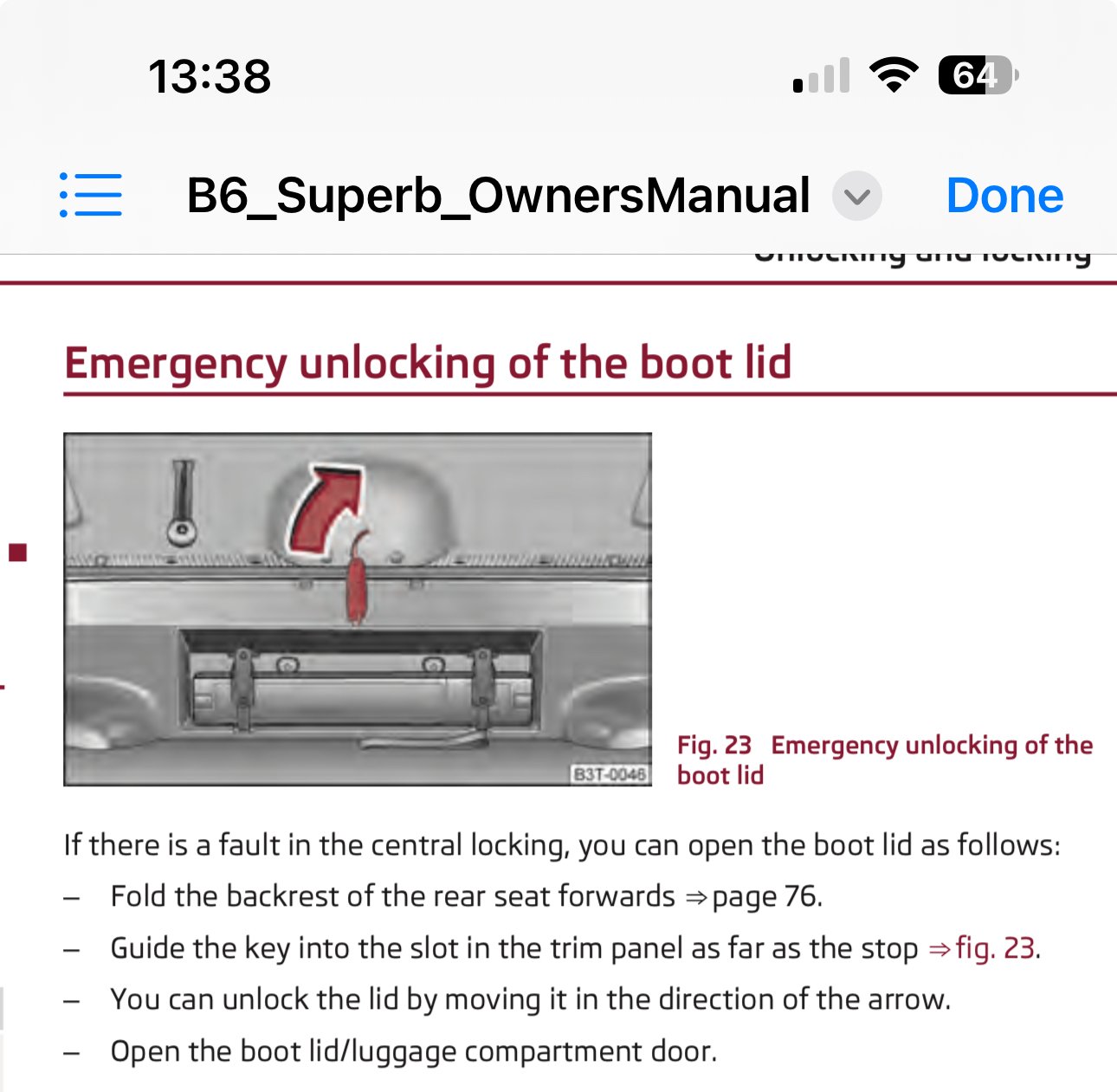

Just been out to the car… nowhere for my key to go there is no slot which is worrying 😞- Boot won’t open with fob or boot button.
there is a fault in the central locking, you can open the boot lid as follows: – Fold the backrest of the rear seat forwards ⇒ page 76. – Guide the key into the slot in the trim panel as far as the stop ⇒ fig. 23. – You can unlock the lid by moving it in the direction of the arrow. – Open the boot lid/luggage compartment door. Emergency unlocking of the boot lid will give it a go now! thanks for the helpful advice 👍👍- Boot won’t open with fob or boot button.

Hiya folks, Went to open my boot this morning and nothing,no sounds nowt! no im presuming it’s the twin door broken wires mission. i had no reverse/or rear fog lights pop up the other day which I was going to change today but then this… my question is how can I open the boot to attempt the repair as in the guide on the forum? is there an emergency pull/lever? I presume scanning the car won’t bring any faults for the wires too? Thanks in advance. ste- Skoda Superb Elegance umbrella
