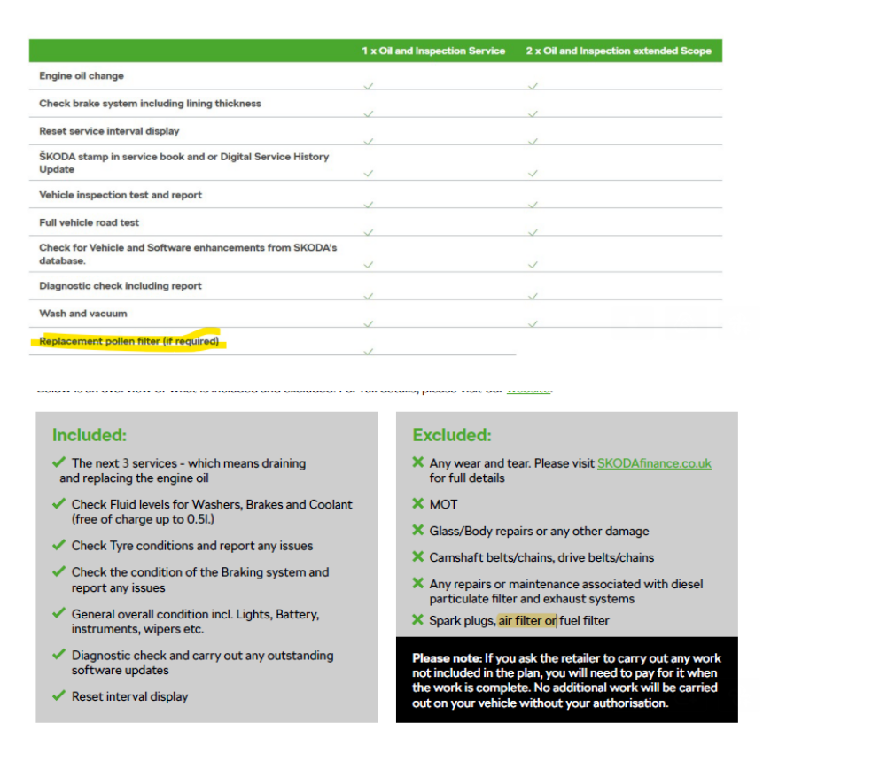

  1. you are right, i called one of the local dealers to clarify So i made purchase and there is already discrepancy between what is included which is the pollen/air filter
  2. i think its from Skoda UK so should apply to all dealers.. Only thing is i did not see things listed like spark plugs and oil filter which i though is part of the extended scope
  3. Looking at promotion, seems like a reasonable deal Online Service Plans (service-plans.io) Could someone share their recent cost experience of having below services on their Karoq Petrol? Oil and Inspection Service Oil and Inspection extended Scope
