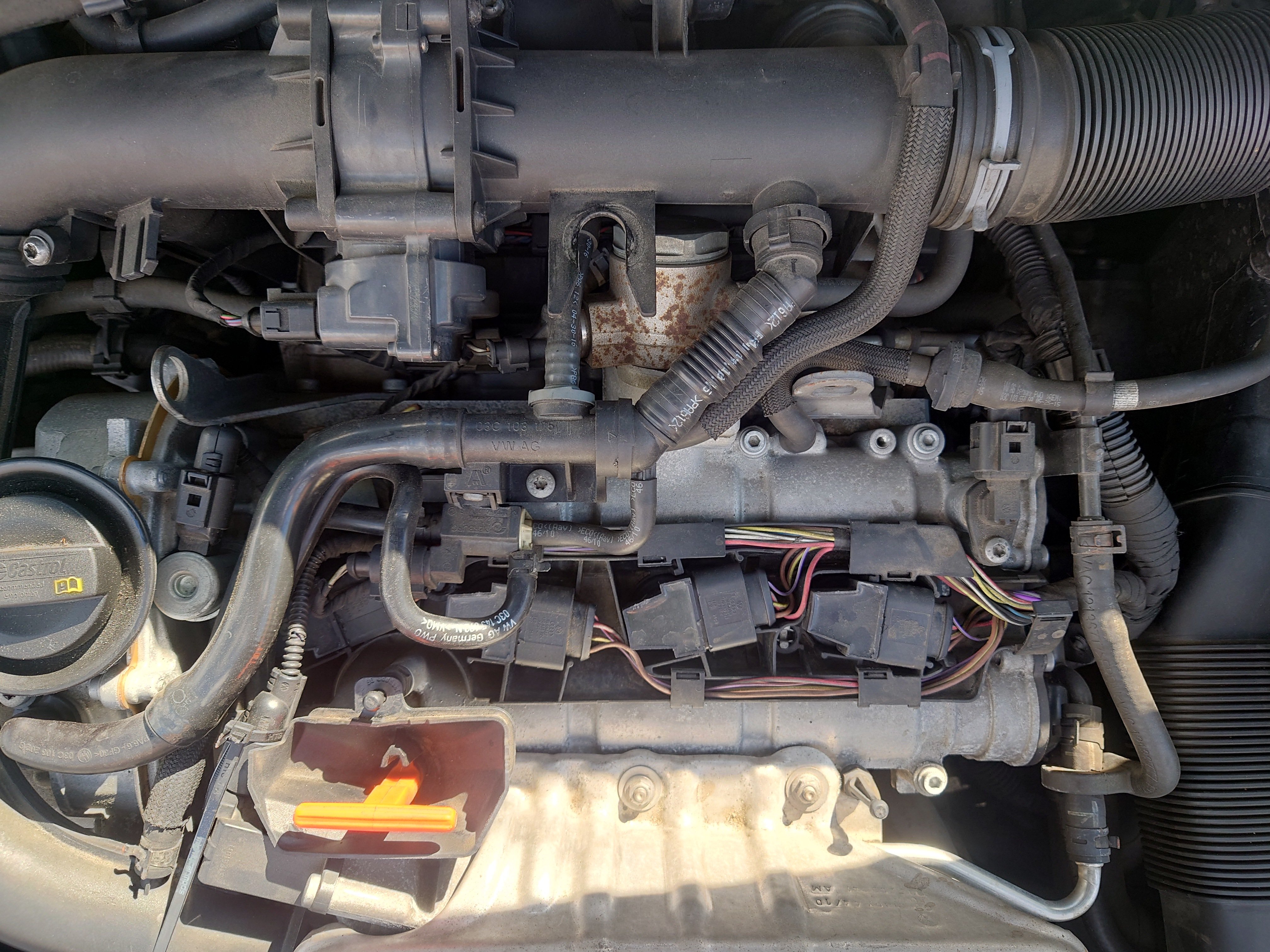

  5. Forgot to mention that there are NO codes stored ( which is confusing). And the injectors is my next stop, just wanted a 2nd option.
