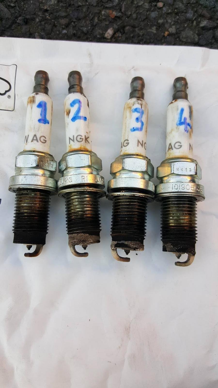

What did the plugs at came out look like, was one fouled or the tip burnt?

Take all 4 plugs out, inspect, check gap and oil / soot and be sure you never knocked one putting them in.

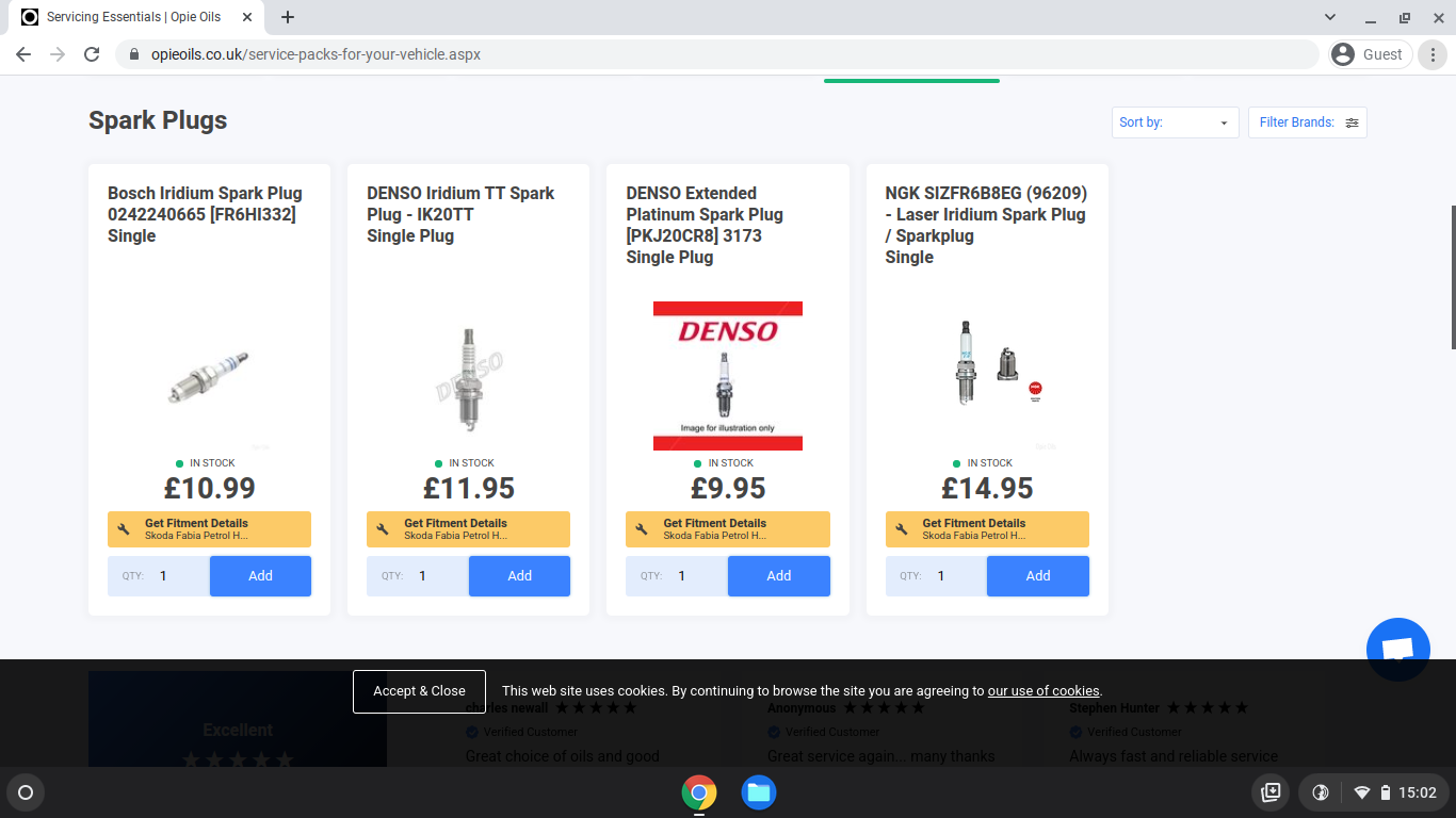

What have you been sold and put in that cost £25 each?   Where were they bought from?

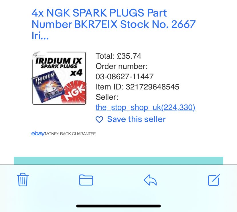

No problem John just to let you know mate I have four unfitted uprated spark plugs gapped at 0.6mm that I was gonna fit at my next service if you need to try anything different you can just give me what I paid for them from OPIE oils (it was a damn site cheaper than what you paid from those stealers)
Also those spark plugs from euros are not right you want these that’s probably why your car isn’t working correctly 67C22839-ABF0-499B-A402-5E5510F05CF8.jpeg.aabda252b10b5a30cf26f73d65a32c82.jpeg

@thomasaspin @sepulchrave - Now I can tell that "NGK Part No - SIZFR6B8EG" is a different plug grade to what @johnmlilley actually needs. John, fit the right plugs for the engine first; that will definitely help even if it's not a complete cure.
The cars left the factory with OEM plugs, these were changed for CAVE cars having spark plugs changed from 2010-2012 & CTHE in 2012.
That was changed to NGK SIZFRB8FG / 03C905601B  0.7 mm gap
(OEM had been NGK 03C9050601A  0.8 mm gap)
     There were still crap for a 1.4 TSI / TFSI 132-136kW
