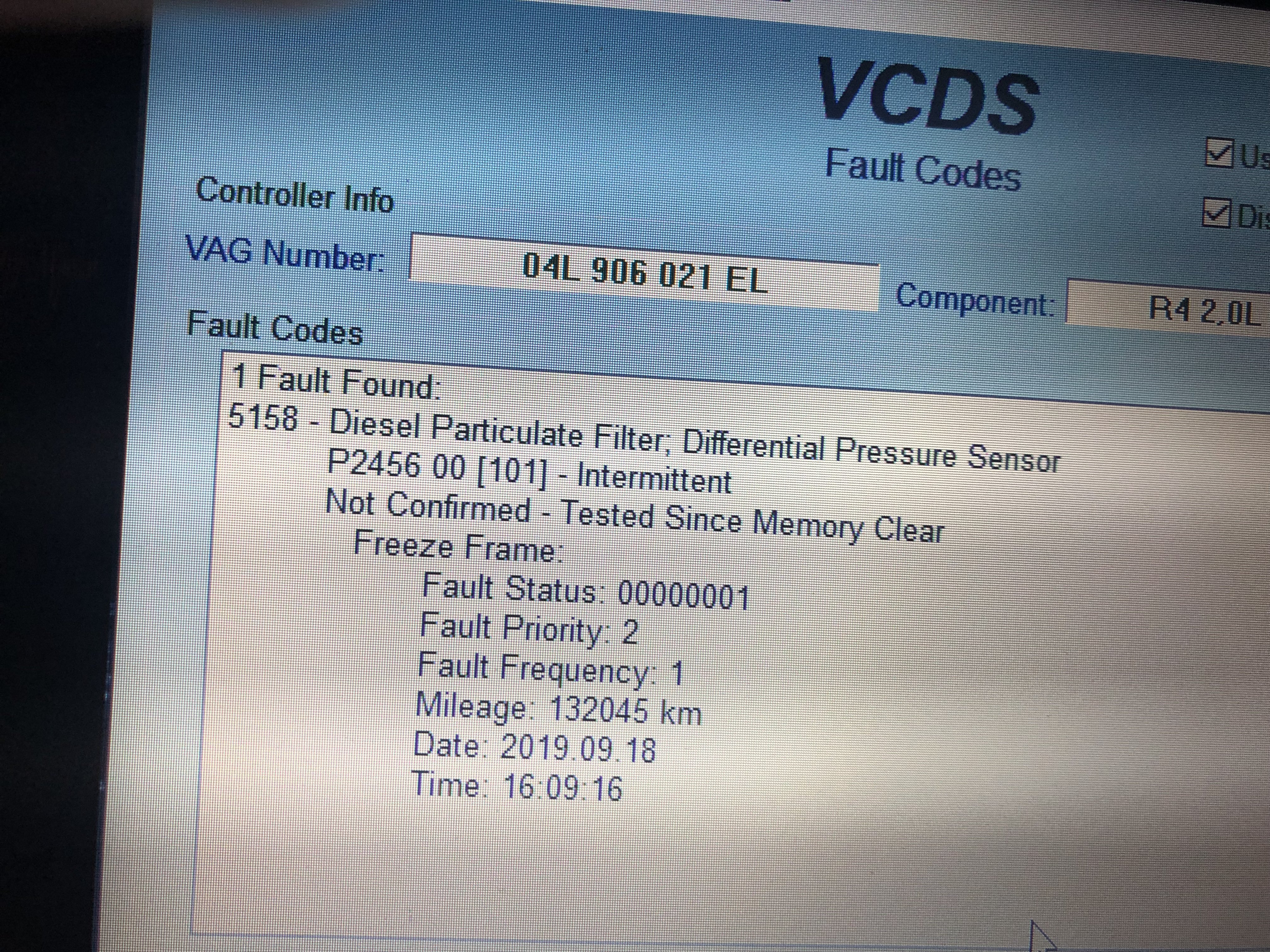

DPF Differential Pressure Sensor P2456
Roby10 replied to Roby10's topic in Skoda Octavia Mk III (2013 - 2020)
Hi Matty, The power loss is due to the senzor error. Should be ok after replacement. I recomend to recalibrate it before starting the car. -
I’ve finished the repair work and did the recalibration using the above method for UDS. After a couple of minutes the car started a regeneration and everything went good. Let’s if anything happens soon -
Anyone knows how to do a proper calibration+force regeneration ? I did some research on the web but i am not sure what’s the best way.
