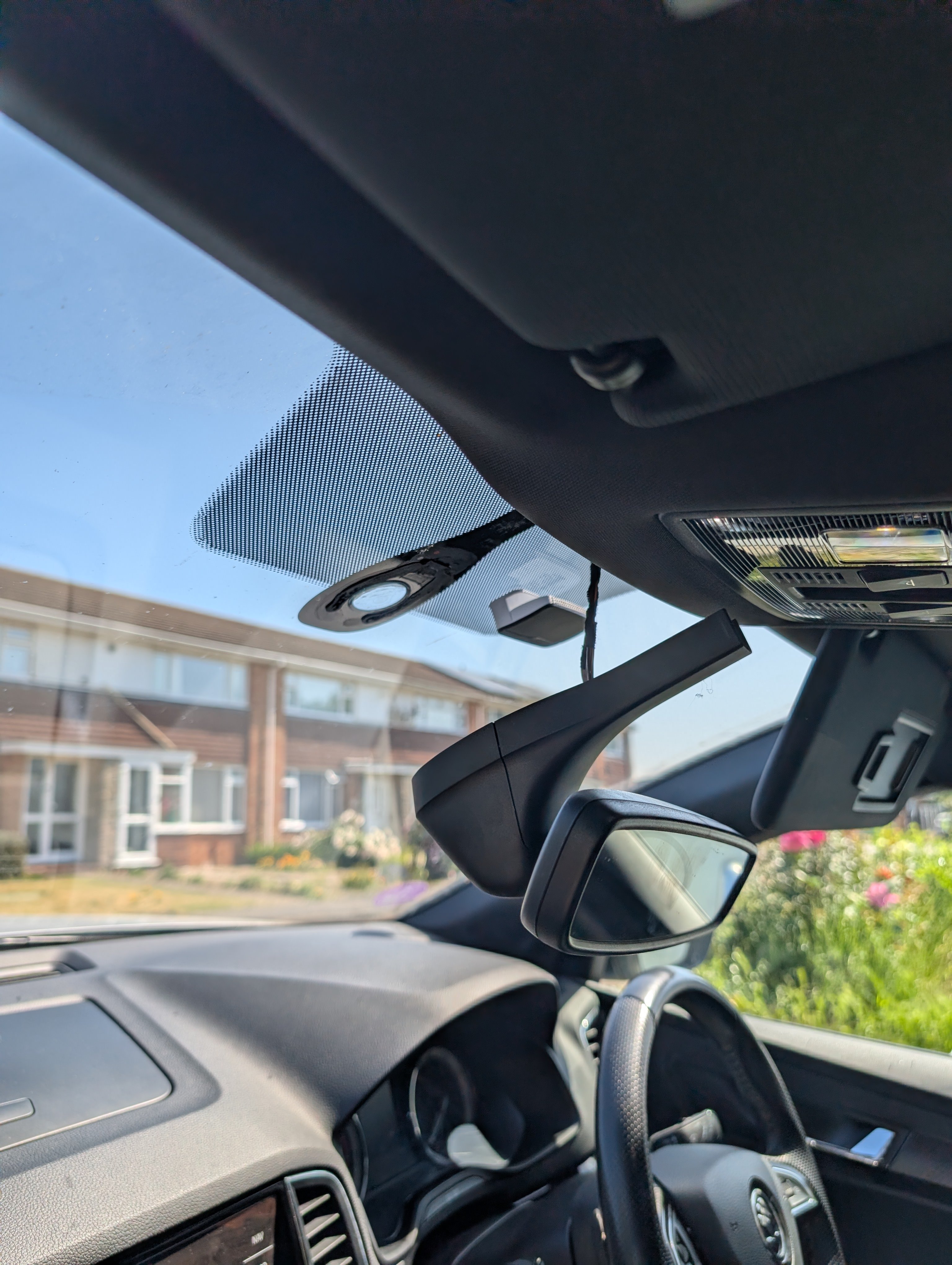

The car has been at Skoda today and as expected they have stated the warranty will not cover it. Oddly they won't even price up a new screen. They have just said contact a windscreen company who should be able to reattach it. National windscreens have said they wouldn't reattach it, just supply and fit a new screen. I argued that it shouldn't have failed, but Skoda have taken the stance that they don't know the history of the car before they sold it to us, which I find odd given it was an approved used car from a Skoda main dealership. I have raised a case with Skoda UK. Waiting to hear from them. To say I'm frustrated is an understatement. Don't expect this from a 6 year old car, the bonding should last the lifetime of the screen.

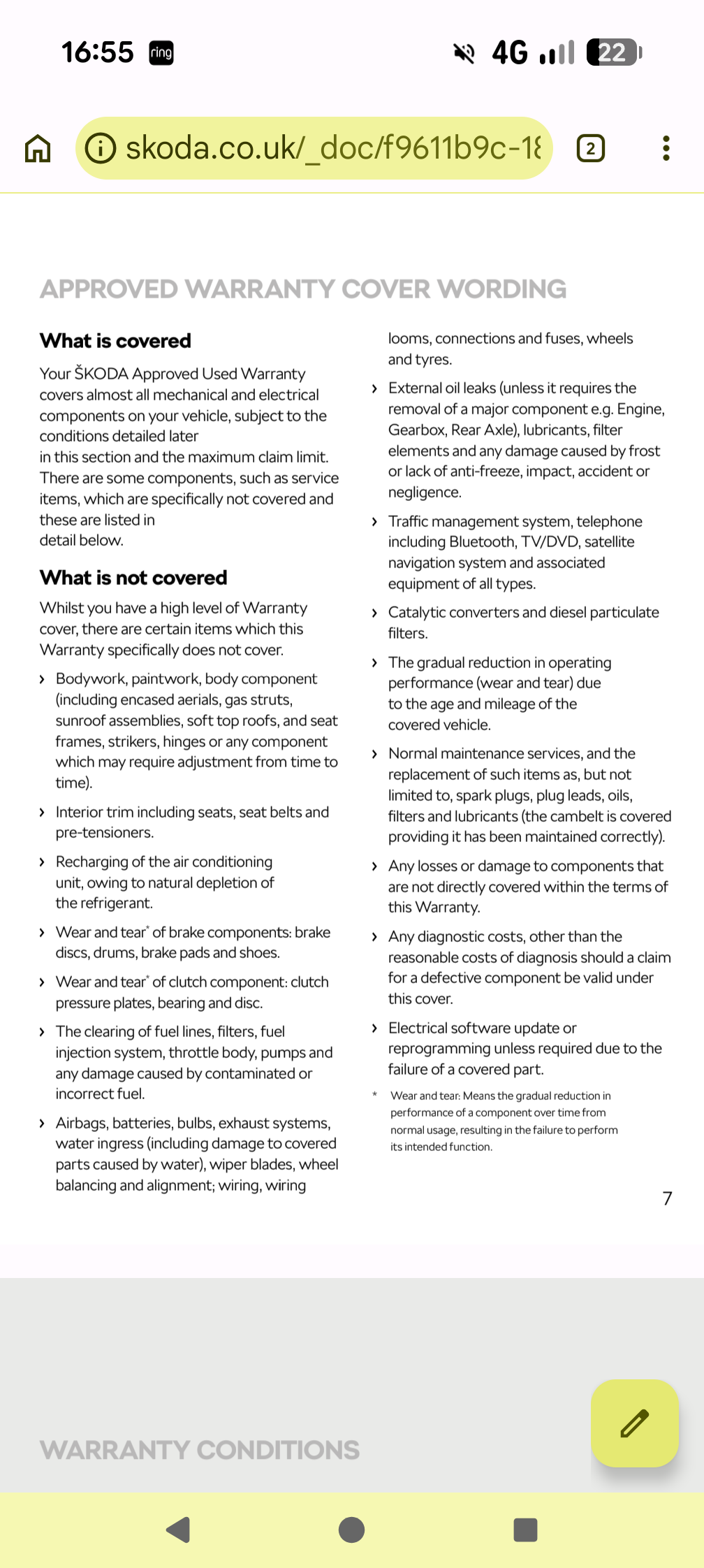

This is what is and isn't included so unless they are classing it as interior trim I don't think it's mentioned specifically. I have looked at these adhesives. Just wondering if it would work. I guess for a few quid it's worth a shot but I don't really want to damage it anymore and then have Skoda tell me it isn't covered. Maybe I'll wait until they have looked at it as you never know, they may cover it.

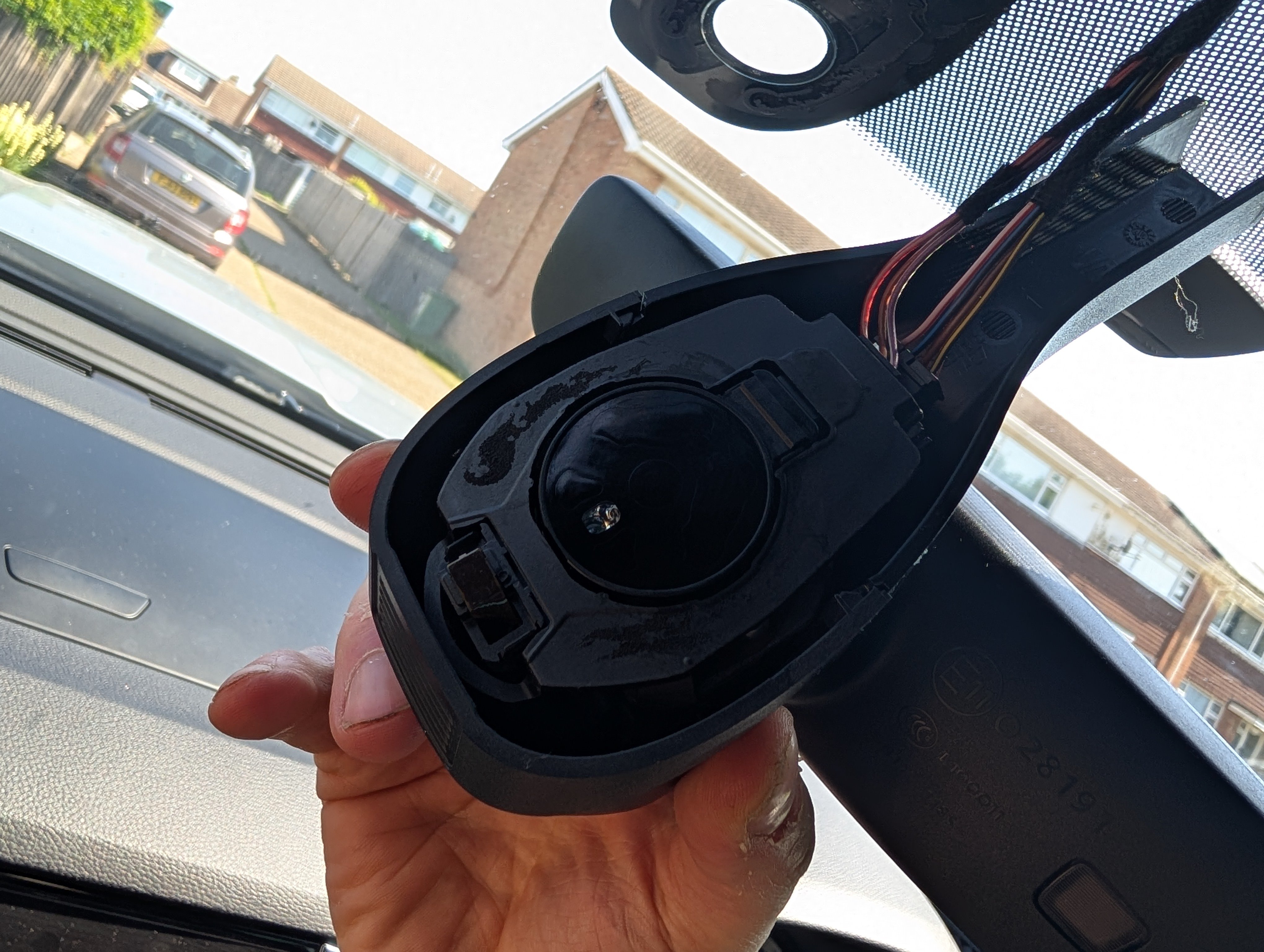

I've spoken with national windscreens today and they have said as the bracket has fallen away it would require a replacement screen as the bracket is bonded to the glass at manufacturer. Booked in with JCB Skoda Maidstone for the 9th of June which is the earliest date they had. We have only had the car 11 months and when we bought it we were given a 3 year warranty which we increased to 4, but straight away they service guy stated it probably won't be covered by warranty as they don't normally fail so could be some external influence.

Hi all. Our mirror has fallen off the screen today. Can I just buy something to stick it back on or is it a bit more involved. The car is a 20 plate sport line
