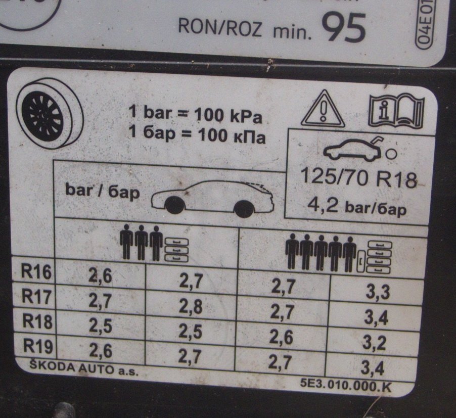

The comparison with your diesel Mk3 is only valid if the tyres are exactly the same. Your extra weight of the E-Tec bits makes only a marginal difference compared to a 2020 non-ETec 1.5 SEL. here's the flap info;

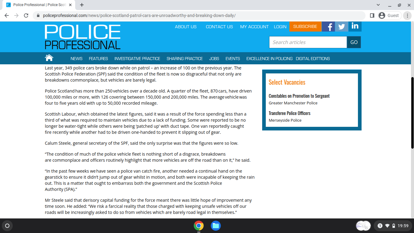

Edited by Ootohere
Thanks to everyone who has responded thus far. I have reduced the tyres to 2.2 Bar all round - A brief drive around the City and then A483 has yielded a much mor compliant ride, it seems more stable over the lumps and bumps around here and still returning 57 ish to the gallon around town.
Kind regards
Alan
That's almost 9 psi down at the rear and over 7 psi down at the front. Compliant it may be but you now need to monitor tyre wear on the shoulders - particularly on the inside which is harder to check.
