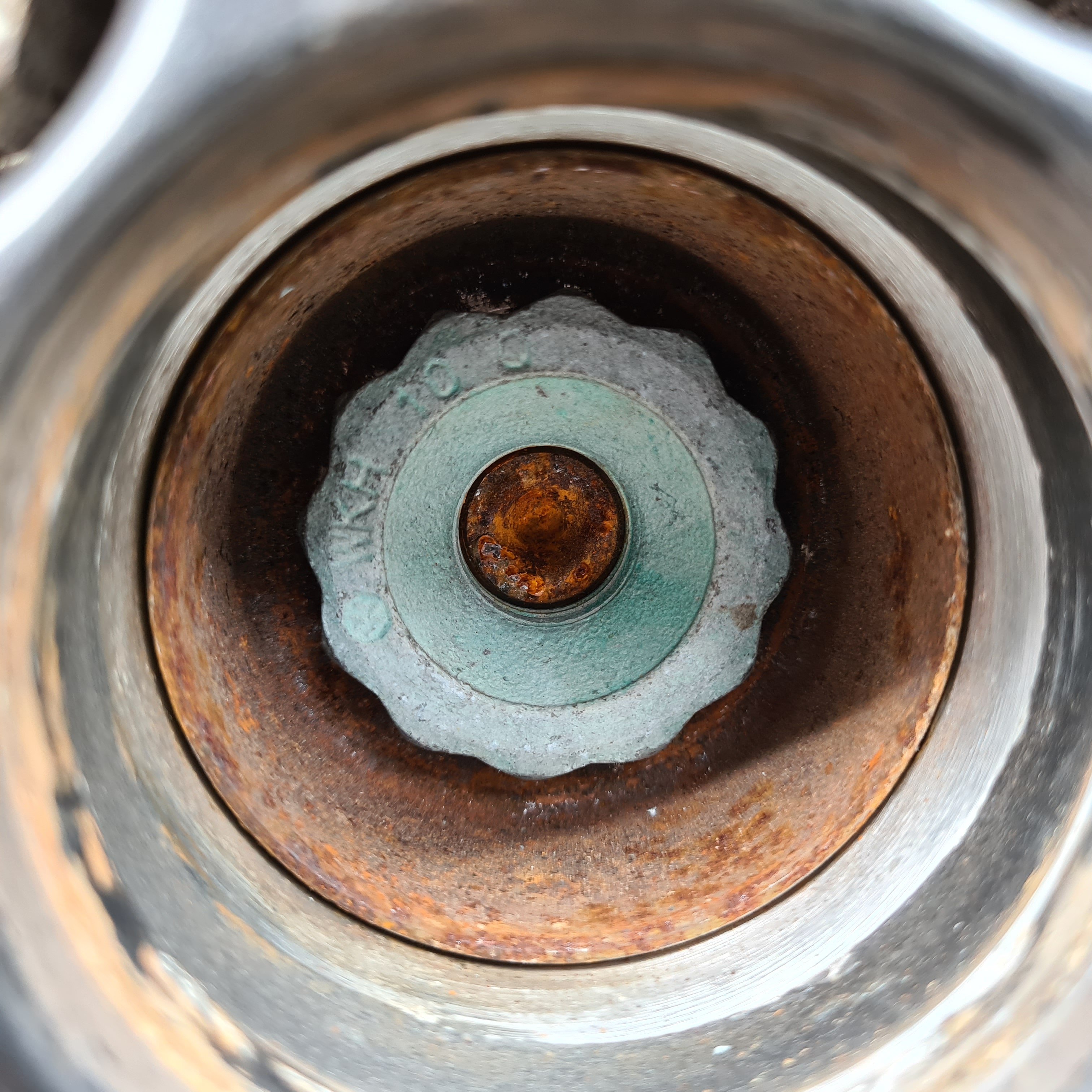

They're just small chamfers to aid in the socket over the nut. As far as I can see looks same as mine

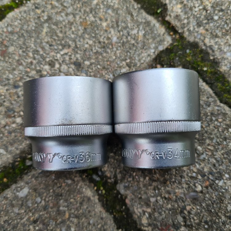

The 34mm is just over 45mm dia

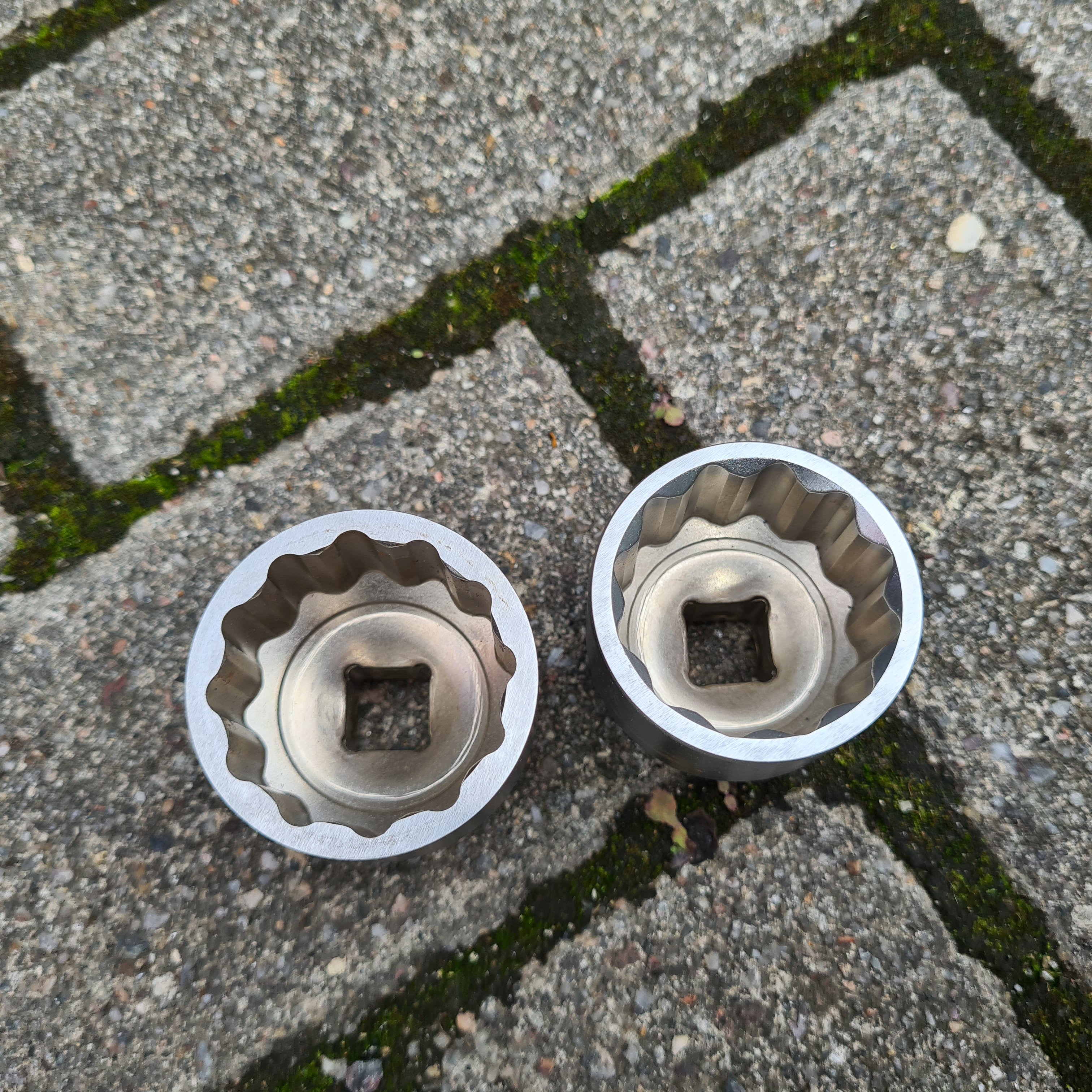

Just been on the phone to Skoda and their technician uses a 36mm 12 point special socket. The top of the pitches are lower on the nut so dealers have a socket to stop the socket jumping

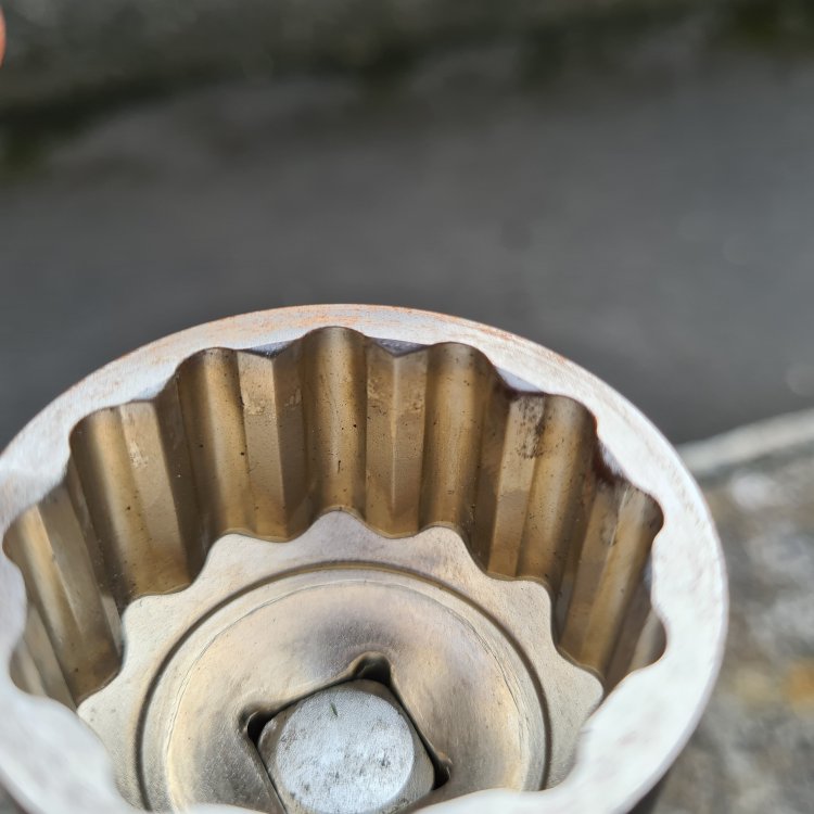

You can see the contact points where the nut is just running over the points, I ground the socket down on it's length at work because of the huge inside chamfer on these sockets.

The OD has enough clearance as far as I can see it goes on the nut fine, when I turn the socket you can fell the socket is way to big and jumps all the points on the nut. The OD on the socket is just a touch under 48mm dia

Hi all, Went to take the hub nut off with a 12 point socket 36mm and it doesn't even look to turn the nut plus a 34mm if far to small for the nut. Is it a 35mm? See pics Thanks
