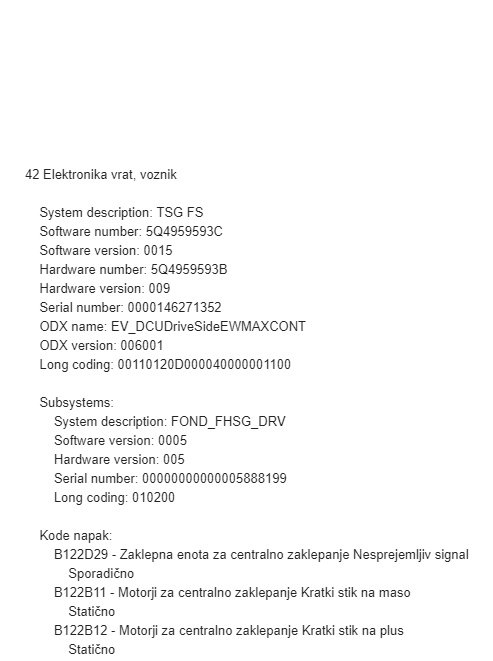

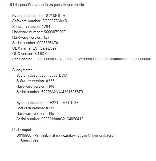

  7. Hi everyone, recently I have problem with my central door locking on my Octavia 3 (year 2015). When I try to lock it with fob key it does two "clicks" instead only one. All the doors lock, only the drivers wont lock. If I try to lock it with key in doors lock then it does the job. I have tried to lock it with second key and still the same problem. I've already visually checked wires between door and chassis and taken apart the door frame, but on the eye everything looks ok. I have Obdeleven, so I tried to scan it. It scanned those fault codes ; U019900 , B122D29 , B122B11 ,B122B12 . If someone had the same problem, please help. I attached scanned faulty codes tho its written in SI. Thanks
