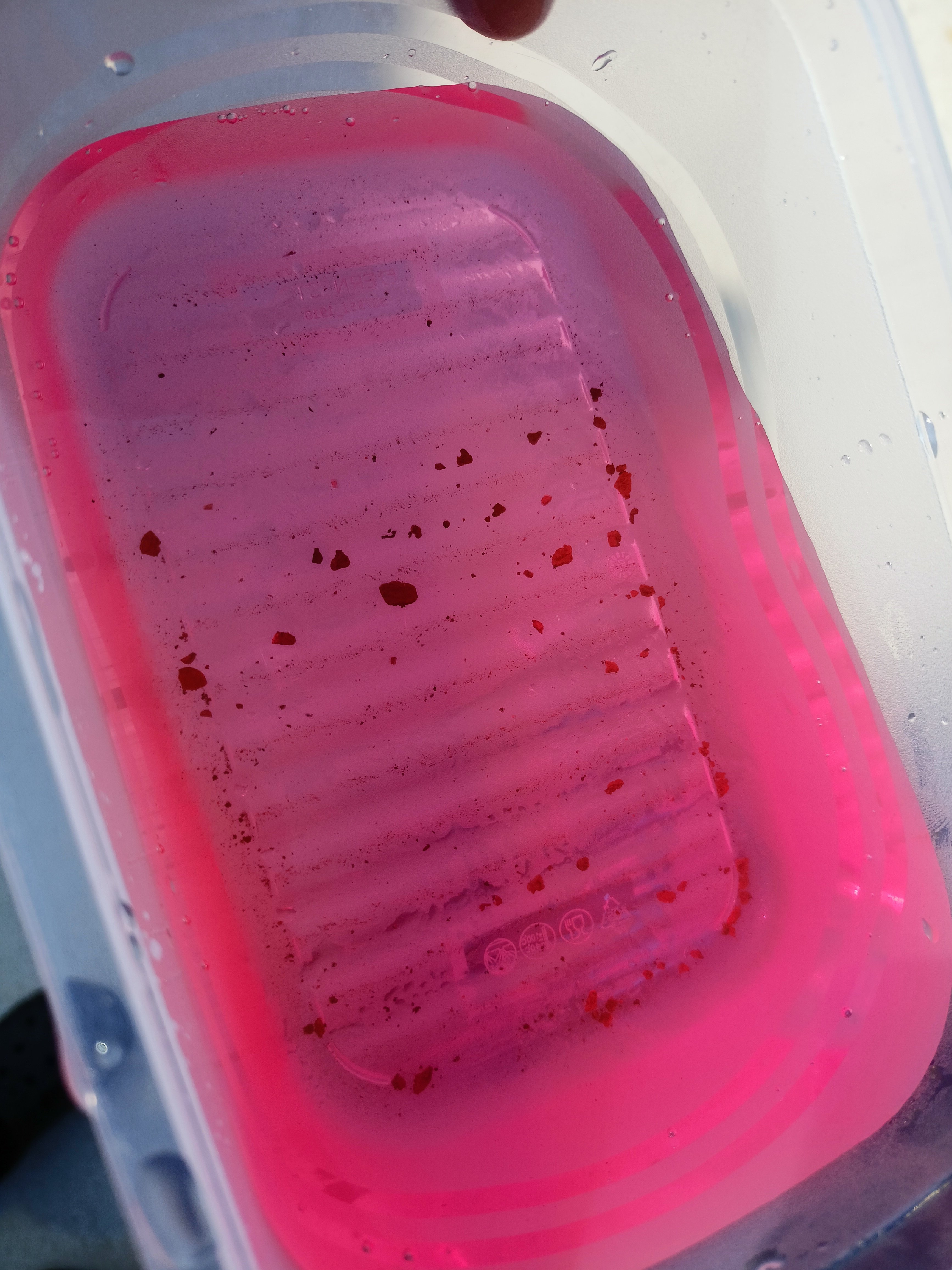

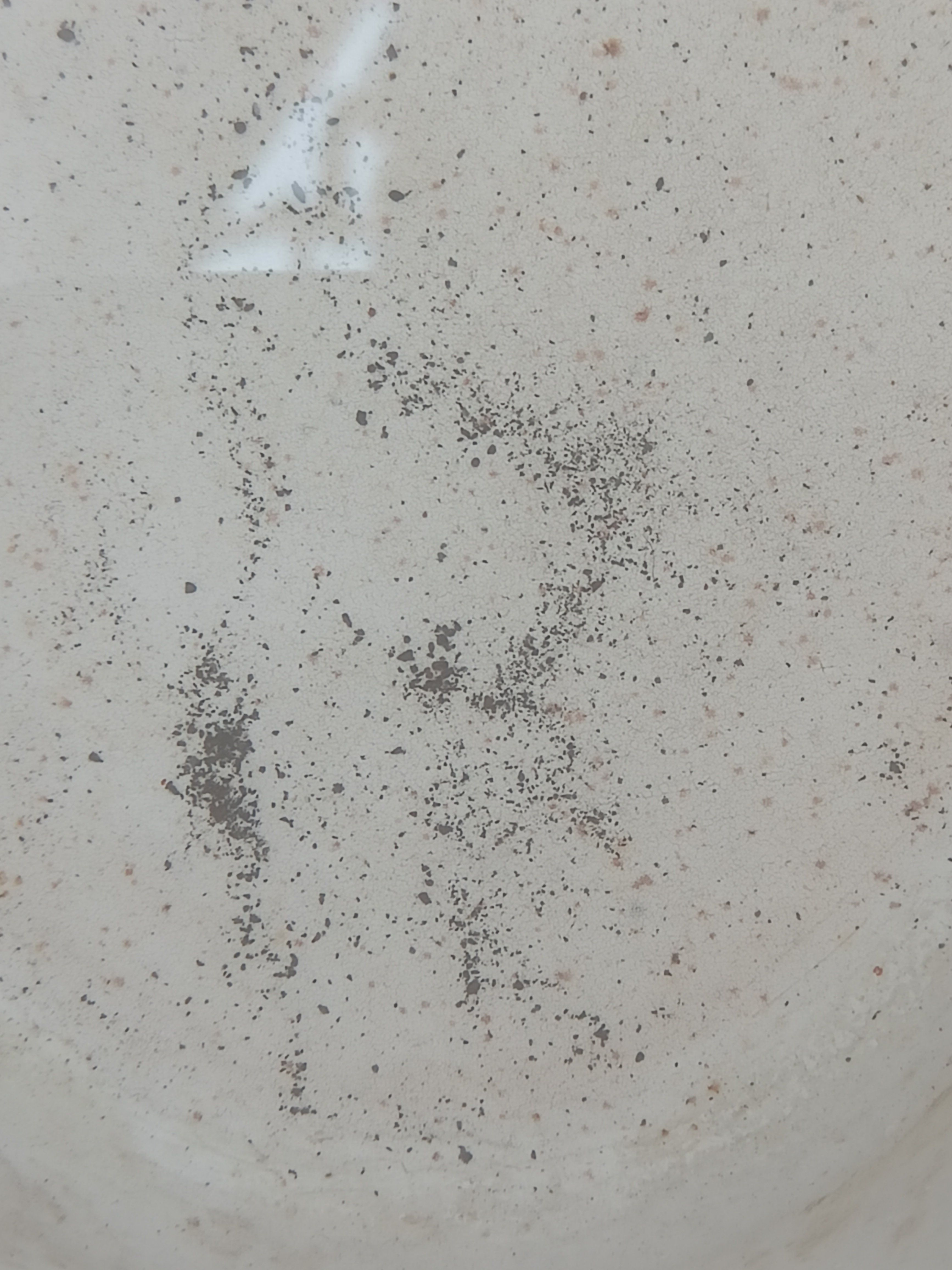

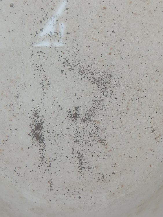

Just finished flushing the heat exchanger in cabin. It had some debris inside looking like chunks of rust and some other really fine particles. I flushed with tap water from both sides to make sure all debris went out. I even tried to blow inside and i think the air flow is good enough. For better result I would need to flush all system.
Then I put all back together topped up the coolant and started engine with heat on until it reached the temp then topped up to between min and max. Tho I'm pretty sure it will burst the coolant out off expansion after next dpf regeneration 😵.
Here are some pics of debris i found inside.

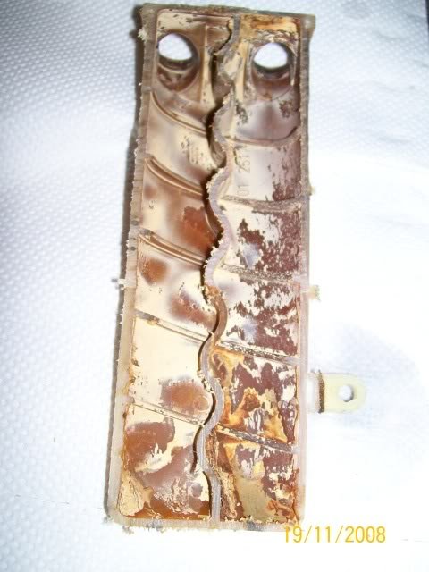

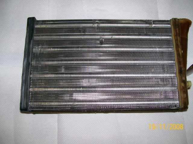

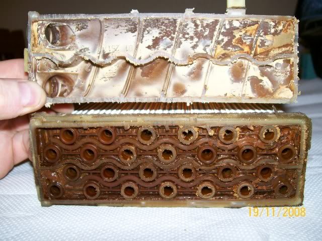

You'll never get all debris out, because within heater matrices the incoming and outgoing large-bore connections split up into many smaller bore pipes which are all in parallel. If any of these are partially or fully blocked with debris, your flushing fluid will preferentially go through others instead.
Here are some pics of a Vauxhall one I cut up many years ago:
