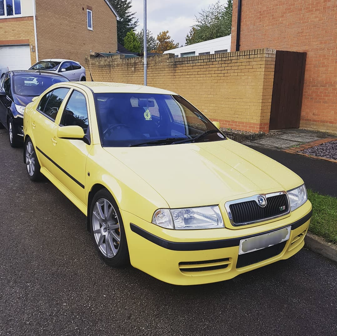

  10. Hi all, I'm thinking of repainting my Octavia VRS as the paintwork is tired and fancy a colour change. Has anyone else done this? And if so, can you post pics of your repainted cars so I can get an idea of what they look like in different colour schemes. TIA Danny
