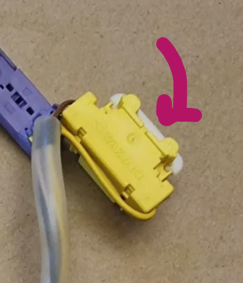

  3. This isn't my photo but I am trying to find out what it is called as I broke this white cover on the yellow clip when taking off my steering wheel (as I have a broken clock spring), can anyone tell me the name and/or where to buy a replacement please?

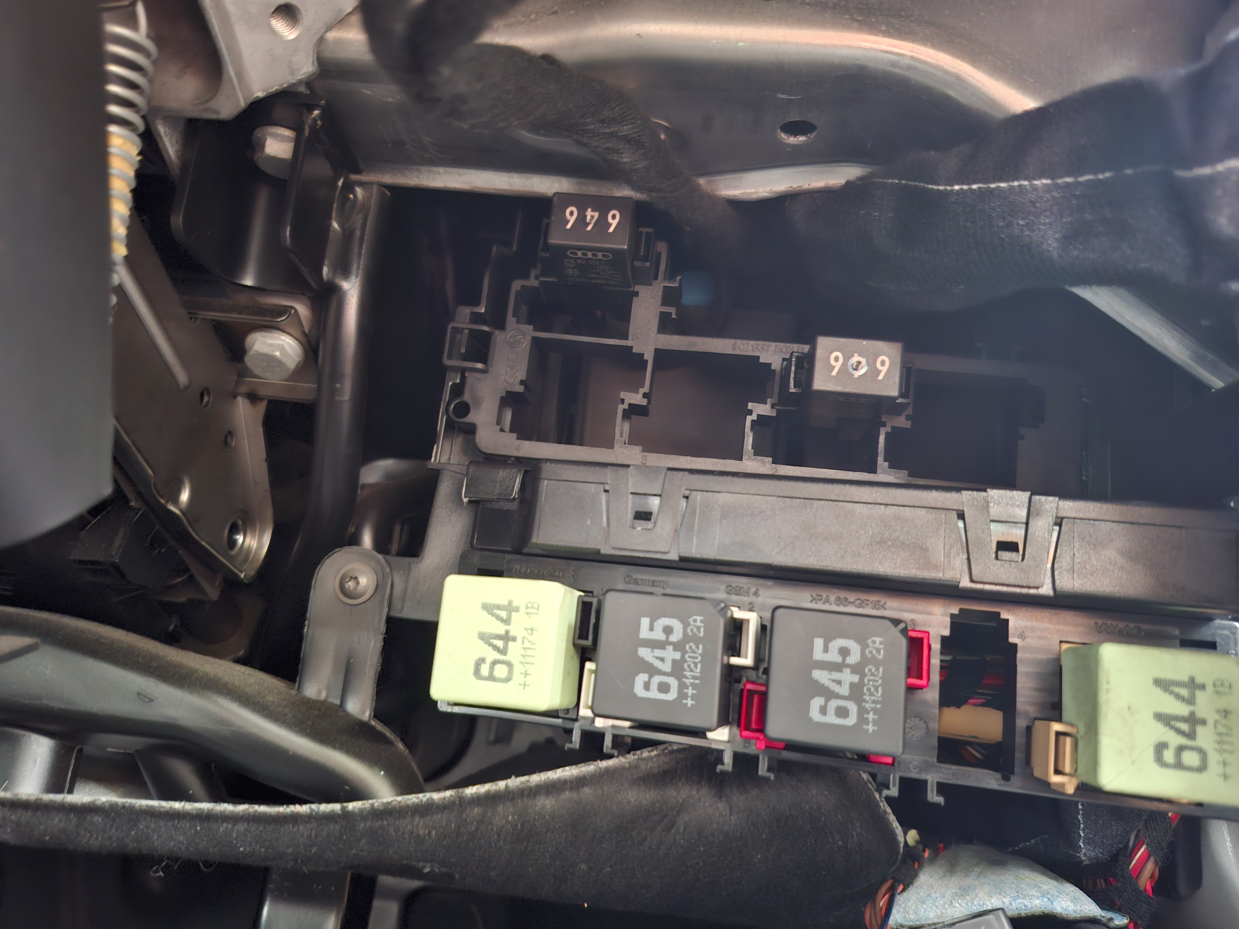

  9. Thank you, mine looks like the second, but like your previous photo mine is missing number 4 and the 646 above it is the horn...why is it so hard to locate!
  10. I have a 2011 1.8 TSI Scout, and my layout under thed dash is the same as your photo, but I (and my garage) cannot find the fuel pump relay - did you find it or know where it is on our models please?
  11. Have an error code (garage confirmed, I don't have the specific code #) and symptoms of the fuel pump relay being intermittently faulty - but the garage could not find the fuel pump relay, it is not under the dash under the steering wheel (the 646 where we all expected it to be does the horn not the fuel pump) nor does it seem to be under the bonnet, please can someone with this make and model confirm where they have found it on theirs?
