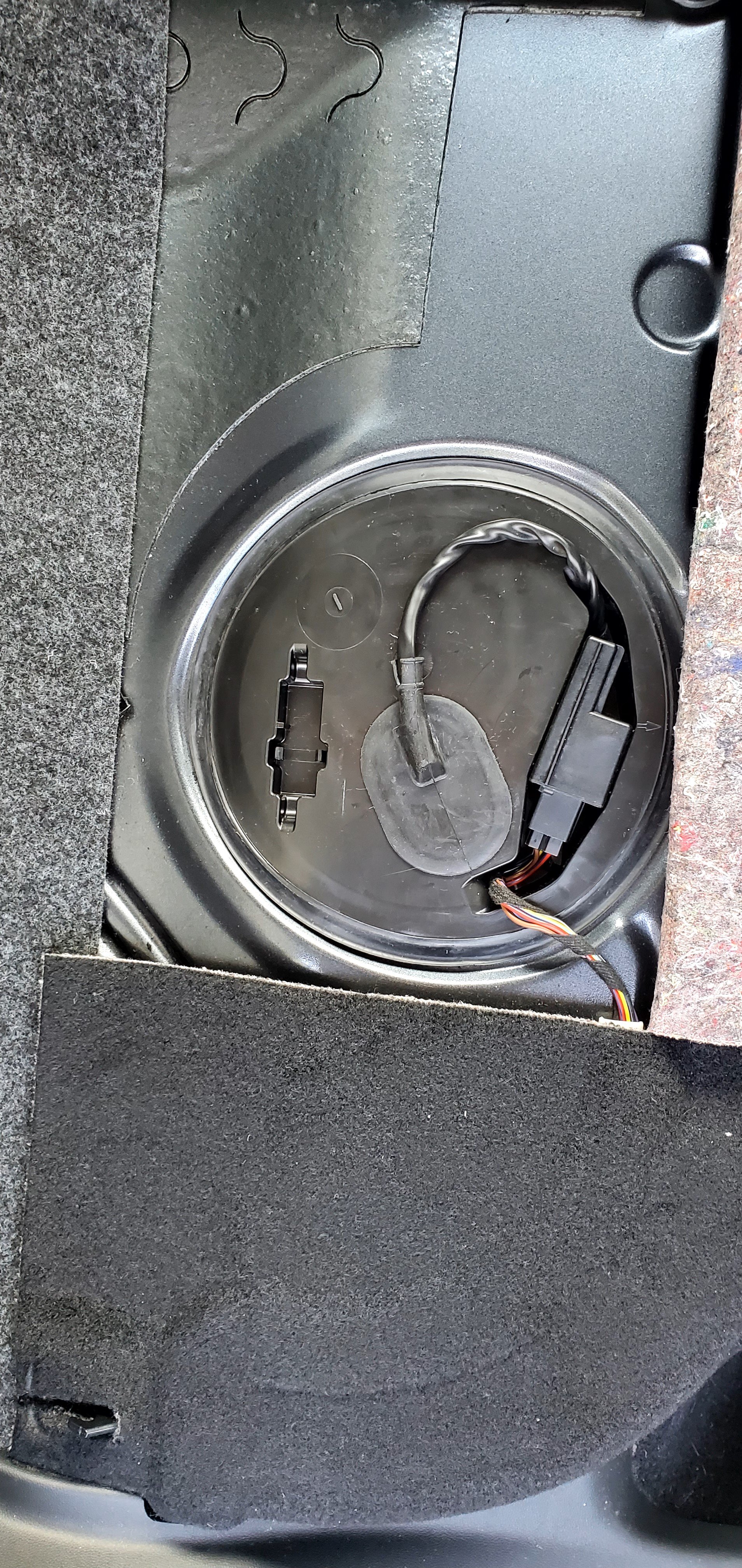

On my 2009 TSI the FPC is under the rear seat, set into a recess in a black plastic plate, covering the fuel pump access hole.

Simply lift forward the back seat behind the drivers seat and lift the flap.
The FPC lifts out of that slot.
If you pop off the round cover there is access to the other connection. Lift the red tab and it slides off.
No tools required.

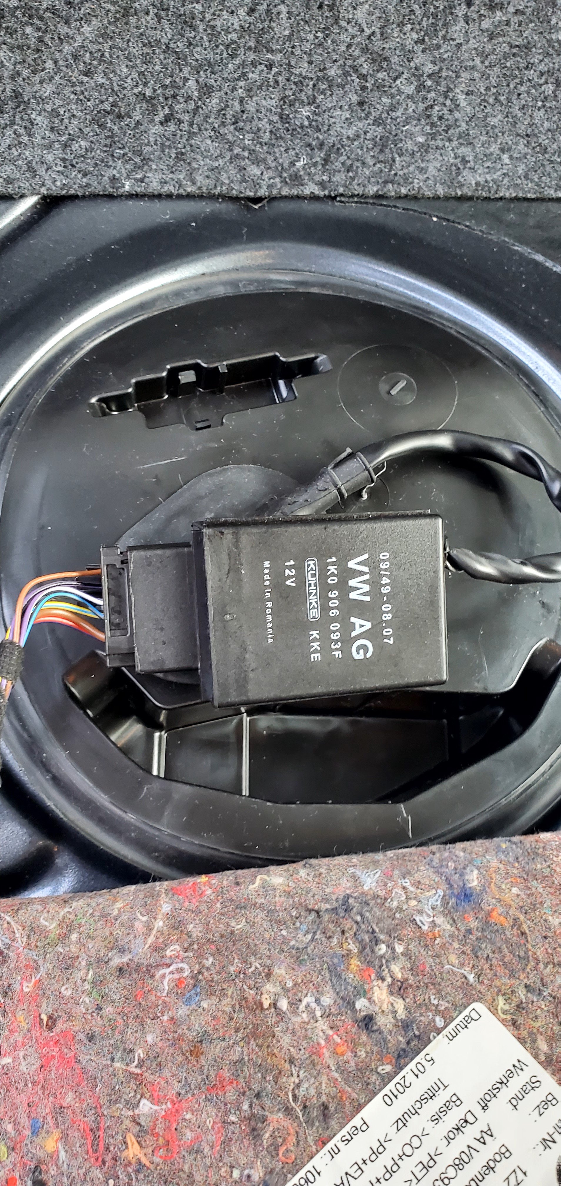

@tetleyI ordered that and got my seats up etc., and it seems to be exactly the same but mine ends with a F, and now my car won't start with either plugged in, I don't suppose you know if the last letter actually crucial to the code or are they interchangeable and now I've triggered something else (since it won't start with either now)?

As far as I am aware the letter is a revision number and could simply indicate which factory made the FPC. I have replaced parts on my car with later revision letters in the past without issue. In fact I look for the latest revisions when sourcing parts.
