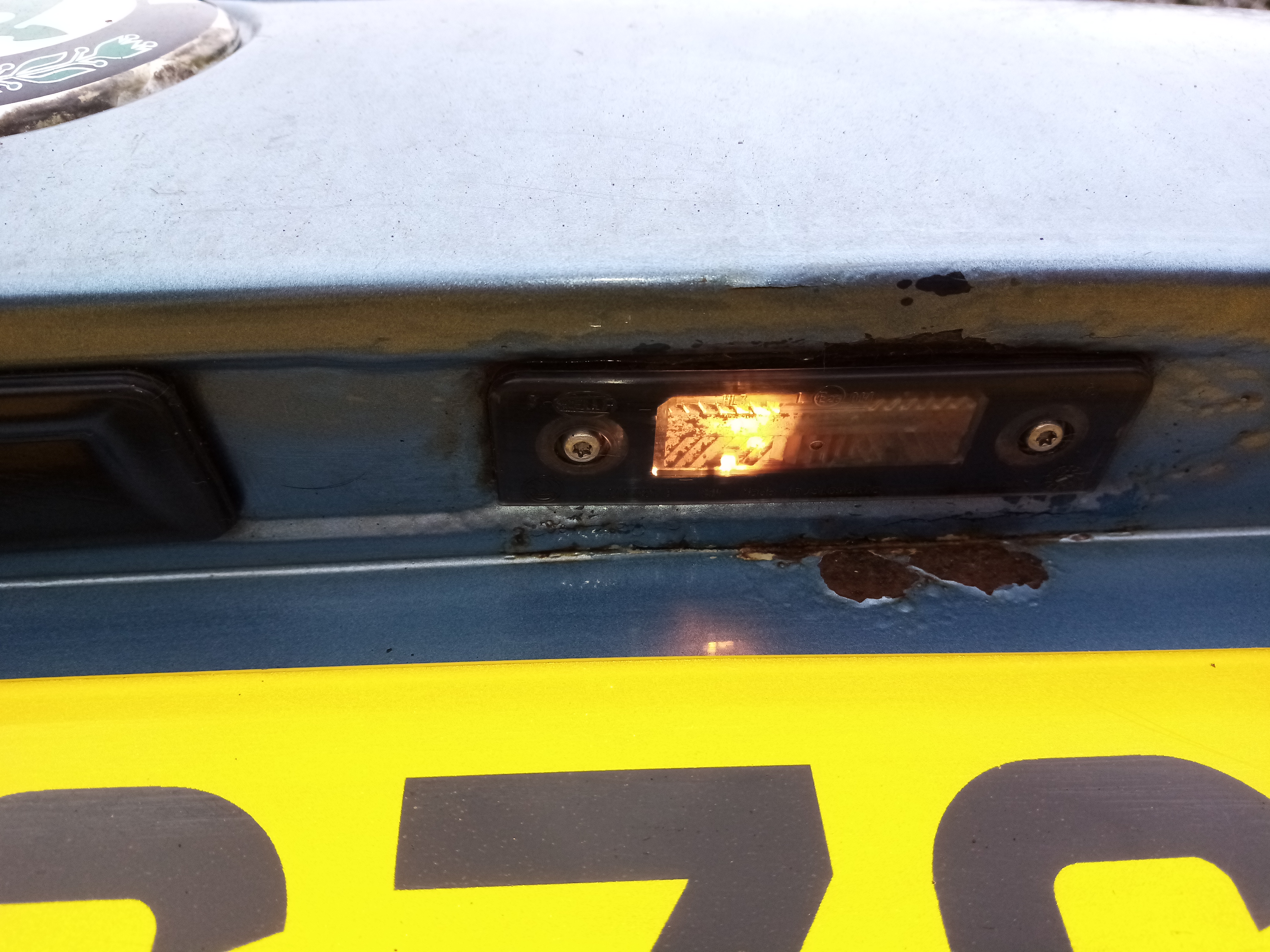

That's good to know not to worry about going down the repair route, I'll touch it up and paint over as needed and replace when necessary. Thanks.

Hi Thanks for reading. I've just got a second hand Octavia Scout, with two spots of rust on the tailgate (which bubbles under the paintwork). Can anyone in the know advise whether this is fixable (and if so what type of garage might do this) or whether a replacement tailgate is an easier solution? I'm not looking for a perfect repair as the affected area is barely visible unless opening and closing the tailgate, even something to stop the rust spreading further would be ideal. Thanks Jamie
