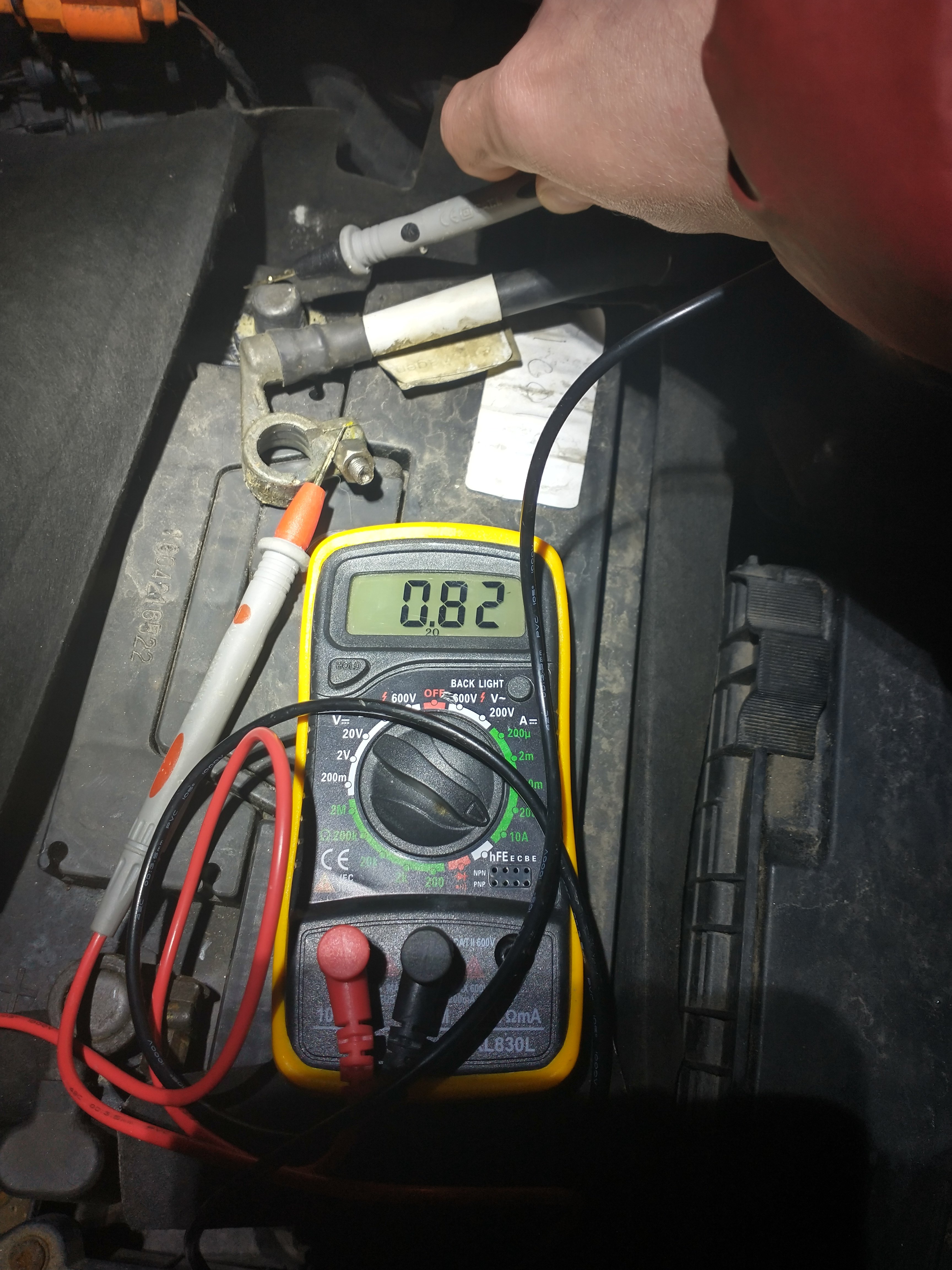

Thanks all. Will recheck the total current raw this weekend using the method suggested by Wino and JR, and if higher than normal will check circuits per Nige 👍 -

That's brilliant - much easier than what I was doing (pulling fuses and checking the current drop). Thanks. -

Car boot checked (without use of child labour!) and all looks ok. Will continue my search for the culprits 🤣 Hadn't realised some modules will take a while to power off so will maybe leave a couple of hours then re-check next time. Thanks! -

Will check out the boot light - thanks! -
Hi! Thanks for any help answering this question. In my 2011 Scout I have had a problem over the past few months with battery drain. The battery was replaced in November last year (when I got the car) with a new one and ran fine until this winter where I have found a need to jump start the car 4 or 5 times already. Once jump started and running the car seems to start without problem as long as it is used every day (so imagine alternator / starter are fine) but if not used for a few days I find the battery flat. Following advice from online I plugged a multimeter between the negative terminal and cable today and (assuming I'm reading it right) got a reading of 0.8-0.9 amps at rest (key out the engine etc). The biggest contributor to draw seems to be the stereo - removing this fuse causes the draw to drop to 0.5 amps. Removing additional fuses (headlight, central locking and a fuse for some reason in a 'reserve' slot) gets the draw to nearly nothing. I've a couple of queries if anyone is able to answer. I've uploaded a pic of my multimeter reading - for those more experienced than me - am I right in thinking this is reading amps? (I wonder as I've read normal draw is in the region of tens of miliamps so this seems very high and suggests at least four circuits are contributing to draw). Thanks in advance.
