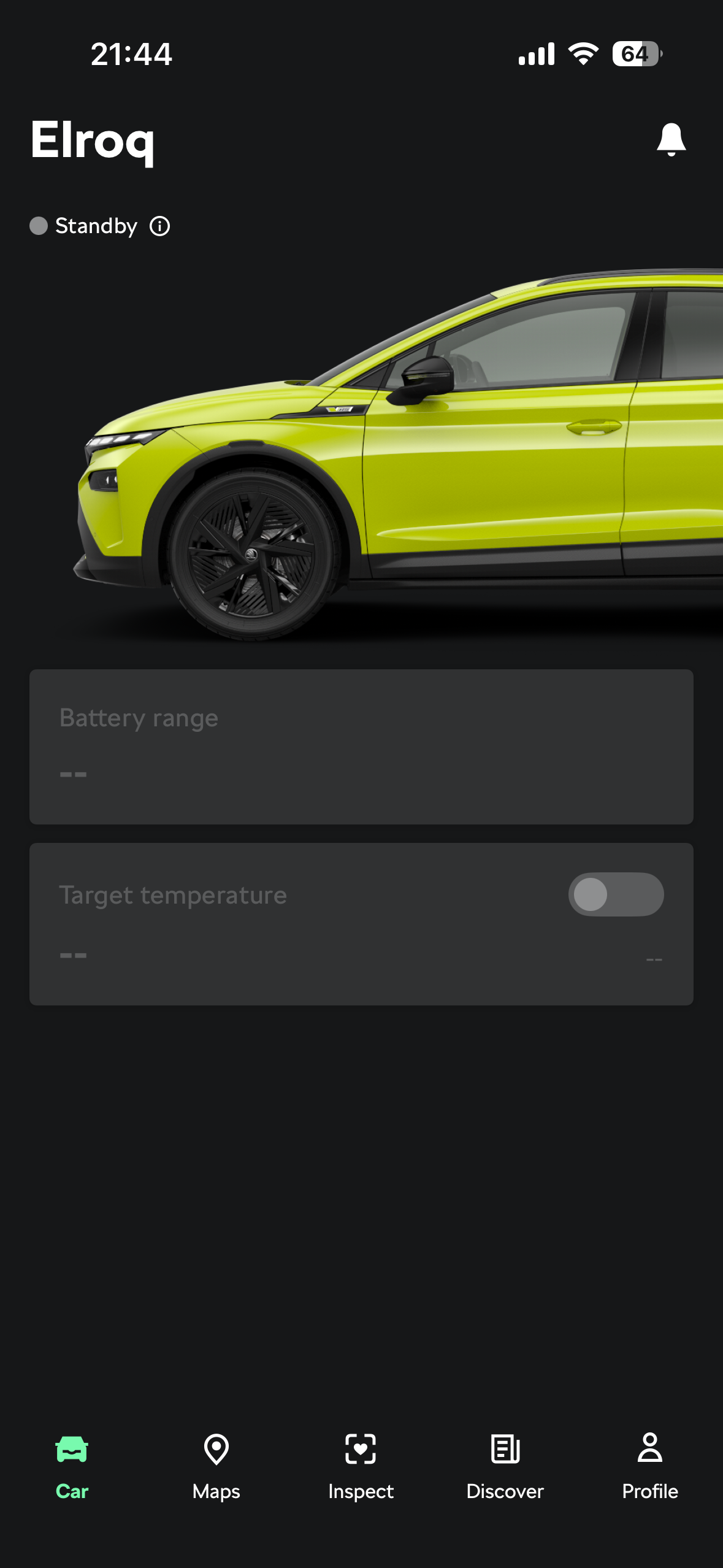

  3. Quick update: Things got worse after the battery disconnect and factory reset at the dealer. Online services are now completely dead with error ERR_SYS_A0100. I tried the 'Fuse 19' trick (pulled it, waited about 3minutes, and put it back). Connectivity came back for about 5 minutes, but then failed again. Now the Remote Parking option (in MySkoda app) is gone, and the odometer is no longer updating. There are disabled Battery range and Target temp sections I can't even perform another factory reset because the system fails to restore: Unfortunately, it is not possible to restore the factory settings on your infotainment system. (likely failing to fetch the online config). So back to the dealer tomorrow...

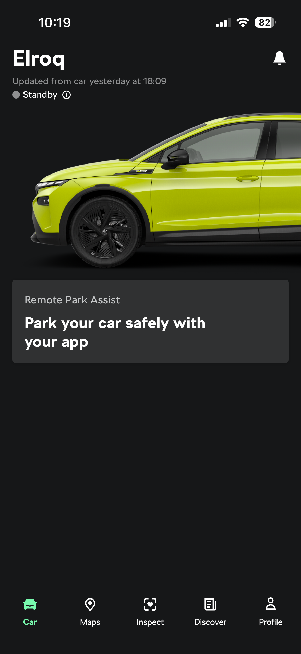

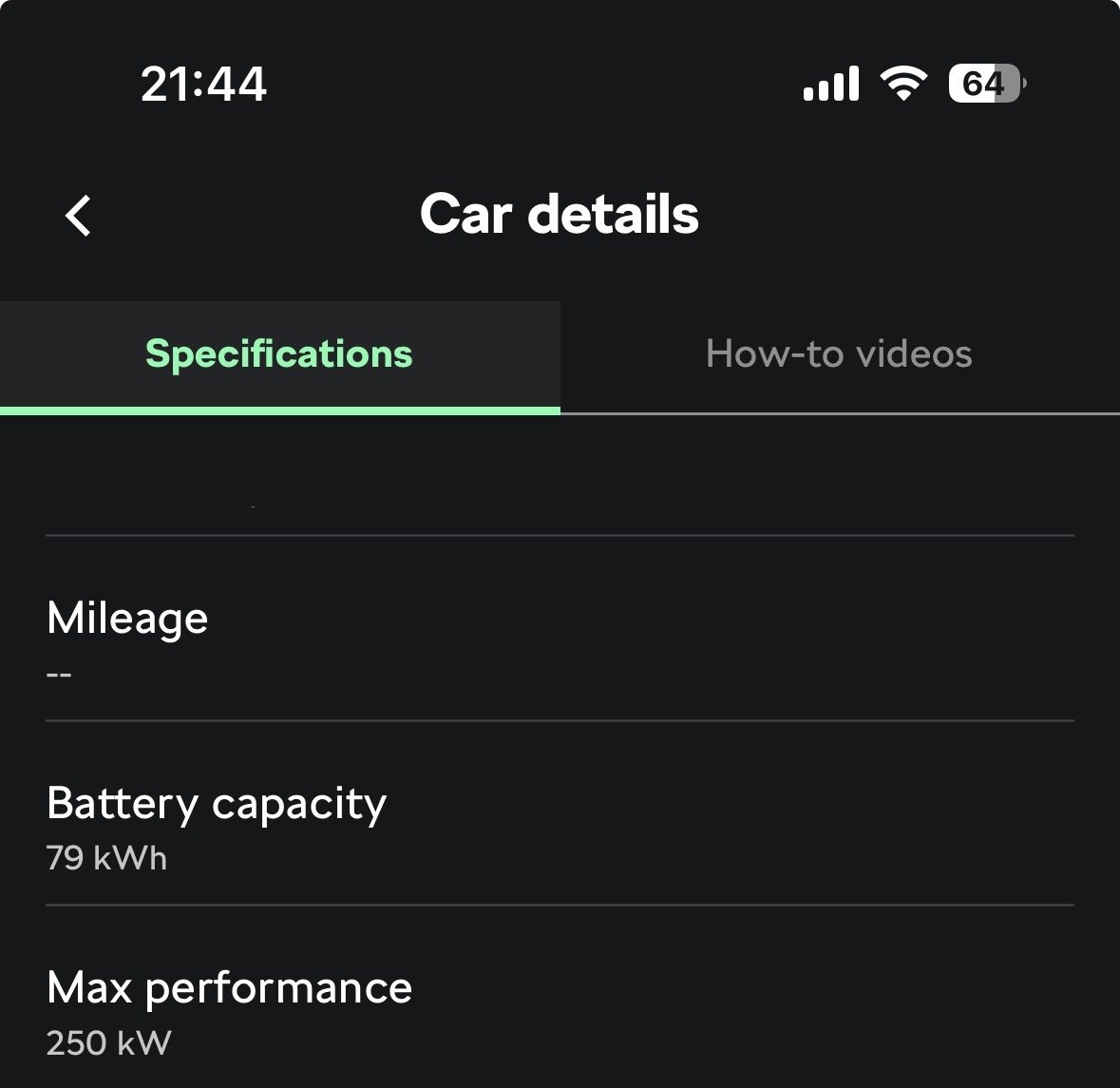

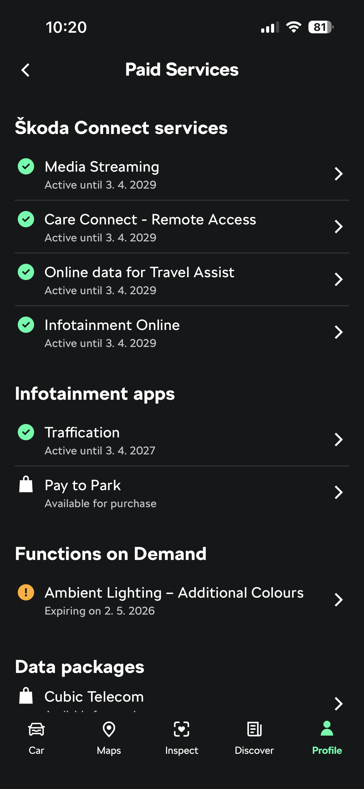

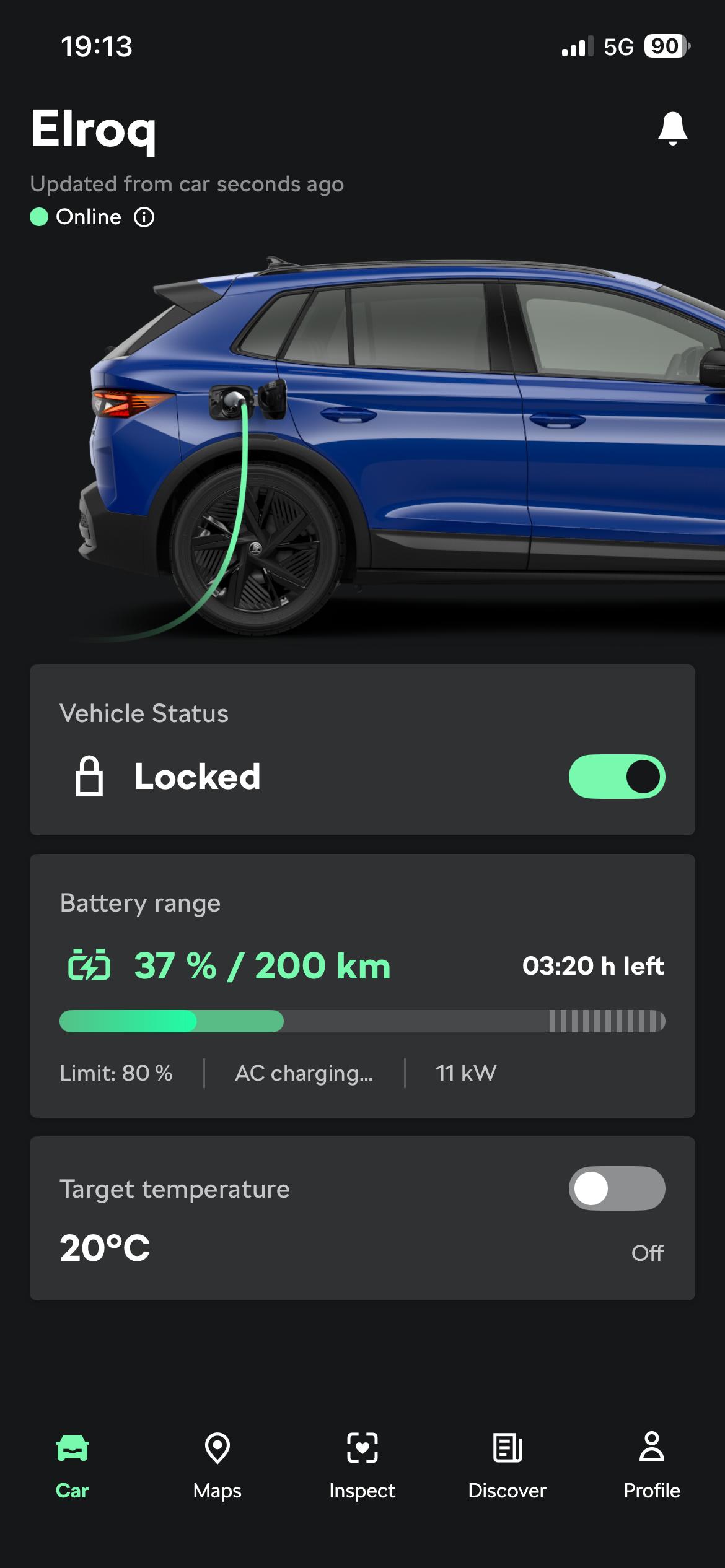

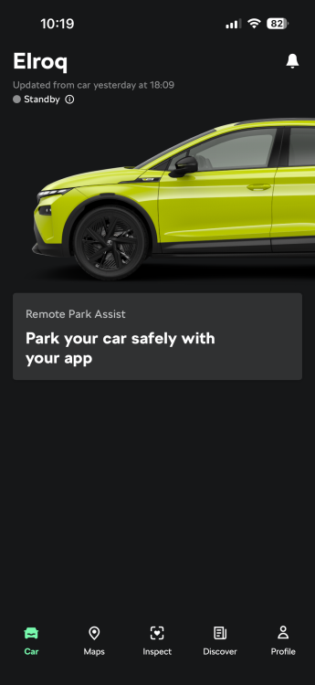

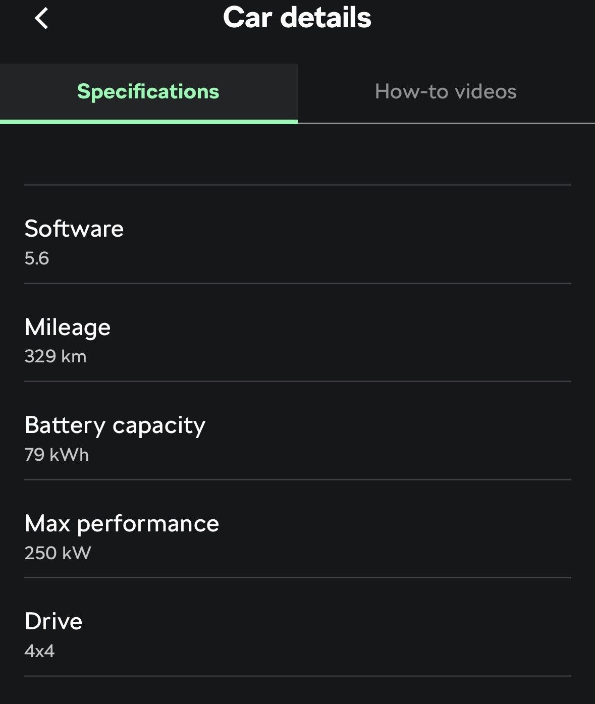

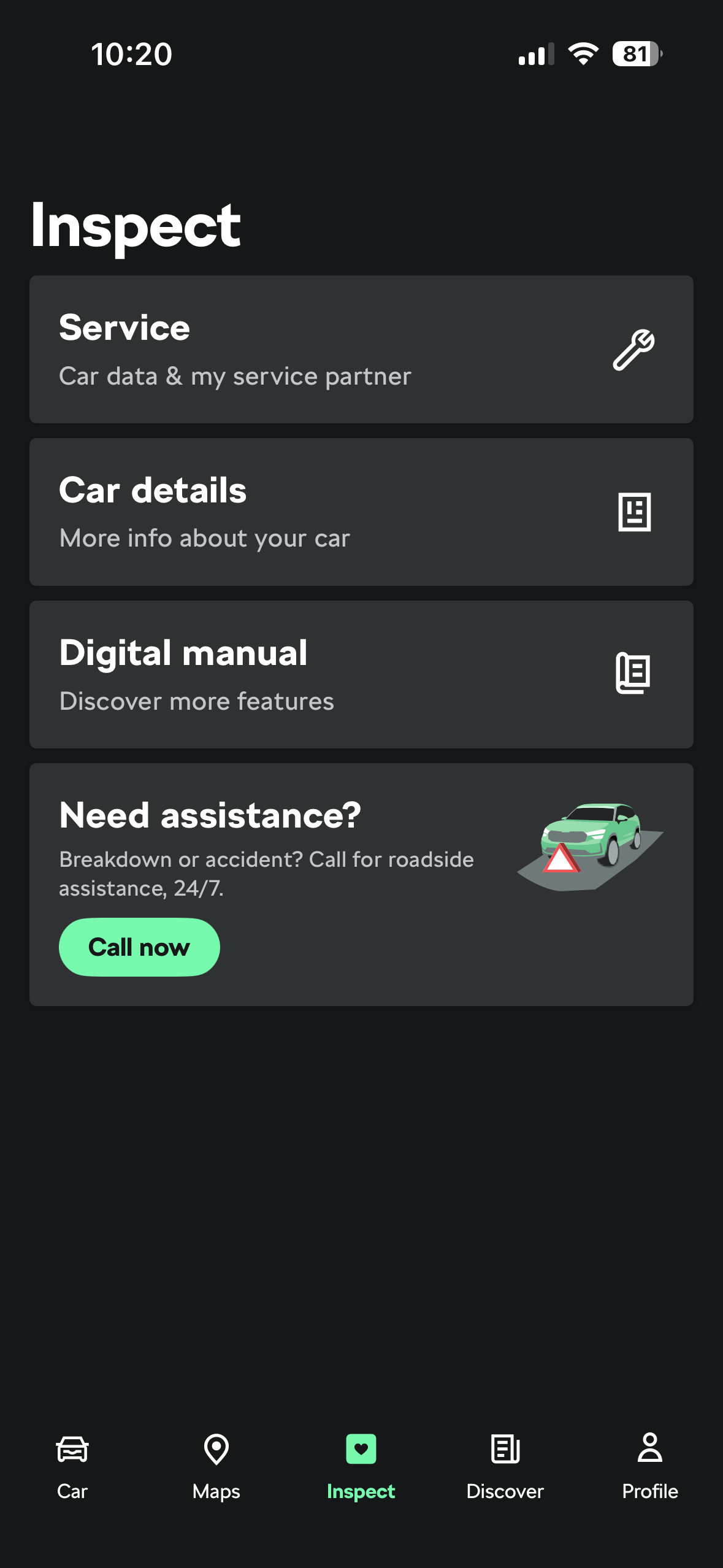

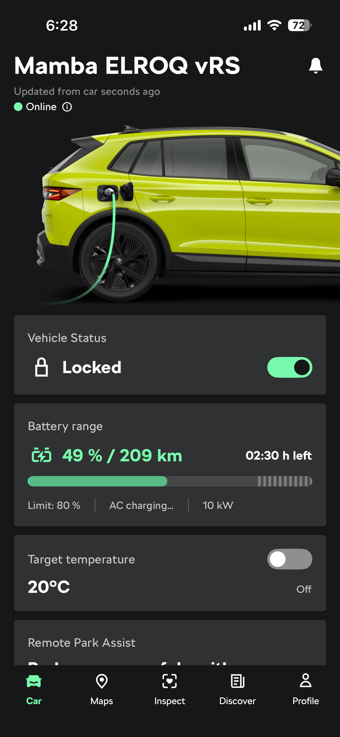

  8. Hi everyone, I’m struggling with the MySkoda app on my newly delivered Elroq. While my colleague’s app works perfectly (the blue car in the photos), mine is missing almost all telemetry. I can only see the "Remote Parking" card, but no battery status (SoC), range, climate control or digital certificate. Steps taken so far: Enabled all Privacy & Data sharing settings in the infotainment. Removed and re-added the car to the app. Reinstalled the MySkoda app. Verified that "Care Connect - Remote Access" is active until April 2029. The weird part is that the basic connectivity seems fine—the odometer (total mileage) updates correctly, and profile sync (like changing my nickname) works instantly. I spoke with a former Skoda dealer, and his theory is that the car hasn't been officially reported as "Sold/Delivered" (RDR status) in the master sales database yet. The car arrived at the dealership on Thursday morning, and I took delivery that same afternoon. Is it possible that the backend restricts telemetry scopes until the sales database syncs with the SkodaID/Connect services? Has anyone experienced this "partial" activation? Does it just need a few days for the databases to sync? Thanks for any insights! Colleague’s Elroq (missing Remote Park Assist is OK):
