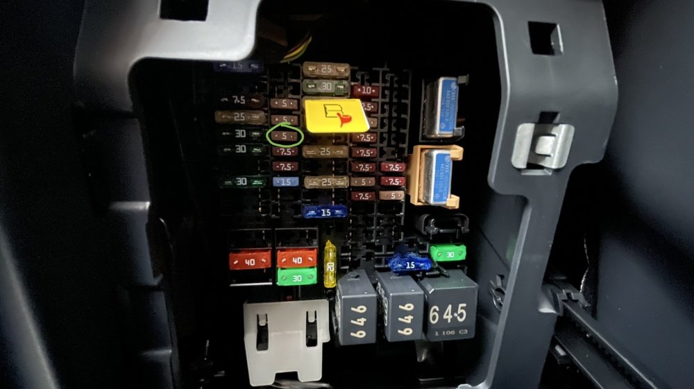

Otherwise reset the comms module:
Turn the car off, pull fuse 19 (in glovebox), wait 2 minutes, put fuse 19 back in, turn car on and wait 10-15 minutes. This resets the communications module in the car and forces it to search for a signal again. It can take 10-15 minutes so be patient.

This is fuse 19
