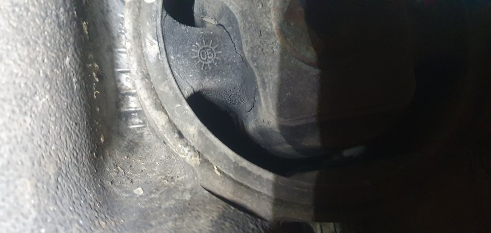

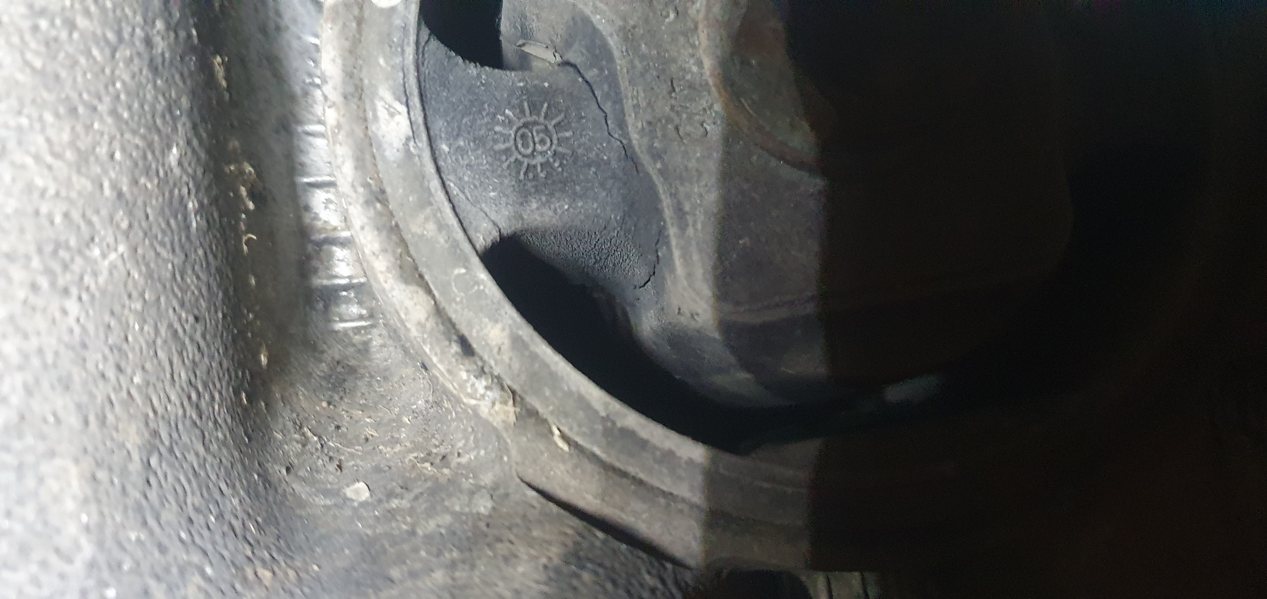

Is this abnormal engine movement on gear engage fw/r while brake is on?
Here is a photo of the bush. There's clearly play and I think evidence of cracks. I don't have a press for the dog bone and they are like £120 to buy. Anyone know time allocated to the job if getting one fitted? I sadly have to weigh up costs... I guess I could remove subframe and ask if a garage could press one in if mental money?
