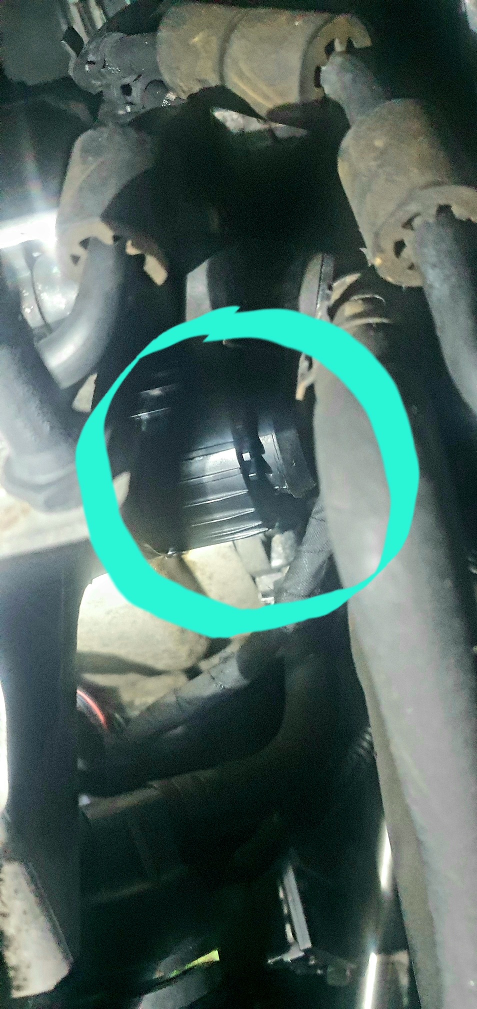

  4. On the right of the cylinder head of my 05 TDI 1.9 Octavia Elegance there is this component that I think has a bad gasket causing oil loss. Anyone know the name of this component circled in picture?

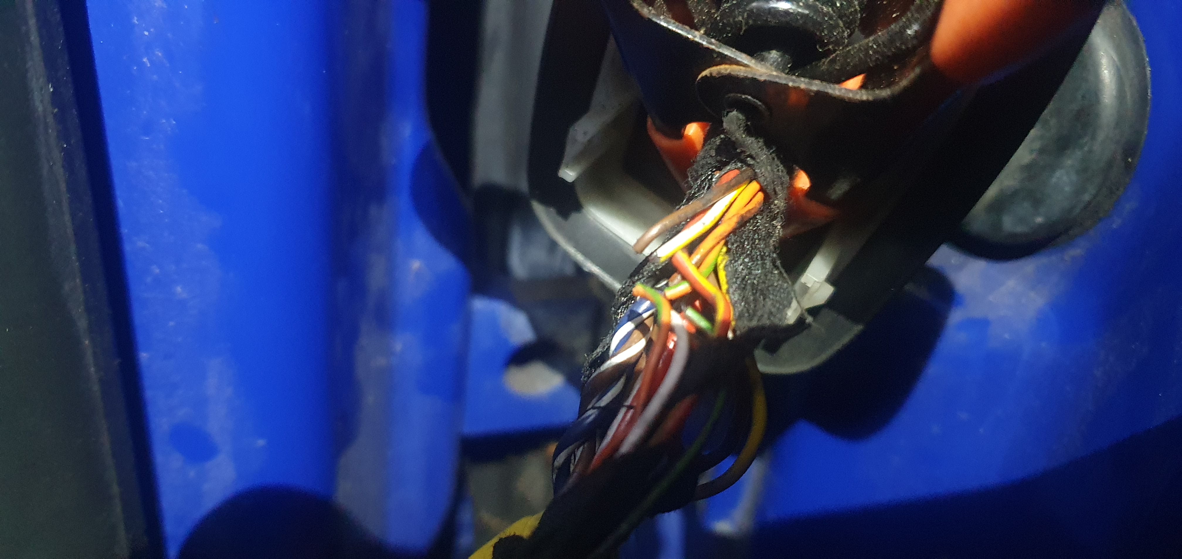

  7. This issue was visible as soon as surround was pulled back. Between door and pillar. Did not need to remove panel at all. easy fix with solder and heat shrink tube/tape - even if you have to taker panel off. Used blade to remove cloth wrap btw.

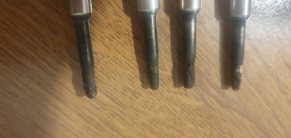

  9. For me to believe that I would need the data that no PD engine has ever broken from a Glow Plug Tip. Maybe the fault was not fixed. Carbon build up can fry plugs (hopefully not my issue ) - you can remove carbon deposits with a reamer
  10. VCDS, or any compatible engine code scanner/reader would be able to tell you if there was an electrical fault, or other - maybe in the glow plug circuit. Often just a pointer to further tests... Like I said I am only guessing, and you will need to research more. Glow plugs in situ, to a degree, can be tested with a multimetre. Plenty of videos on YouTube. Question is, what would you do if you found out that you have faulty glow plugs? Your vehicle has 220, 000 on clock. It can be a total pain job with some real horror stories if it goes wrong. If you are good mechanically, or can afford to go as deep as the rabbit hole takes you, then maybe but hmmmm. I mean mine had two not even working, and still started - rough idle though, diesel knock, and a risk of glow plug tip breaking off (maybe). And all this is speculation as I don't know for sure anyway. Maybe others have better experience or more accurate diagnosis.

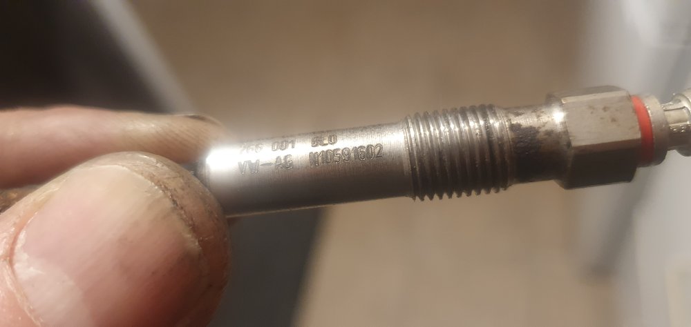

  13. Just spent two days loving the glow plugs out of a 1.9tdi Elegance Octavia Estate: 177 thousand miles on clock. The glow plugs I assume are originals as there is no voltage information, just the following: The plugs read 266 001 BEO N10591602 VW-AG Beru Germany 531 Photos show old plugs. condition of tips 🙈 Are these the original? And are these a suitable replacement? BERU ISS GE100 Glow Plug 5V 25A M10x1,0 | Order now! (onlinecarparts.co.uk)
  14. Thanks for everyone's quick response. The issue was broken wires between the drivers door and connectors on pillar. See photo for issue causing problem: Fixed by soldering and insulating wires.
