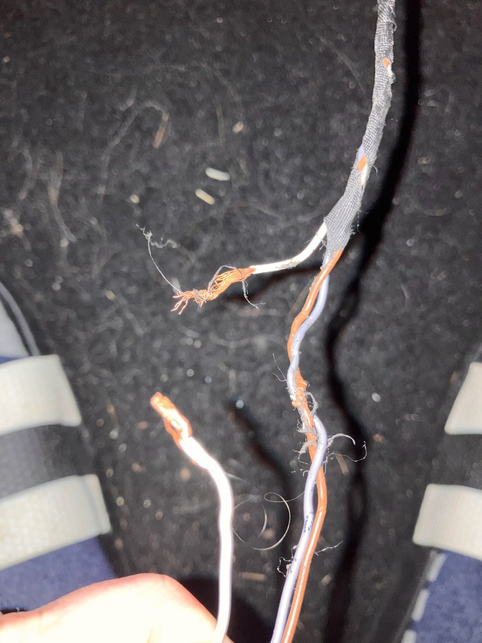

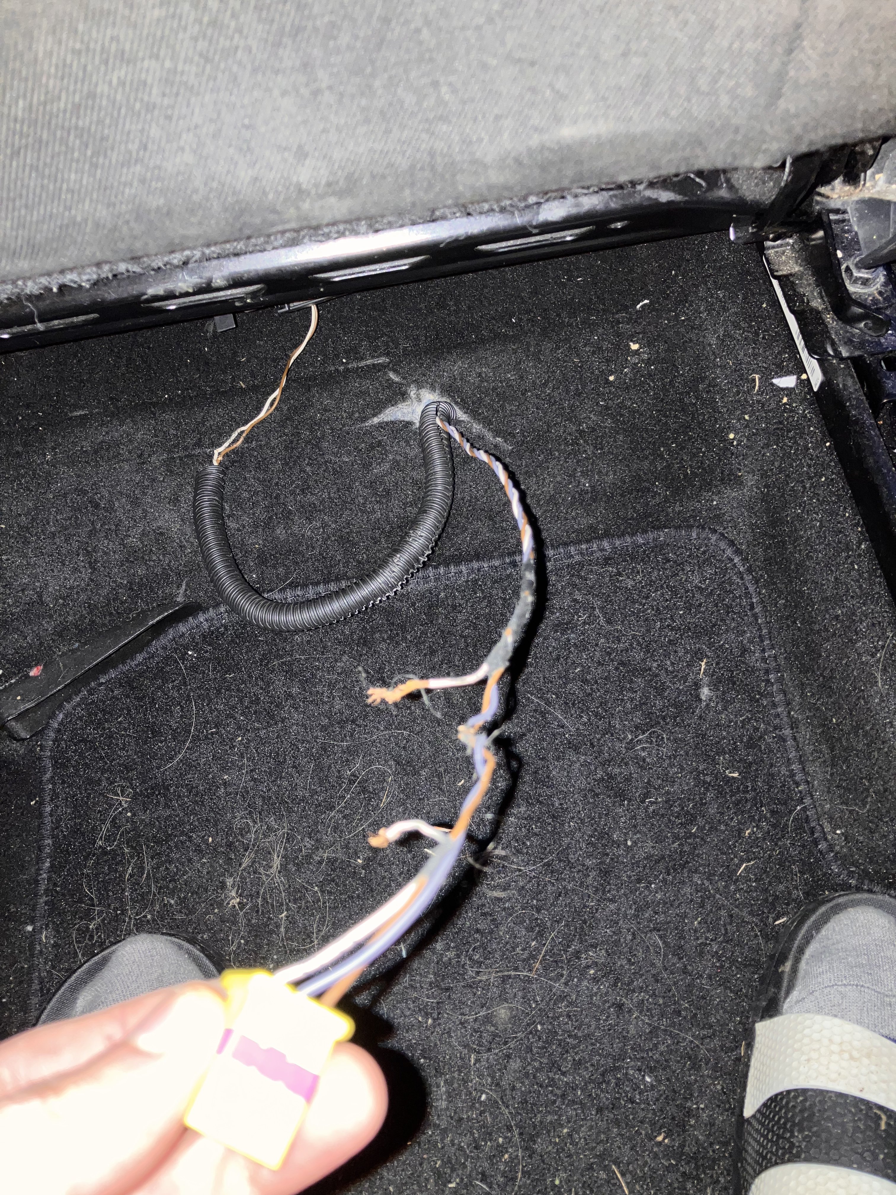

  5. Hahaha, that’s where he is going from now on! This is what I’m looking at: im unsure of my plan of attack, I’ll be honest! I have an iron solder, heat shrink an electric solder. But looking at it, it looks beyond repair.
  6. Hi Ken was thinking the same. The scenario is, my puppy cocker has decided to taste the wires and cut clean through the cable. And it’s the cable that runs underneath the rear carpet — unsure if it detaches yet! The top one — thanks! I don’t want to solder the wiring but I may have to.

  8. Hi does anybody know the part number for the yellow plug that goes alongside the green one, under the drivers seat i can’t find it for the life of me Thanks
