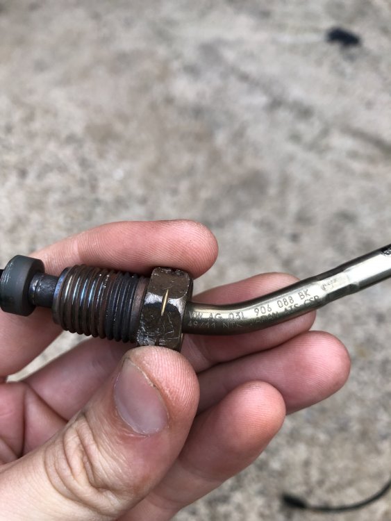

Yes, brand new will be rather expensive, hence why I went with second hand. Buy from skoda or ebay is my advice. I bought mine from ebay. VW Caddy. Brown plug. Yes the brown plug leads to the sensor you need to replace. All EGT sensor are the same. or most. They all are L shaped with an aluminium sleeve. I did the diagnosing myself, with a little help locating bank 1 sensor 3 from briskoda - as always. The exact one i bought and fitted; 03L906088BK Brown plug. VW Caddy. Attached photos. Also if you have an ODB scanner to hand , please check your DPF input gas temperature as below, if it reads a ridiculous temperature it’s 1000% the same error i had (not that i’m already certain it is).

The brown plug leads to an EGT sensor which reads the exhaust temperature before it goes through the DPF, if you read the ‘DPF inlet temperature’ using an OBD scanner it will read 999 degrees celsius. That’s the error your ECU is reading and what the Glowplug engine management light will be on for. bare in mind i had the exact same issue as yourself and i have fixed it. will edit with a screenshot of my odb reading from when i had the problem. 😁

You will need to get underneath, unplug the brown one, find where it’s going to and hey presto, remove the sensor. As the sensor is broken anyway i would recommend clipping the wire with pliers and getting a 17mm open end ratchet spanner, there is a little bit of sleeve before the sensor, clip the wire right before that unless you have something that can clip through steel/aluminium whatever it is you will know what i mean when you’re underneath and why i clipped the wiring

Hi, as previously stated this is the part you need, and sorted me out with the sensor 3 issue. the sensor routes to the brown plug which is near the DPF sensor (black plug), disregard that sensor. https://www.ebay.co.uk/itm/Skoda-Fabia-2-II-5J-Bj-10-1-6TDi-Exhaust-Gas-Temperature-Sensor-03L906088-BK-/165012194277?mkcid=16&mkevt=1&_trksid=p2349624.m46890.l49286&mkrid=710-127635-2958-0

it SHOULD work, the biggest task will be removing the actual sensor from the manifold. if you have limited space and aren’t comfortable removing unfamiliar parts, i would suggest cutting the wiring just past the metal sleeve, so you can get maybe and angled ratchet spanner on it. or there are two inlets that run through the midsection at the back of the engine wall (firewall), have a look into removing them if you have taken out the air box housing already & manoeuvring through that way. 😁

Very frustrating to get to from the top, so you may aswell save yourself some time and jack it up and attack from the underneath, rather than the top. I got myself the same sensor from a VW Caddy, took out the sensor from the socket and plugged in the replacement, the DPF inlet temperature was back to normal. Have fun😁

Hi faz presuming you have it fixed now but if you have gave up. that is the wrong connector on the end. the end of the part code should have BK (not EC) on the end and should be black not orange 😁 i have the same engine as you. 03L906088BK the one you’re looking for.
