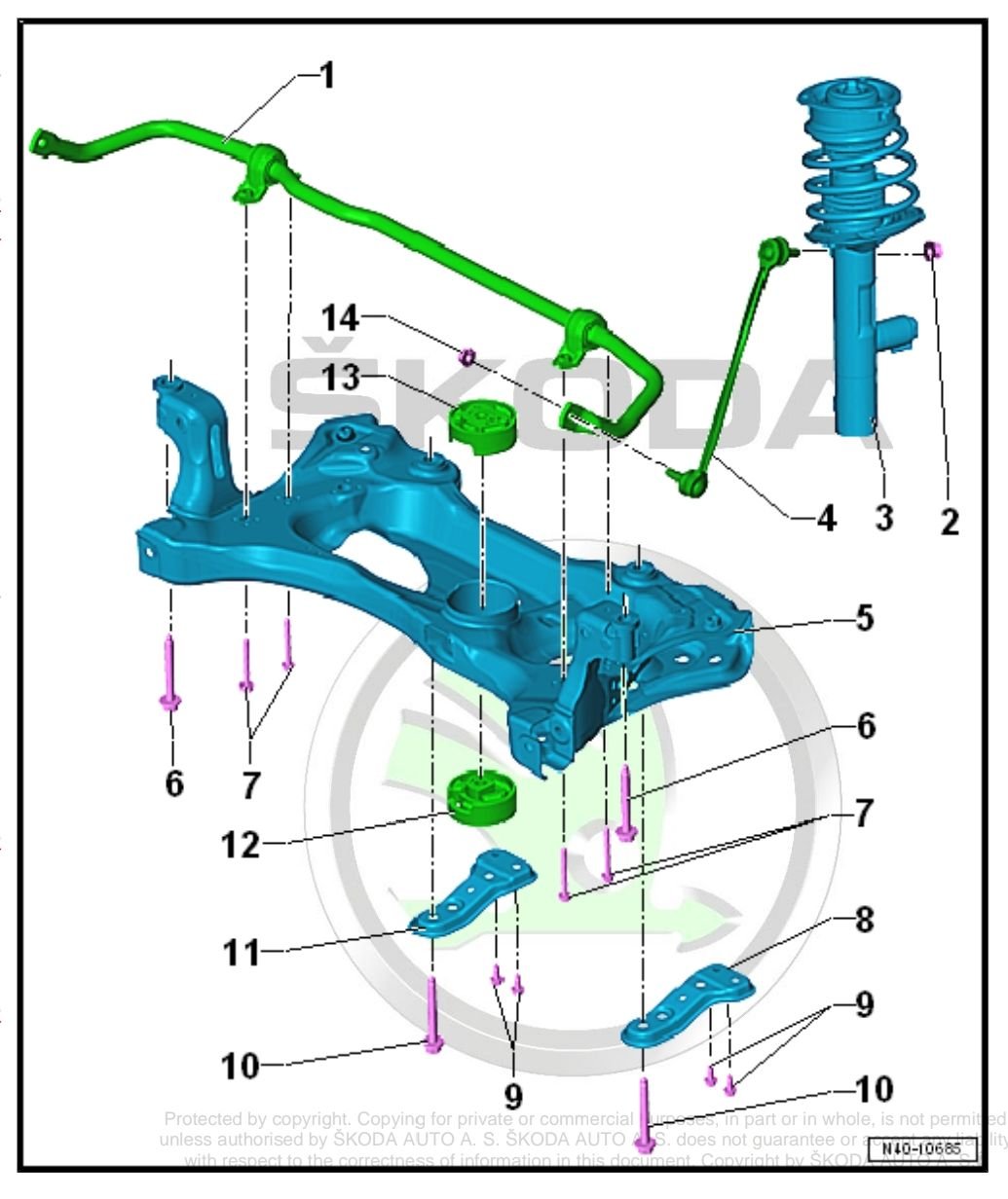

  1. I didn't get dust covers and rubbers when I bought the bilstein b12's but I didn't buy with strut mounts, got them under a different brand. Fortunately though my existing were in good nick so just kept them.

  3. Thanks @ApertureS, I've ordered them after @Breezy_Pete helped find them last night so i'll switch them over whilst looking for the issue. @Breezy_Pete, I tightened them as per the manual, 70nm torque plus 180 i think it was for the 4 main bolts. @ApertureS, I looked into the subframe fixing kit but couldn't find one to buy and seemed to simply locate 'fixed' positions on the assembly with 'fixed' positions on the chassis so felt more like it was just for making 'lining up' easier rather than actually preventing movement so I didn't bother. Mistake??? Thanks both.

  7. Hi. I've taken my assembly carrier off to clean the dpf and getting some creaking noises when driving after refitting. Wondering now if should have replaced the screws as advised in the manual but I can't find where to buy them anywhere on the Web - If anyone can point me to a site that sells them please I'd be very grateful. I need screws 6, o an 10 in the attached image. Car has a CRLB engine, 2016 2.0l diesel. Thanks all.

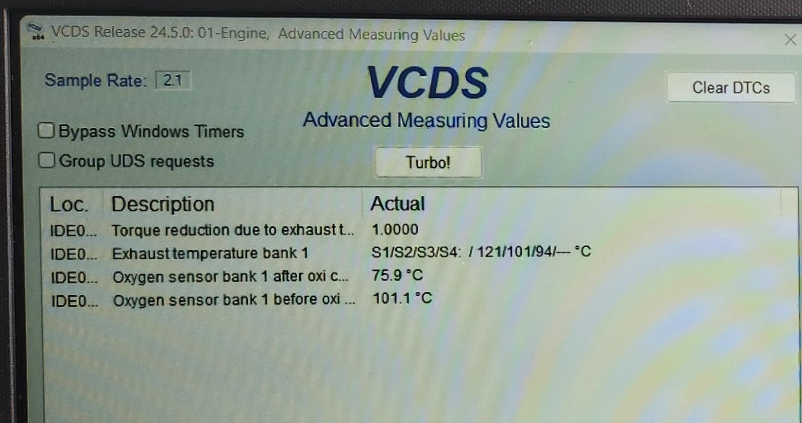

  8. Hi. I feel your pain. I'm experiencing the same thing with a CRLB engine, 2016 plate 2.0 diesel. Mines every 40 miles though and regularly lose power at high speeds during the regen, dropping to 50/60 mph and then bounces back to normal when the regen has finished. I've done all kinds of things to resolve it but with no codes I've been struggling for over a year now to sort it. Happy to share what I've done but nothings fixed it yet, although some things helped for a while.

  11. Hi. As part of my neverending pursuit to find a cause of high speed torque loss (I'll share my woes on this one day!) I came across what could be an issue/cause but hoping you could all help me out please. I plugged my VCDS in to check EGT sensor temperatures and appear not to be getting a reading on sensor 4. Please see attached picture. I see online that not all engines have 4 sensors but the one that's usually missing is Sensor #2 rather than #4, and I'm sure my engine, the CRLB, is supposed to have 4. Can anyone confirm how many sensors there should be please and any info on why one would show as "--", what effect this could have etc. would be greatly appreciated!! Car is a 16 plate with CRLB engine. Many Thanks.
