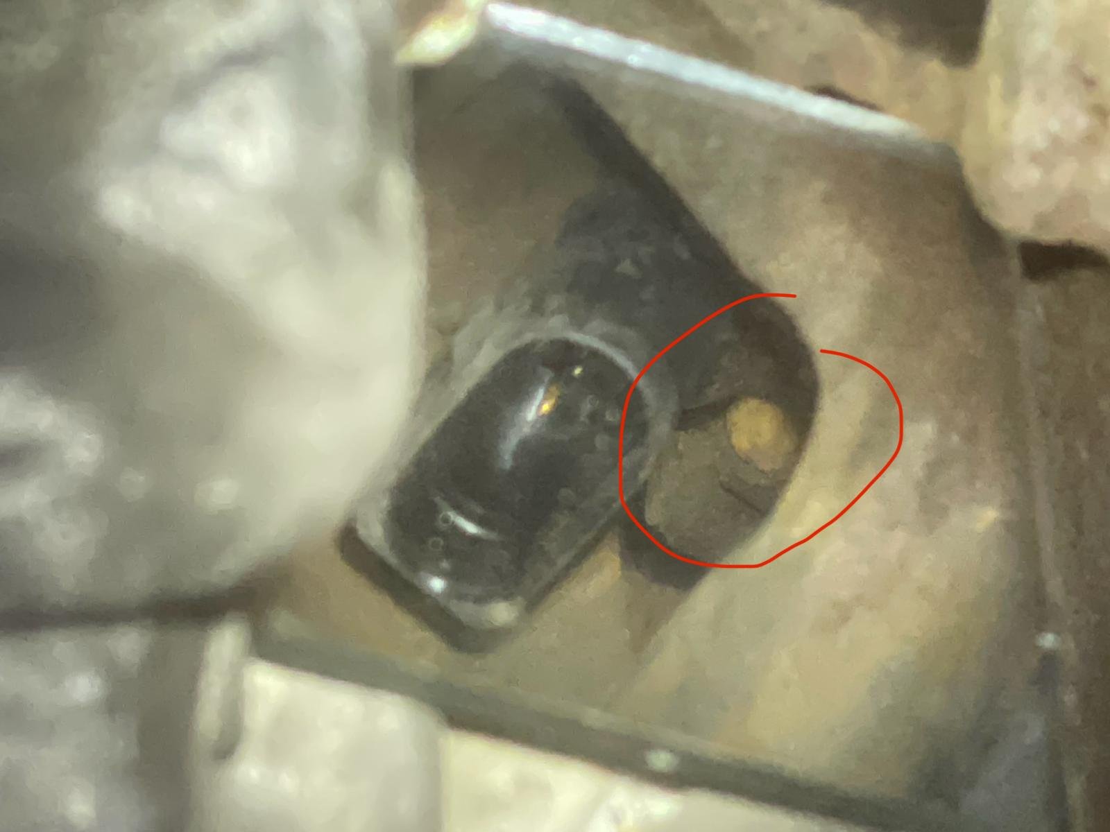

  4. Hi Pete, Please excuse this post out of the blue, but you clearly know what you’re talking about. Could you advise me? I have had a 2005 Skoda Octavia mk 2 since 2008 and I’ve looked after her like an old friend. The crankshaft sensor has gone faulty on it and my mechanic has spent nearly two hours trying to remove it. The problem is the top of it is severely corroded (see pic) and he just can’t get any purchase on it to remove it. The only solution is to drop the gearbox out, he says, and the would cost around a grand (as it would be crazy not to replace the 224k mile clutch at the same time). He’s a top bloke and excellent mechanic, but I just wondered if you knew of any hacks for removing a corroded sensor, before I sadly condemn the car as beyond economic repair, as my chap has suggested I consider. I’m a bit gutted it’s going out this way, for a rather trivial failure. Any pointers gratefully received. Thanks in advance. Pete Hi Pete, Please excuse this post out of the blue, but you clearly know what you’re talking about. Could you advise me? I have had a 2005 Skoda Octavia mk 2 since 2008 and I’ve looked after her like an old friend. The crankshaft sensor has gone faulty on it and my mechanic has spent nearly two hours trying to remove it. The problem is the top of it is severely corroded (see pic) and he just can’t get any purchase on it to remove it. The only solution is to drop the gearbox out, he says, and the would cost around a grand (as it would be crazy not to replace the 224k mile clutch at the same time). He’s a top bloke and excellent mechanic, but I just wondered if you knew of any hacks for removing a corroded sensor, before I sadly condemn the car as beyond economic repair, as my chap has suggested I consider. I’m a bit gutted it’s going out this way, for a rather trivial failure. Any pointers gratefully received. Thanks in advance. Pete
  5. Hi! Great advice, which I already followed. Sad story. It’s the crankshaft sensor, which we can’t remove, as the bolt is so heavily corroded. The only answer, it seems, is to drop the gearbox out and possibly have to break the casing. Uneconomic on an 05 car with 224k ( that I’ve lovingly cared for since 2008). Gutted!
