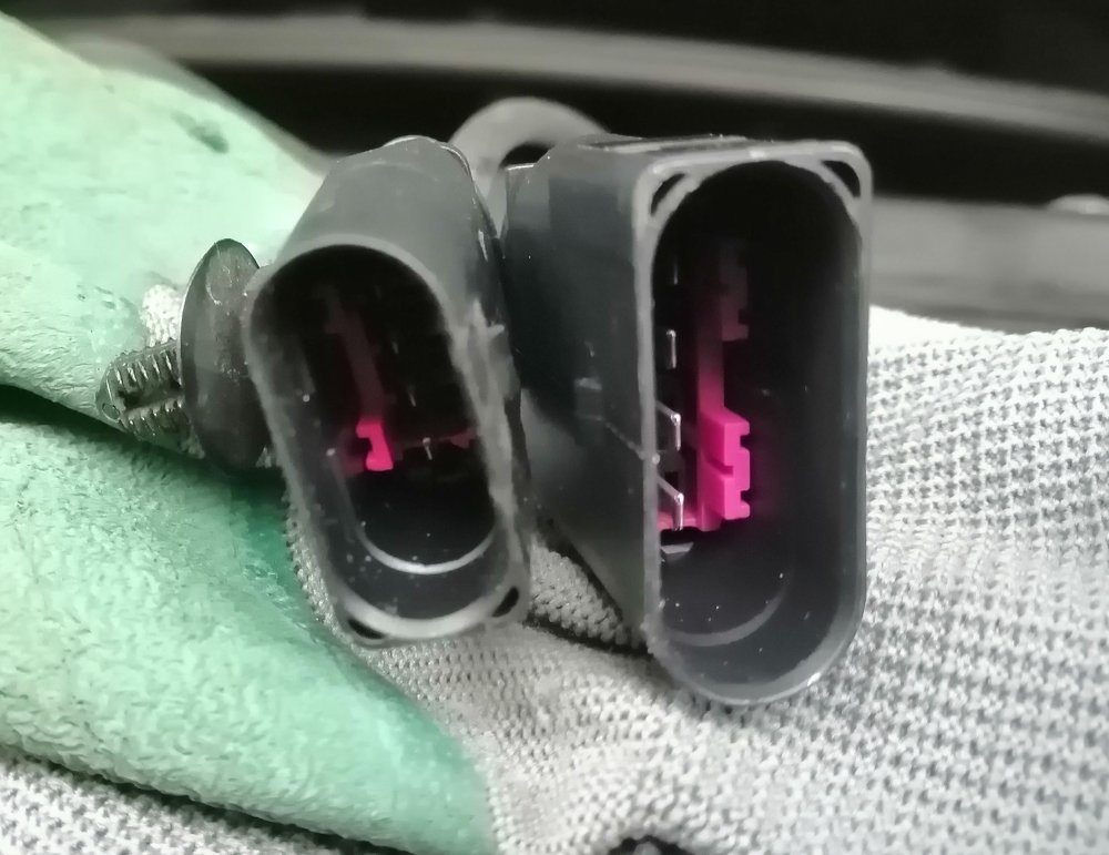

Thank you. The vid was very helpful. I got the plug off eventually. But the new lambda sensor plug is the wrong size. See photo. Ordered off ebay using my reg but still got sent the wrong part. Old plug is left. New plug is right, and obviously too big. Any thoughts. Thank you

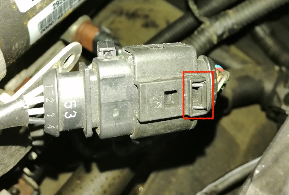

Here is a better picture of the plug/socket. I'm sure I have to do something with the area in red. But I've tried lifting/squeezing/pushing/pulling/poking but it won't budge. Obviously there is a method for getting this undone. I can just about get 2 hands in there. Anyone know ? Cheers

Thanks I will try this. But I'm struggling to remove the plug from the socket. There seem to be clips on both sides of the plug preventing me pulling it out. Looking at a picture of the new plug, I can see I lift a tab on one side but on the other there are two slots than suggest I have to lift it. I can hardly get my hand in there !
