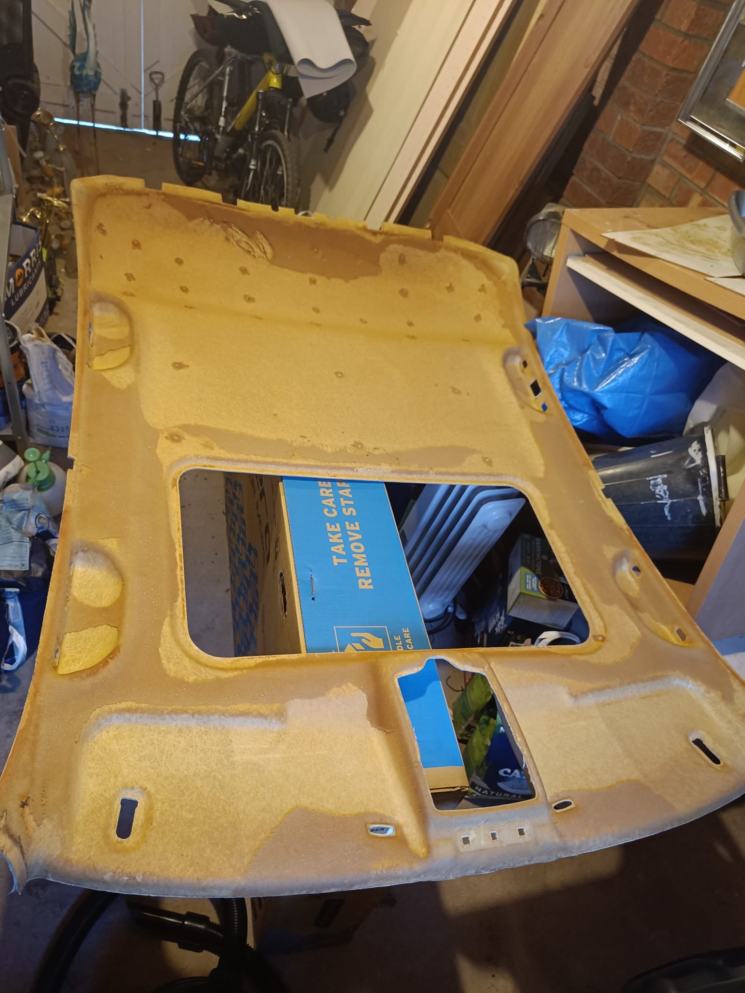

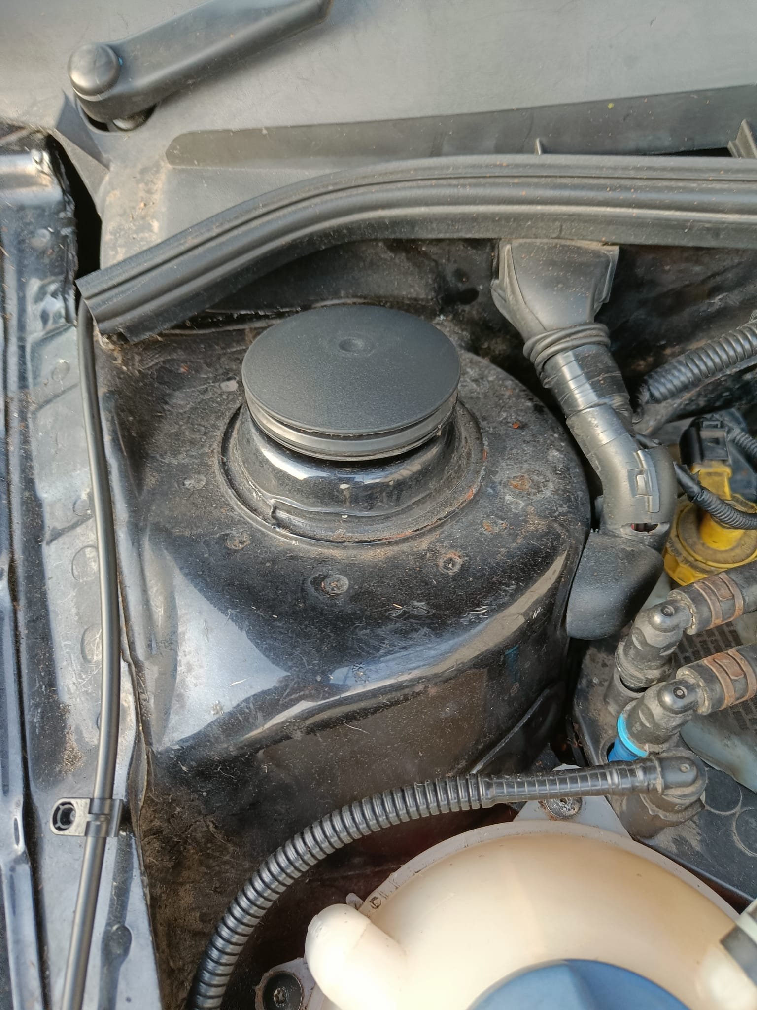

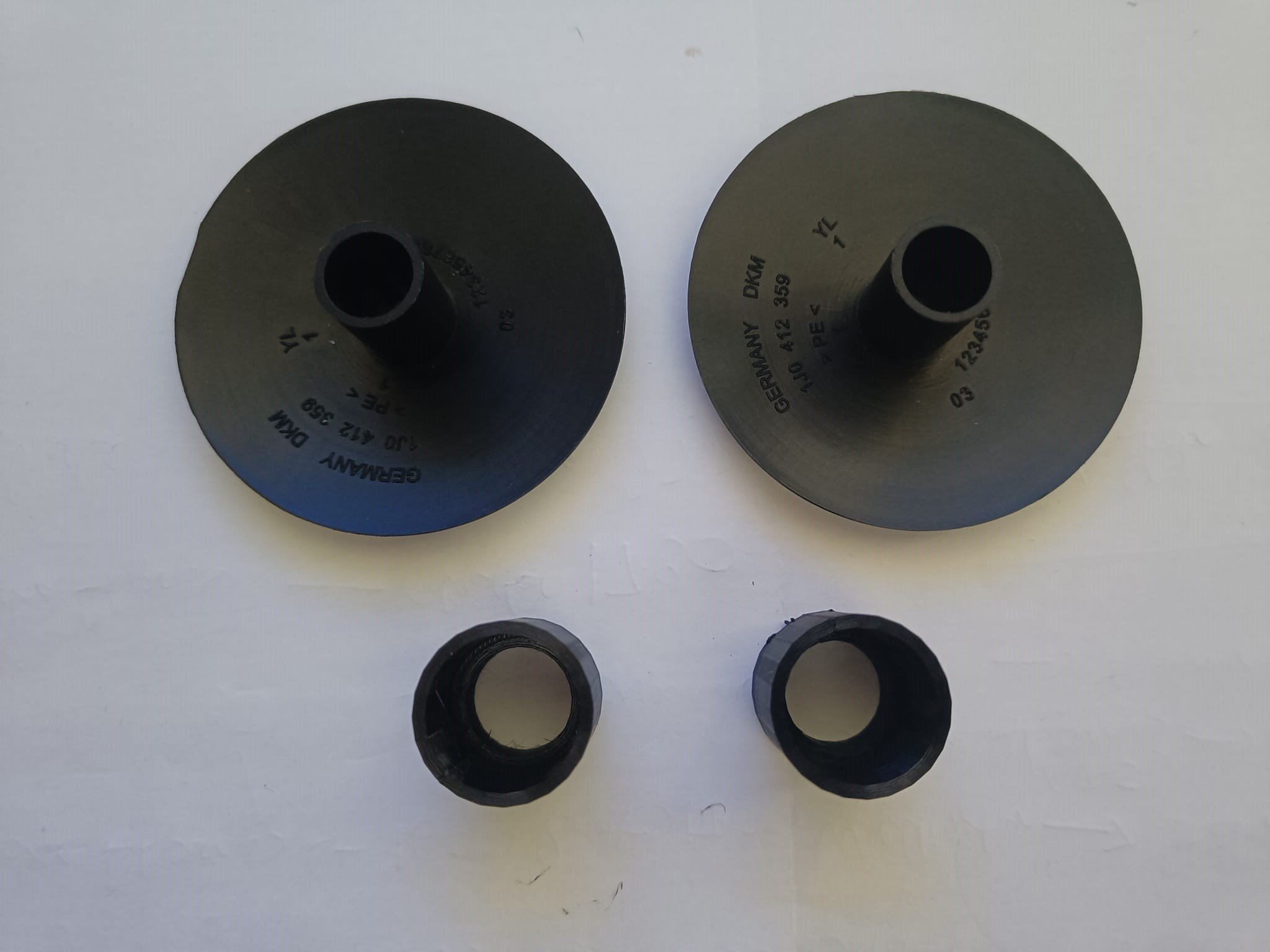

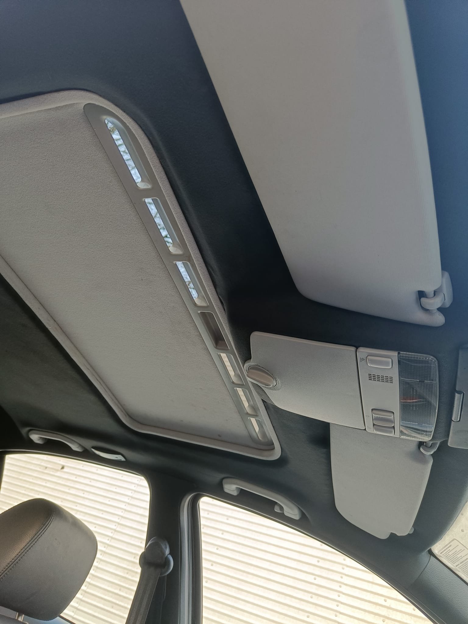

  1. So, the headliner job turned out to be absolute nightmare, i totally messed it up and binned the lot... If any of you want to DIY it, i advise you pay someone the 200-300 quid for retrim and fitting its an absolute PITA of a job.. Here's the pic of the headliner after tearing the old fabric off. After that it took an hour to clean up the old foam and apply contact adhesive before I tried to put the fabric down and work it along all the shapes and curves. I had my brother to help but we failed miserably. I found someone selling an incomplete black headliner set in Birmingham for £80.. didn't even argue about the price and wasted no time getting and fitting it. colour combo is not too bad: My new struts came with brand new 22mm nuts instead of 20mm ones so i 3d printed adapters for the original covers: Finished product:
