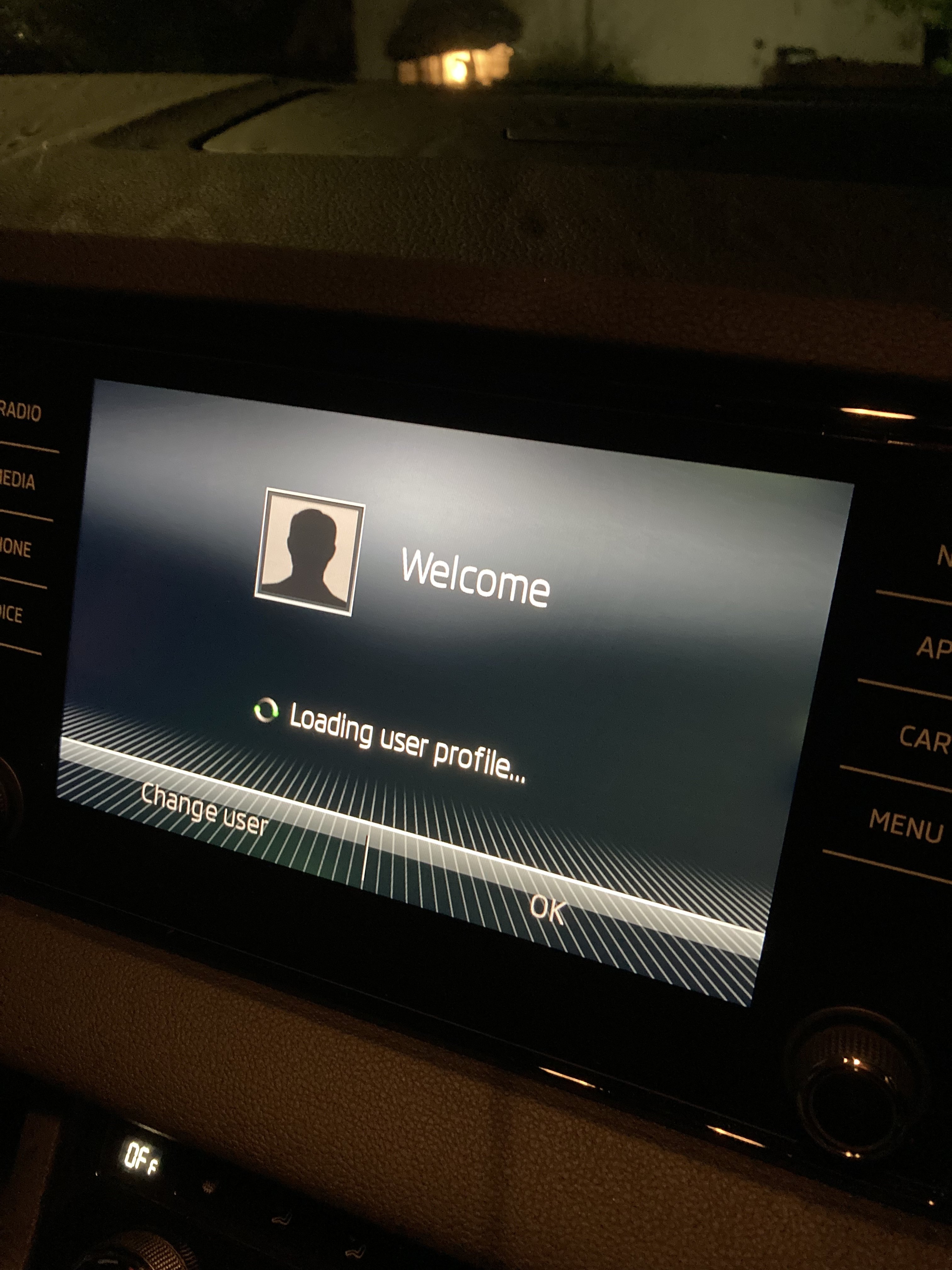

  8. On board diagnostics 🤦🏽‍♂️
  9. Thank for your reply BCEly. Excuse my ignorance, what’s OBD?
  10. Slightly different issue…My 70 plate Karoq had an issue with the infotainment system. There was a message reading ‘SOS error - visit workshop’, or words to that effect, which required a visit to the local Skoda workshop for a software update. Car was in Friday and we collected it Saturday morning. A short time later, my wife and I were both outside the car and it locked itself with both keys inside, but wing mirrors still open and not folded in. Cost £120+VAT to get the car opened by a locksmith. I’ve left the car unlocked before and it has never locked itself, so my question is, could the software update of the infotainment system have reset the car locking system to lock itself if the car is left even for a short period of time. Any help gratefully received, as a claim to the dealer is pending.
  11. Car has been in at the dealership today. Just heard that the 5F unit (in the glovebox) has failed. Seemingly they’ve had a few similar failures recently. 🤷🏽‍♂️
  12. Thanks vegit8. Tried rebooting the computer as suggested, but no luck. I’ll call the dealer tomorrow, as I can’t progress past the ‘loading’ screen
  13. @olderman1 No joy I'm afraid. How do I go about the factory reset?
  14. Thanks olderman1, just tried that and came back in to find your message. A bit alarmed by the loud noise, but happy to hear that's nothing unusual. I'll go and try three times in succession.....
