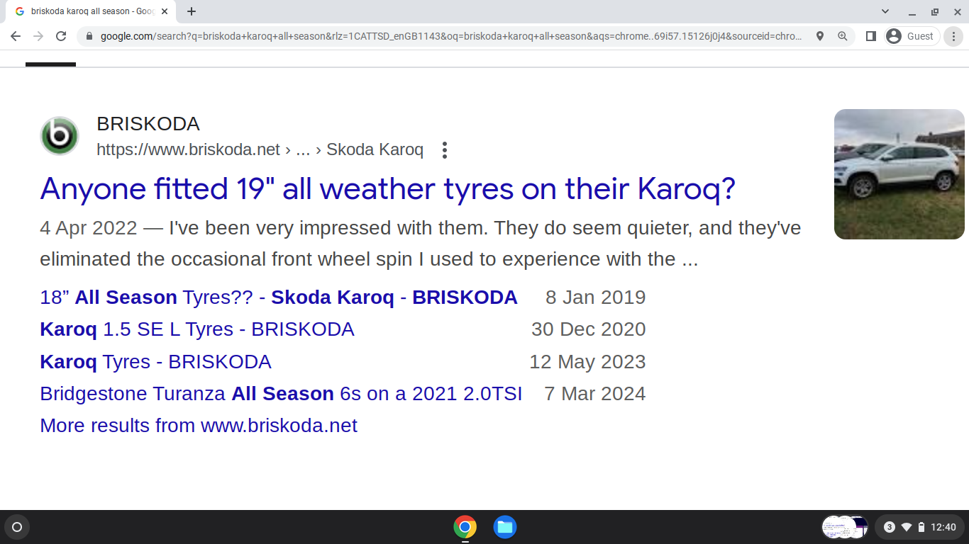

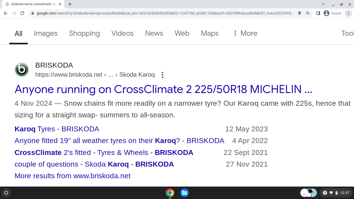

Plenty All Season tyre threads in the Tyre Section, latest vids etc and many in this section.
Various key words.
Briskoda Karoq All Season
Briskoda Karoq Winter
Edited by Ootohere

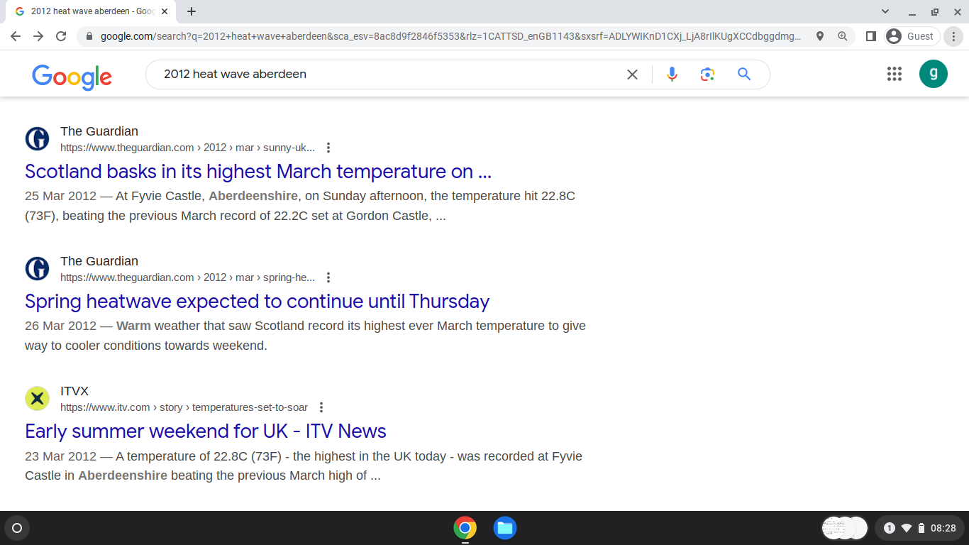

It was 2012 i think we had 23*oC in Aberdeen in March and a few scorchio weeks and it dropped to minus degress on the 2nd April.
May had record Temperatures.

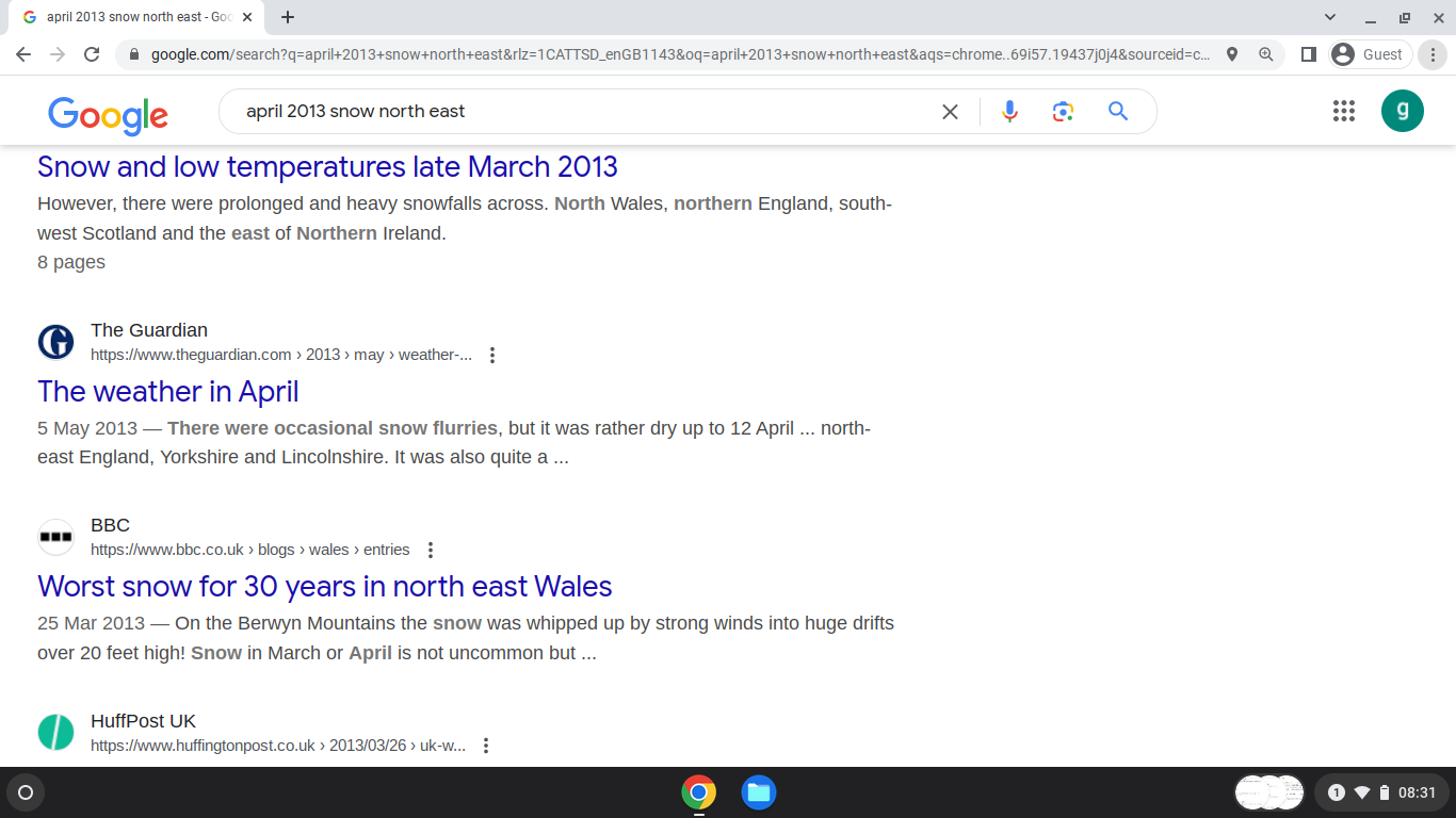

In 2013 and it was March that the snow hit as people sometimes change back from the Winter Tyres.
Edited by Ootohere
