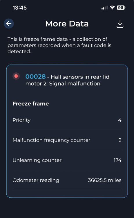

  5. I have found the issue it’s a broken wire in the rubber sleeve on the to of the boot strut! To get at the connector you can remove the lower panel and just release the bottom of the top panel and with a struggle you can get you hand in. The VW is a lot easier acces don’t know why they didn’t do the same it’s definitely a design issue with the loom

  8. I have an issue where my boot, I will only open about 3/4 of the way up and will not close and just beeps when I press the button. I have run a diagnostic and it say the rear hall sensor No2, looks like I need to change the strut does anyone know where the part numbers is positioned on the strut I can’t find it
  9. Does anyone know if it’s a big job to change the boot hall sensor just run a diagnostic and got this error and does anyone know what side the motor 2 is on ? Many thanks
