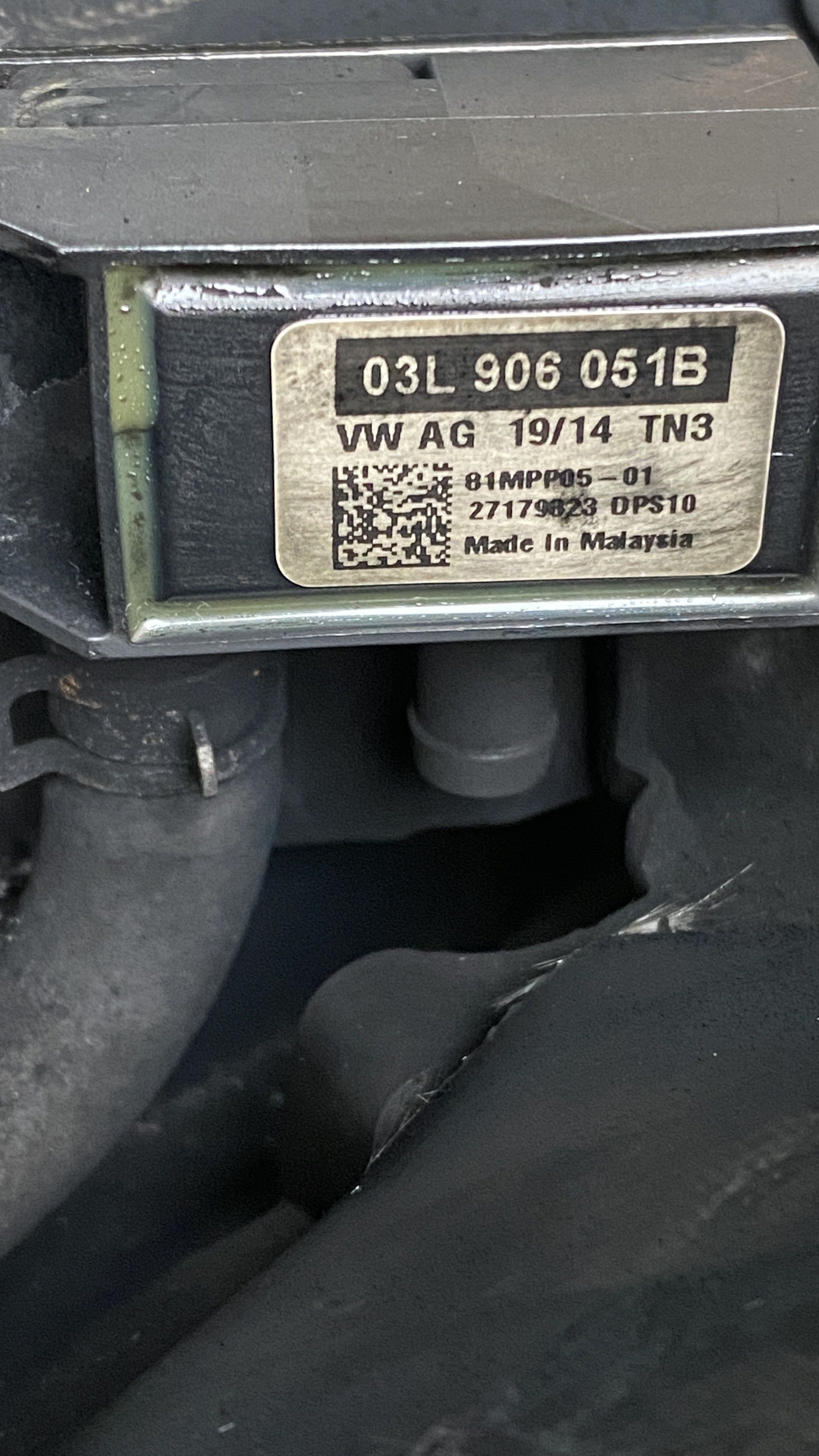

Octavia 5E 2014 150 BHP TDI Loss of Turbo power (not limp mode)
Update on the issue: Wednesday: The replacement sensor arrived and was the correct one. After replacing it and ensuring no other leak points were there. The Fault code was reset. A quick drive confirmed that the power was back and the boost effect of the turbo was back. Thursday: Needed to go to another town 50 Kms away, multi road route with periods of 60Kms speed, Highways of 130Kms and Other roads with 90Kms. What I noticed was an even higher increase in Boost and Torque at all speeds and especially over 1,500 rpm. The same experience on the return journey. What I can surmise from this experience is: 1. The leak had been long standing and only when it lost full pressure the issue came to my attention, thus a reduction of boost based on the sensor readings of the DPF. 2. The new sensor needs re-calibrating and could be reading older values with the new sensor which is causing the increase performance I felt. As I am not able at present to access a VCDS system to reset the sensor I have to just watch and see for a period and adjust my driving style according to the increased performance.. I am not displeased with the extra power. But just to be cautious in case readings from the sensor are wrong and calibration will settle it back. Thanks for everyones input and help each suggestion has been helpful in working out the fault and ability to concentrate on a resolution without the more dedicated tools a garage would have to diagnose quicker. This forum is invaluable for support to us all . So thank you all on this platform for sharing your knowledge and experiences. Hanif
DFP sensor update. The plastic tube which is connecting the pipe was broken at the sensor end Could not be seen until the sensor was removed for inspection. Already ordered a replacement. Does the new sensor need to be coded in before it can work? Can the car be driven without causing any damage before the coding is completed? Any suggestions would be great as having a lot of trouble getting a VCDS system here in Italy
I checked my sensor which is surrounded by a heat shielding faux fabric cover. The inside of this cover was full of soot, so I imagine there is a leak somewhere and possible cause of the error. Unless this is a normal situation? My part number is 03L 906 051B Which is the 2 pipe version sensor but only the left one has a pipe connected to it! Is there an alternative part number or single pipe version I can use if it needs replacing? I want to check for leakages first to ensure there are no other issues before getting a replacement sensor, unless the soot around it is 'normal' The outside local temperature reaches just above freezing at peak during the day so its too cold to spend long time under the bonnet. Can only do a few things at a time..
