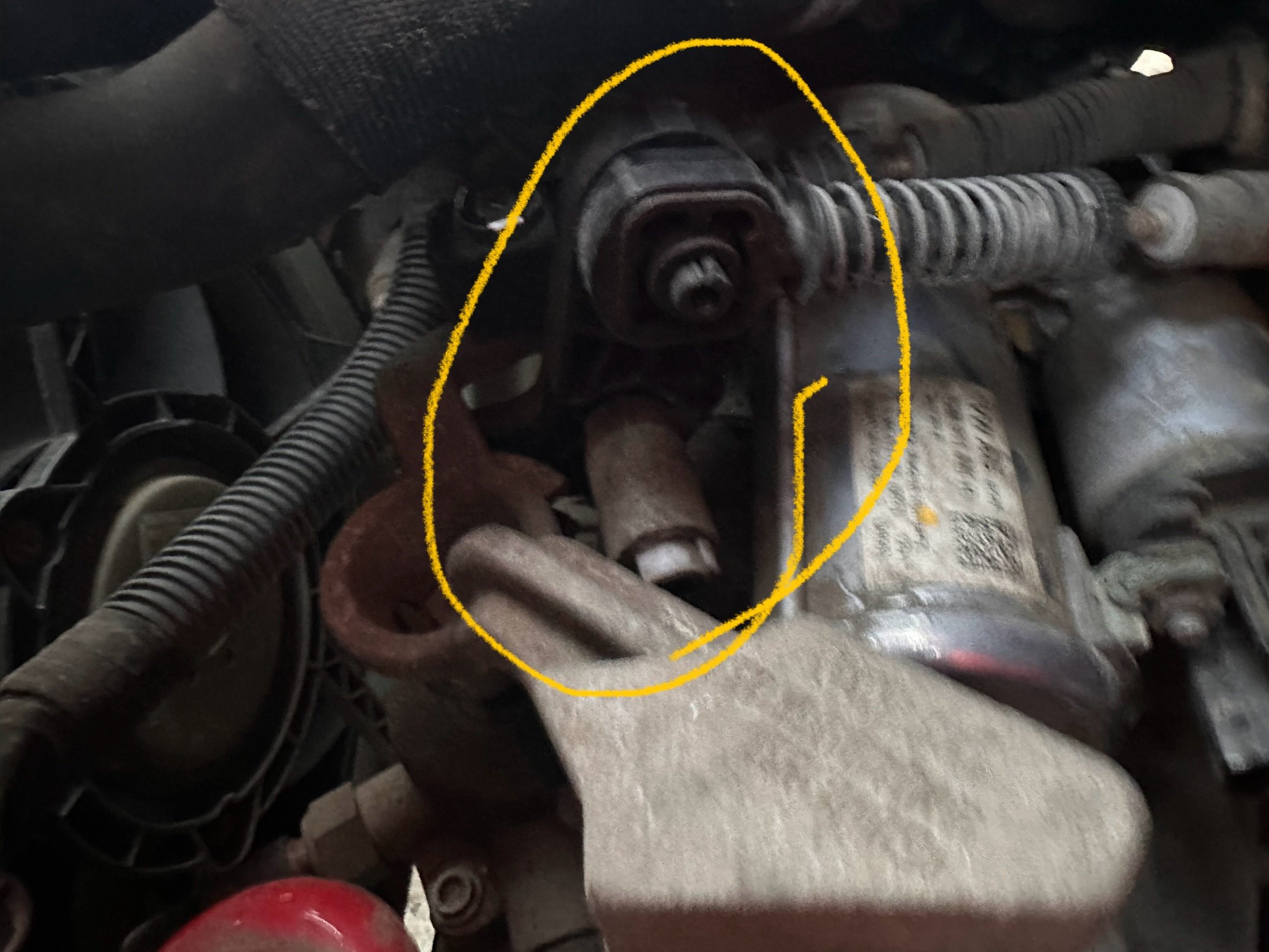

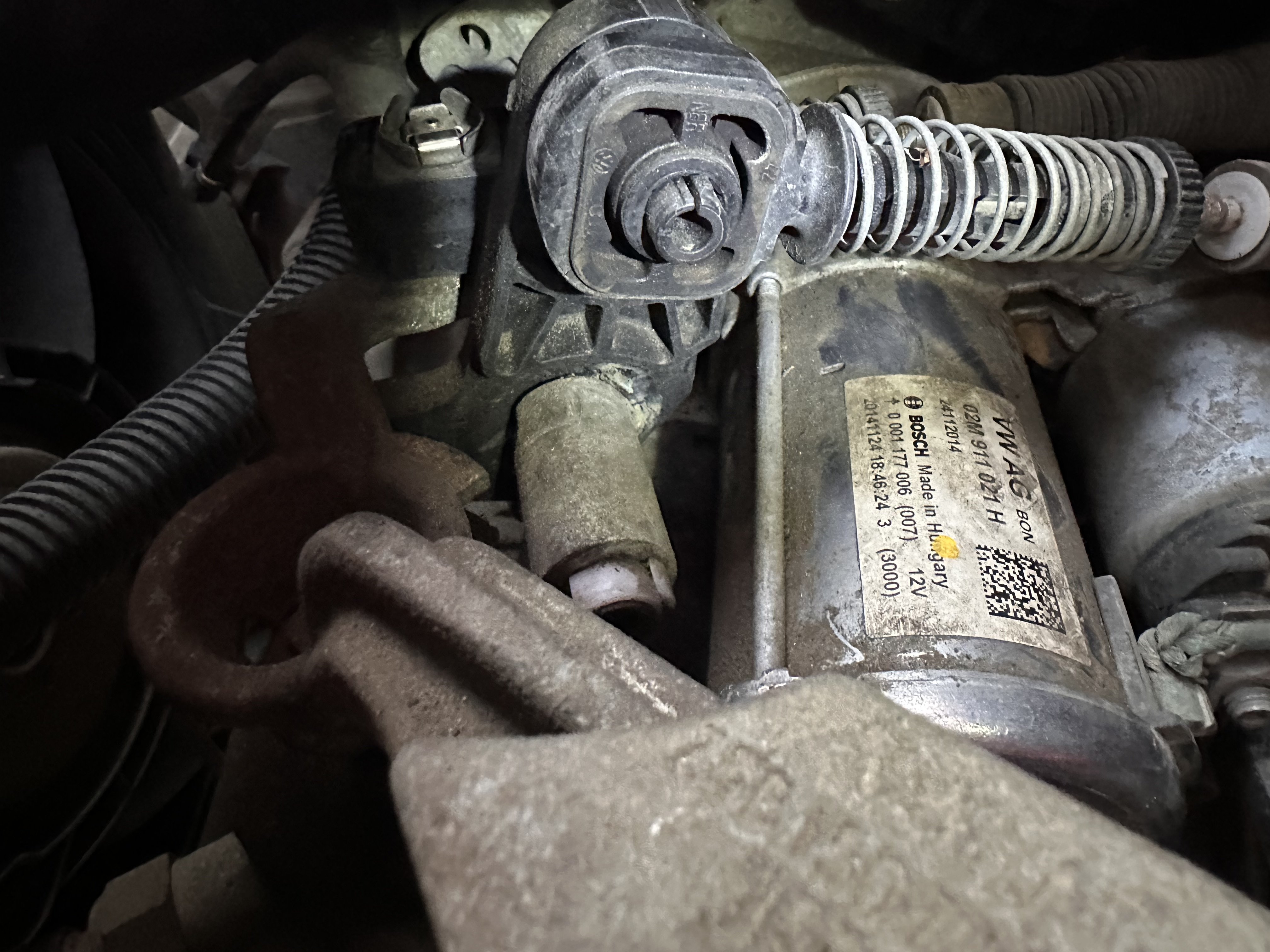

I need advice in removing starter motor on citigo 2015
I took the battery and the battery holder out, the only thing that stand in my way is the gear selector . It is very tight in that area and I can’t see much. How hard is to remove it out of the way and from where to start?

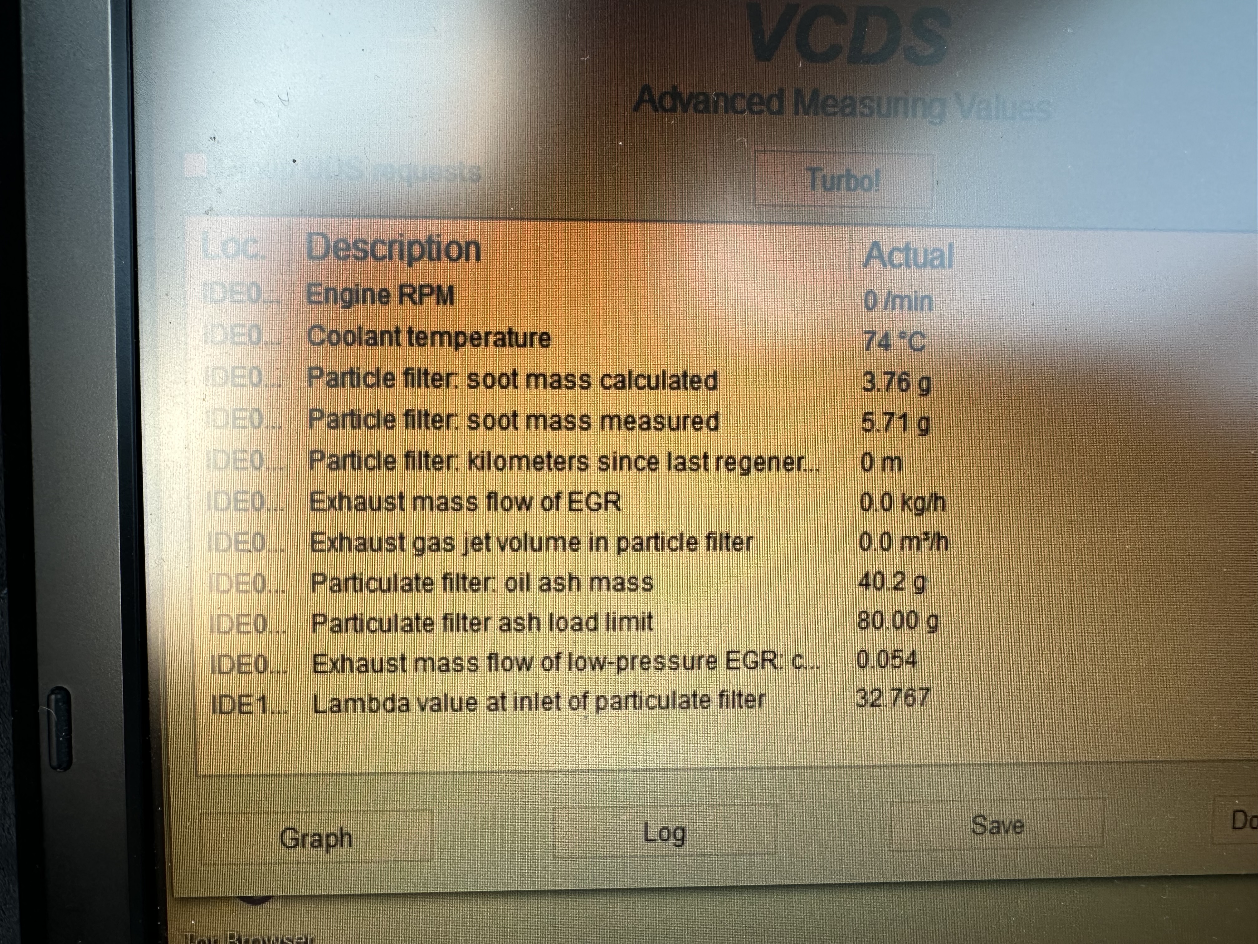

After a cleaned DPF soot measured still going faster than calculated
You need to check the live data values for the injectors, but I'm not sure about the turbo. Before going to a mechanic, inspect the engine for any leaks and periodically monitor the oil level to see if it's dropping, and in the worst case, if it's rising. Fuel quality is crucial, and I personally use Esso and Shell. About a year ago, I almost cleaned my injectors as suggested by the mechanic because my engine was very noisy. I used diesel from BP. However, after refueling from a different place, everything went back to normal
Mine regenerates after 110 miles (170 km) but most of my driving is in traffic. I never stopped the regenerating, maybe in emergency situations . It takes in my case 15 minutes and more if the car is not stationary.
There is always a small difference, sometimes of 7g or more in my case, I consider it normal. What was the oil ash mass before you clean the DPF? Or why did you clean it?

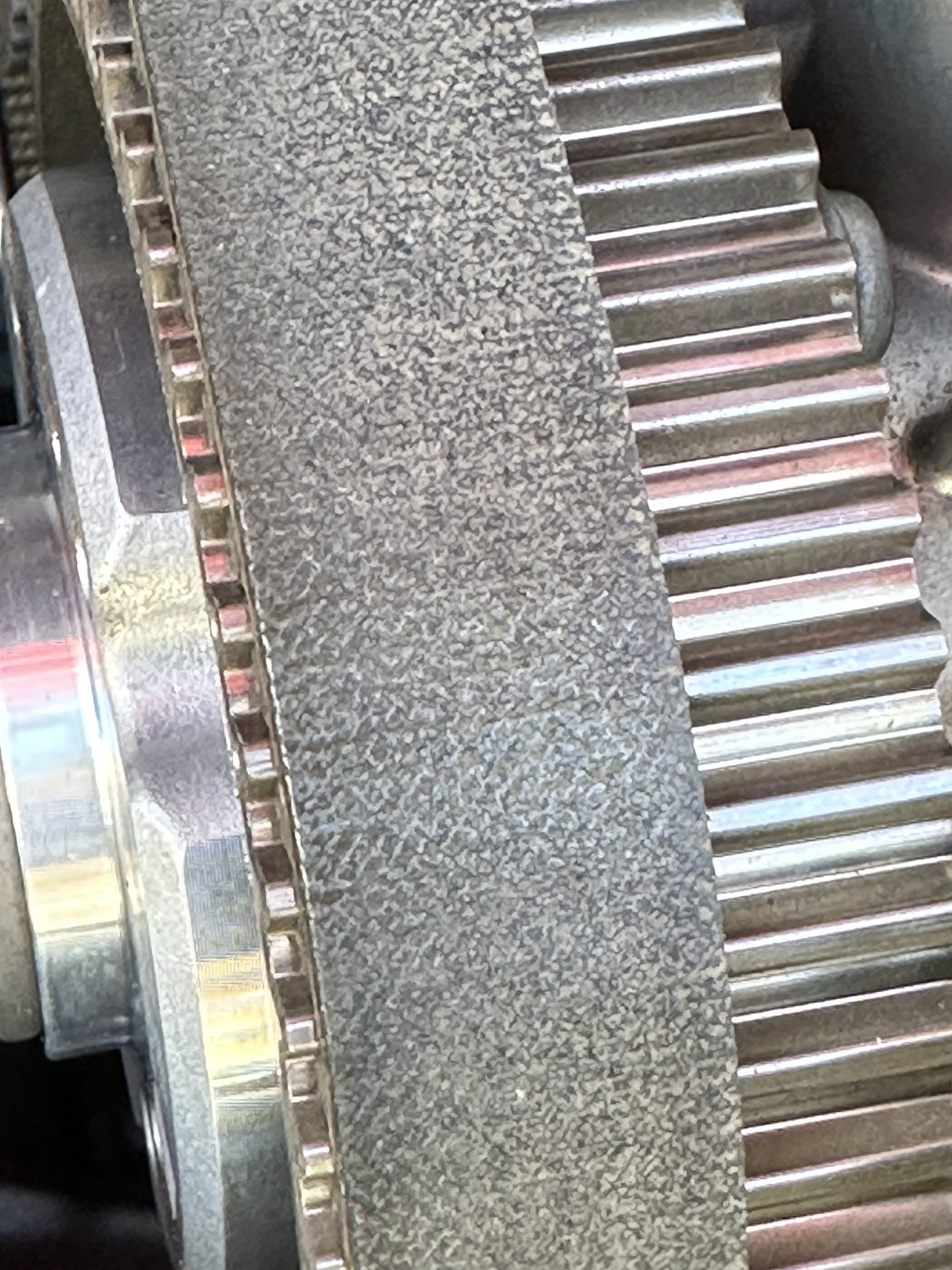

I need an opinion about the state of timing belt
77 000 miles on it, probably it is the original one so it should have 8 years and this is why I am worried. I am thinking to use it for another year until I’ll change it 🤔
I won’t give any details about age or mileage of the belt yet so it won’t influence your visual opinion about it, I will be grateful for any answers . So what do you think? It looks ok or not, I haven’t seen how different a new one looks like
