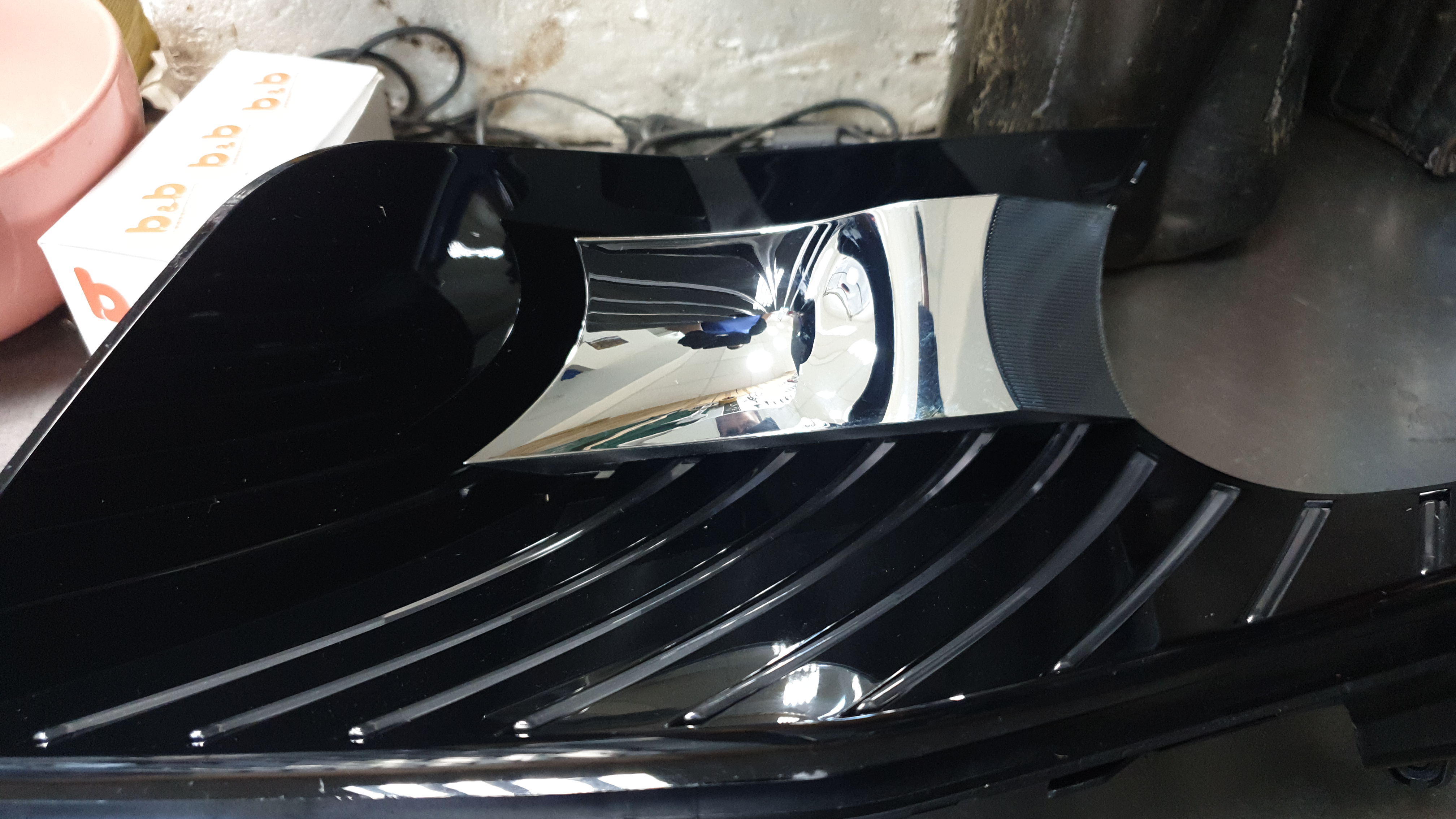

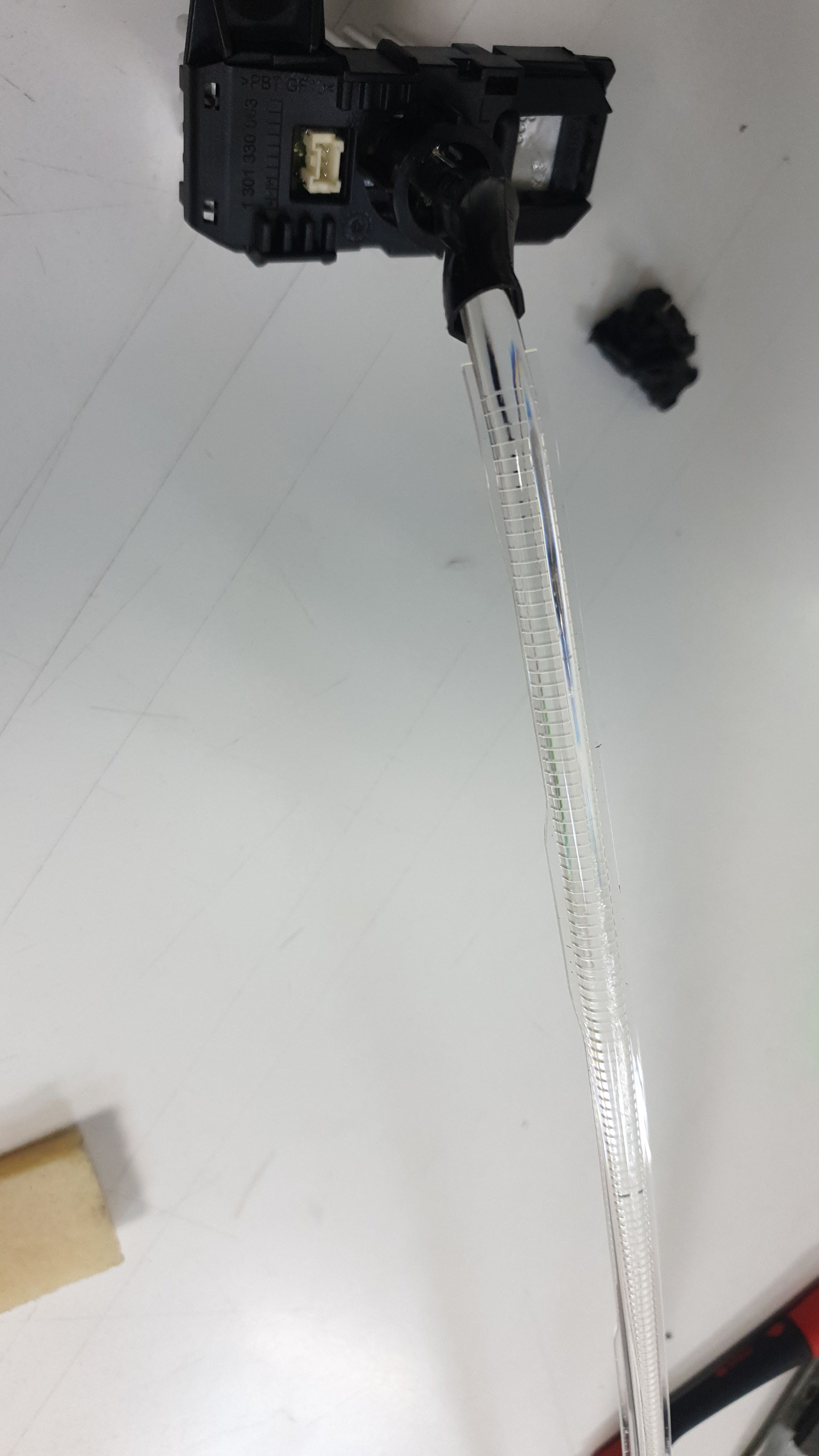

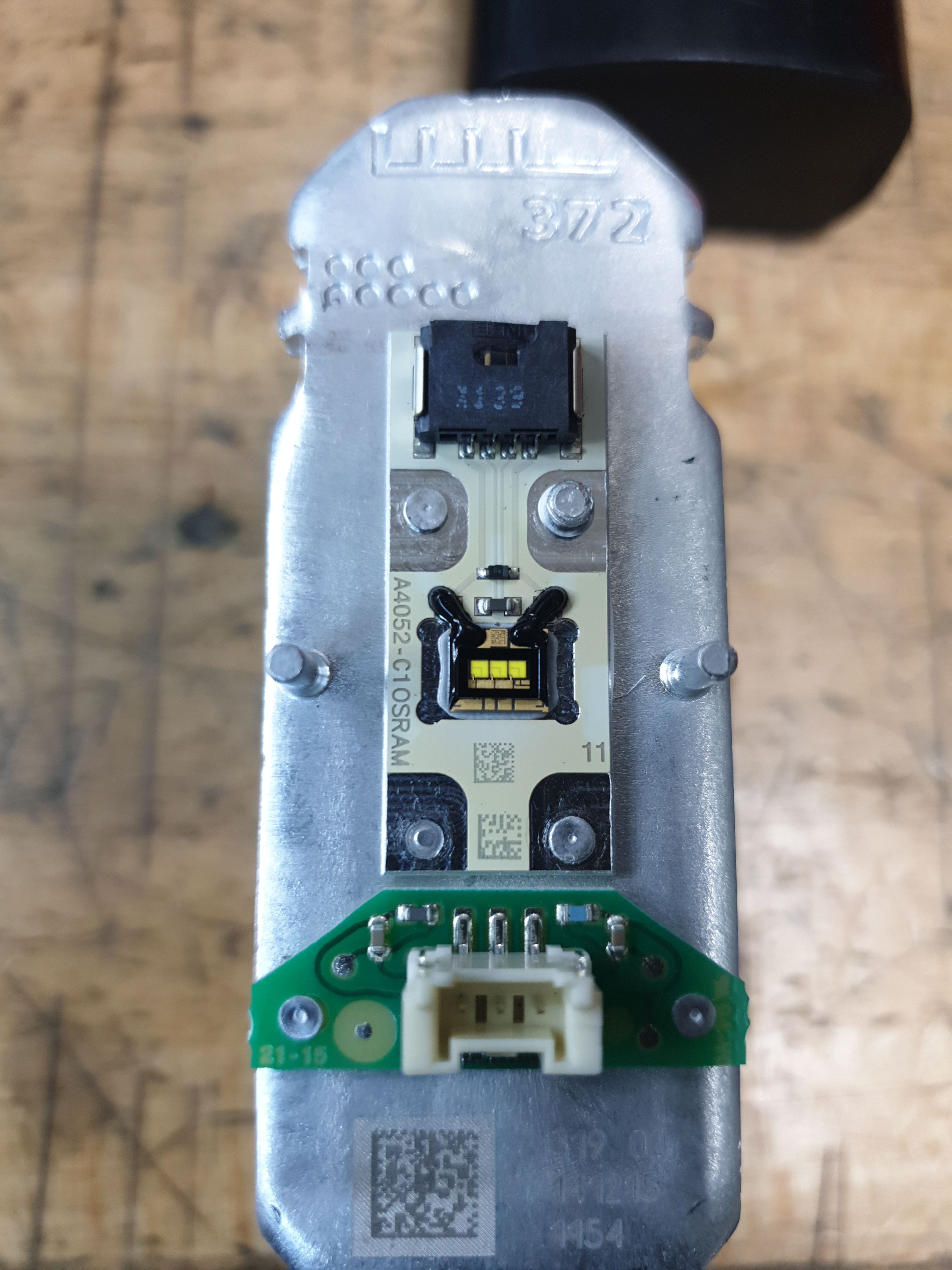

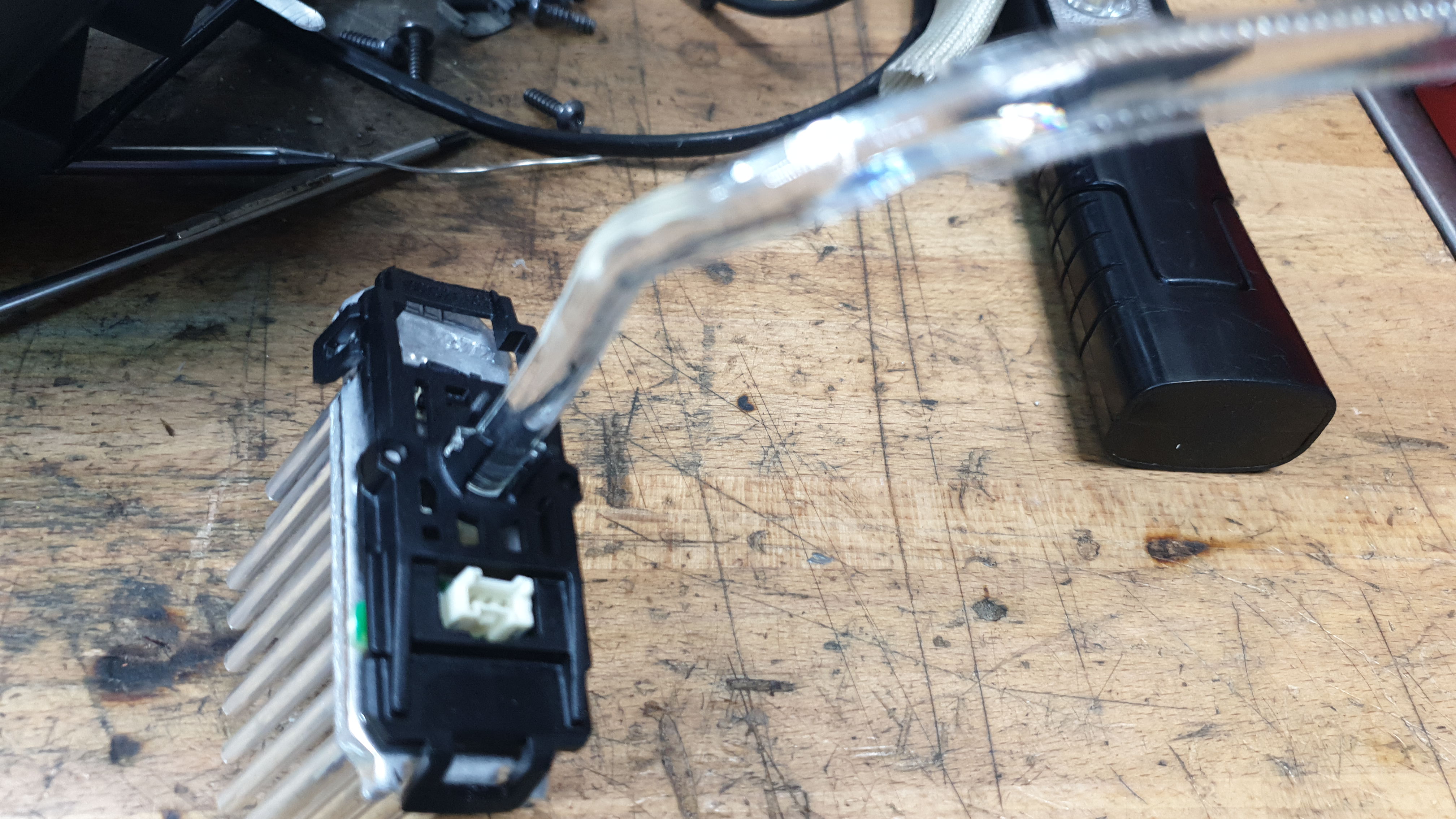

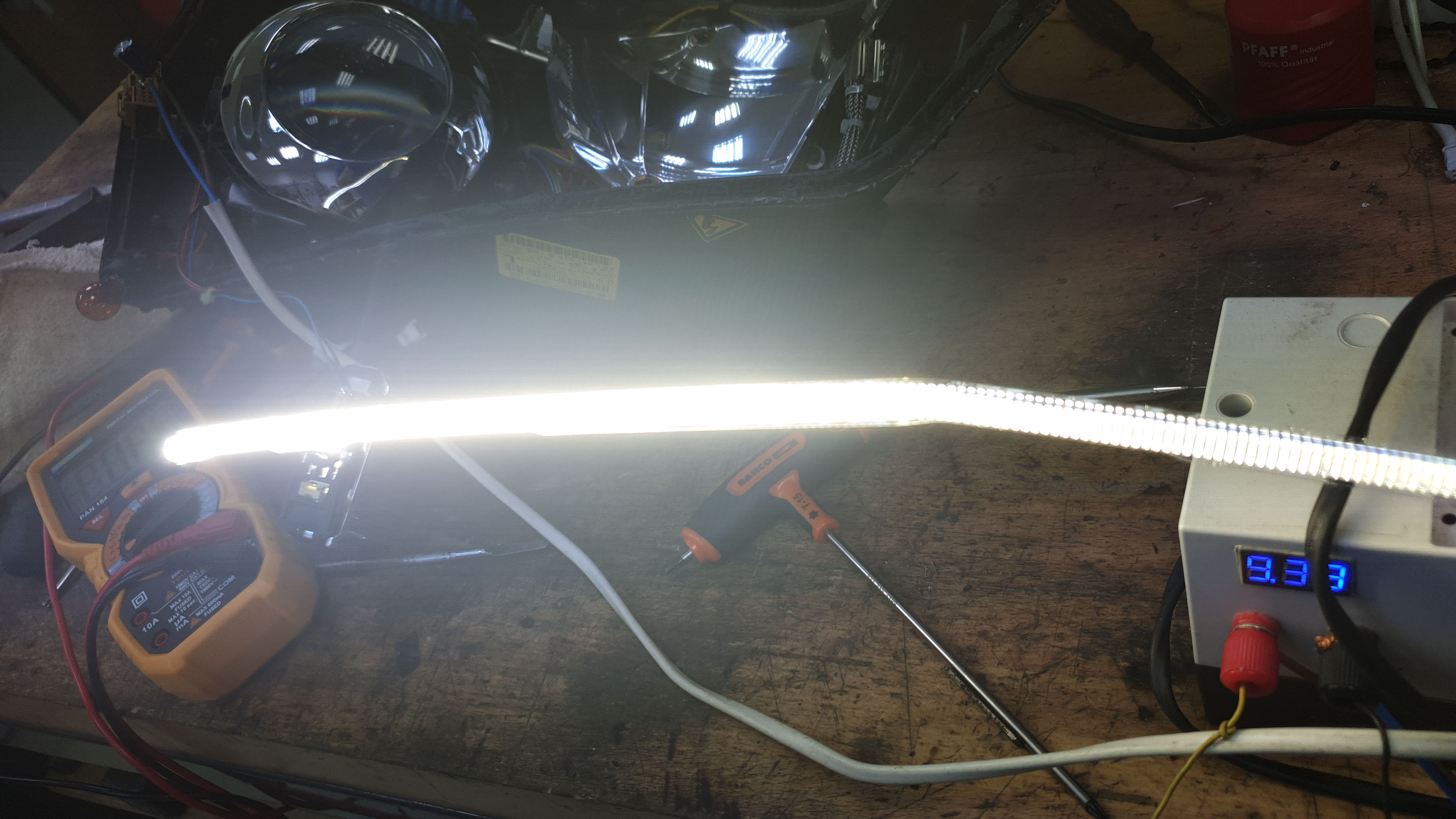

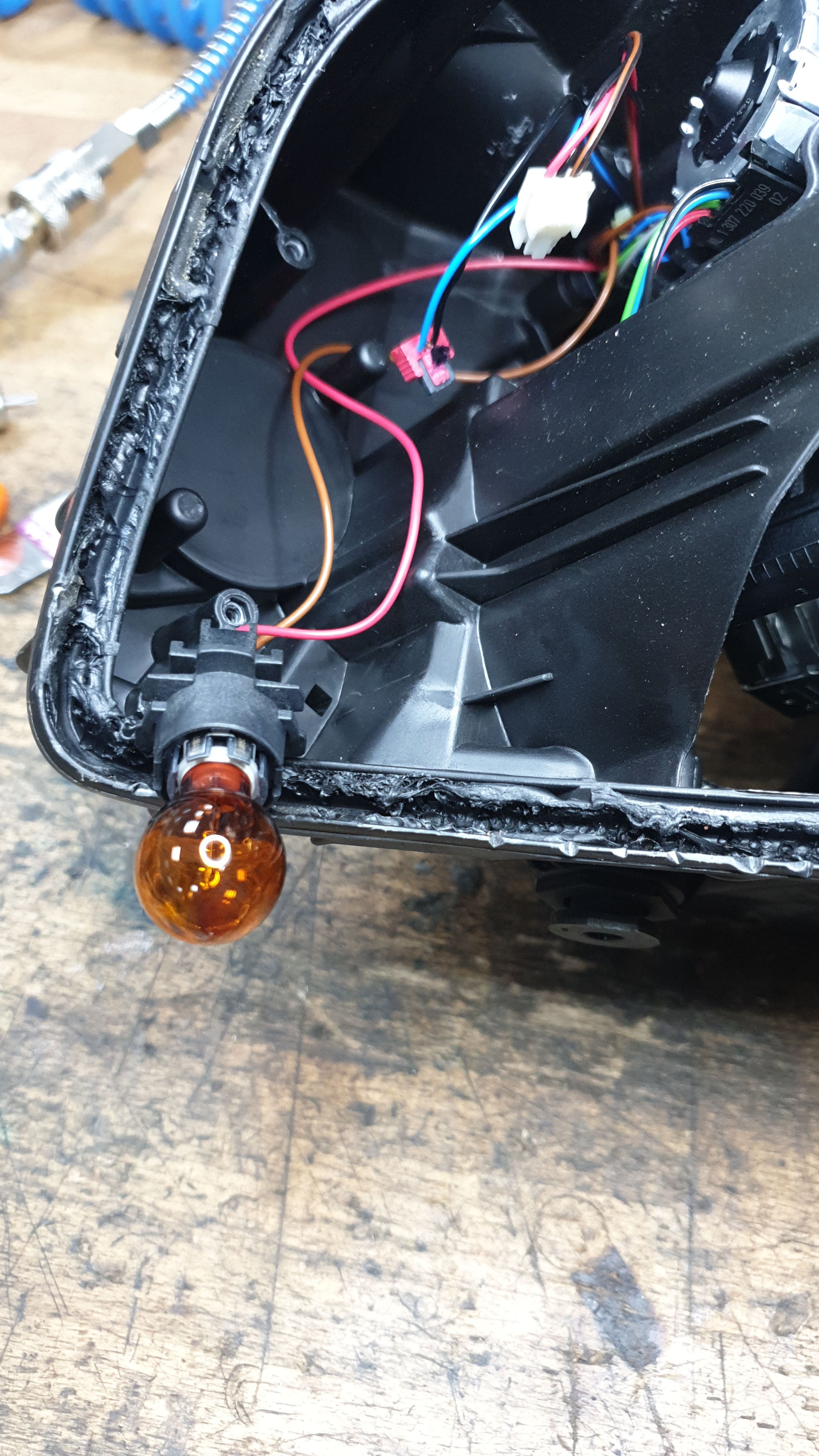

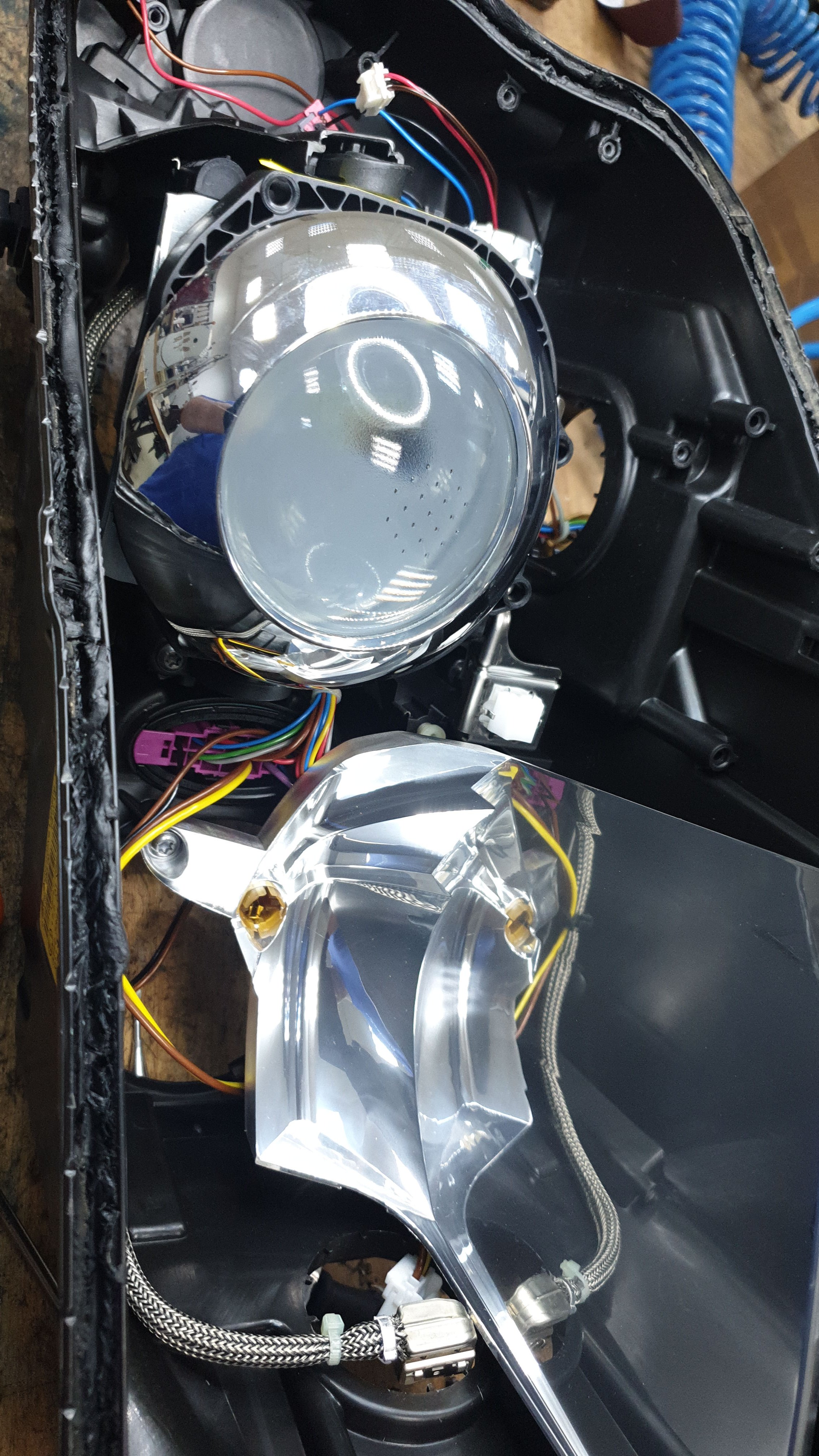

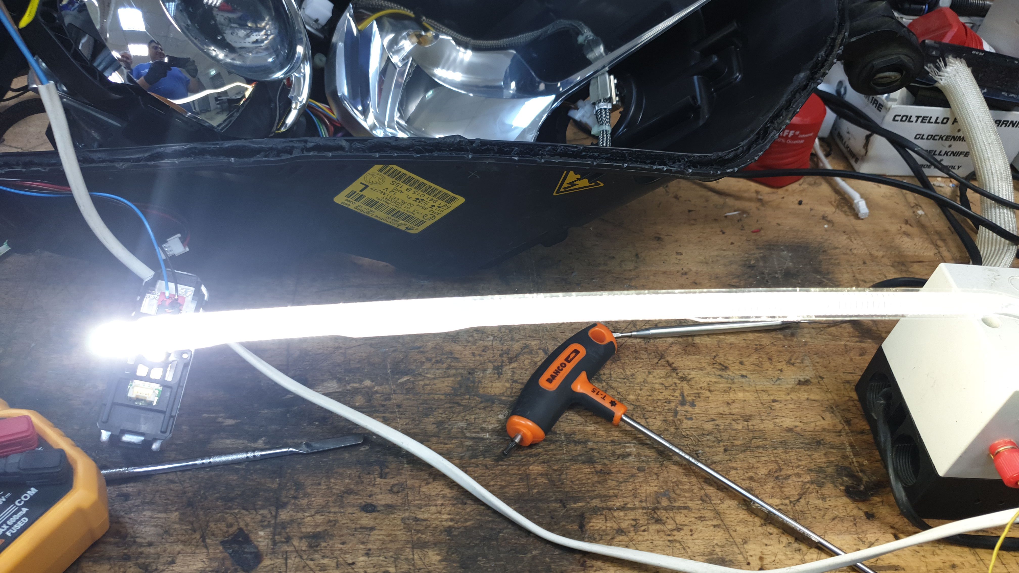

  2. Hello. For the DRL LED "stripes" located inside of the headlight with bixenon, afs, it's a big problem because ,if you see in pictures, it's not a led stripes, it's a Osram modul with 3 Cree led's, it's very, very hard to find to buy, i don't find him, and for the change him, you need the open the headlight's, i talk about glass, and dismount almost all components inside him...for that,in case of led burning, not computer drl issue, it's recomandet to change the entire headlights...of course, if you are a good tehnician, can you repair him , if you have the Osram cree led modul...see the pictures....
