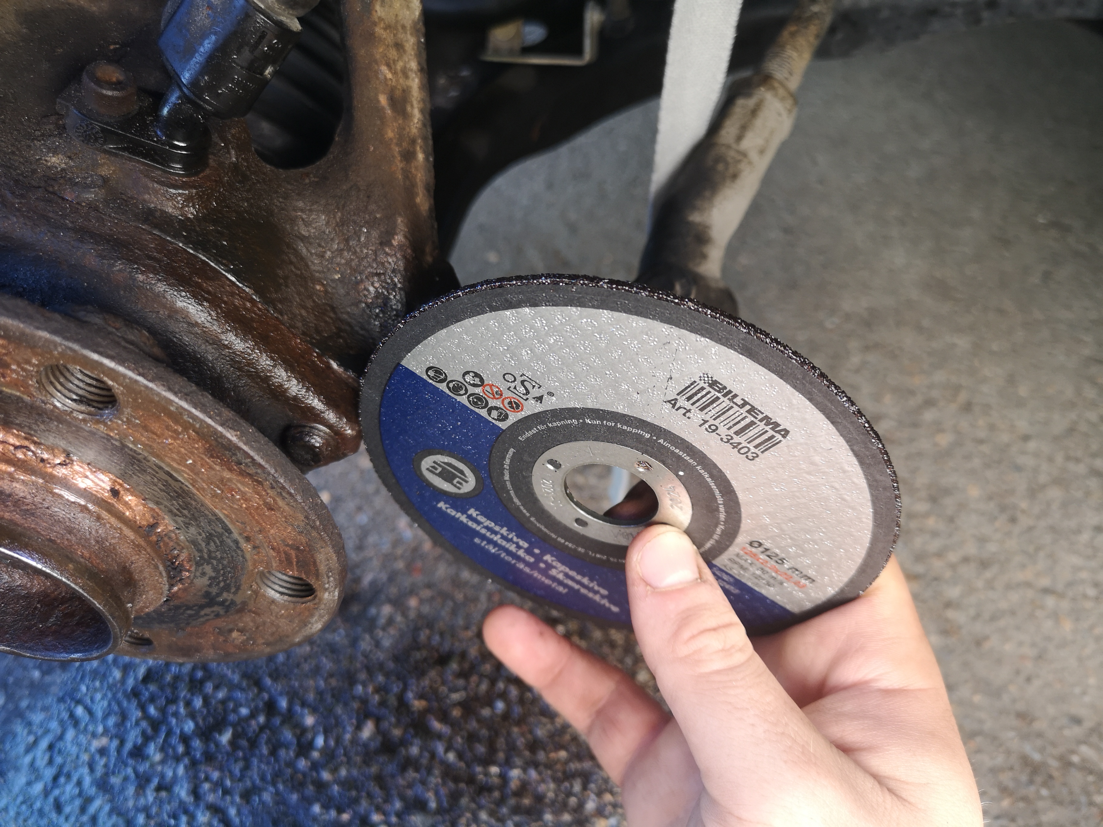

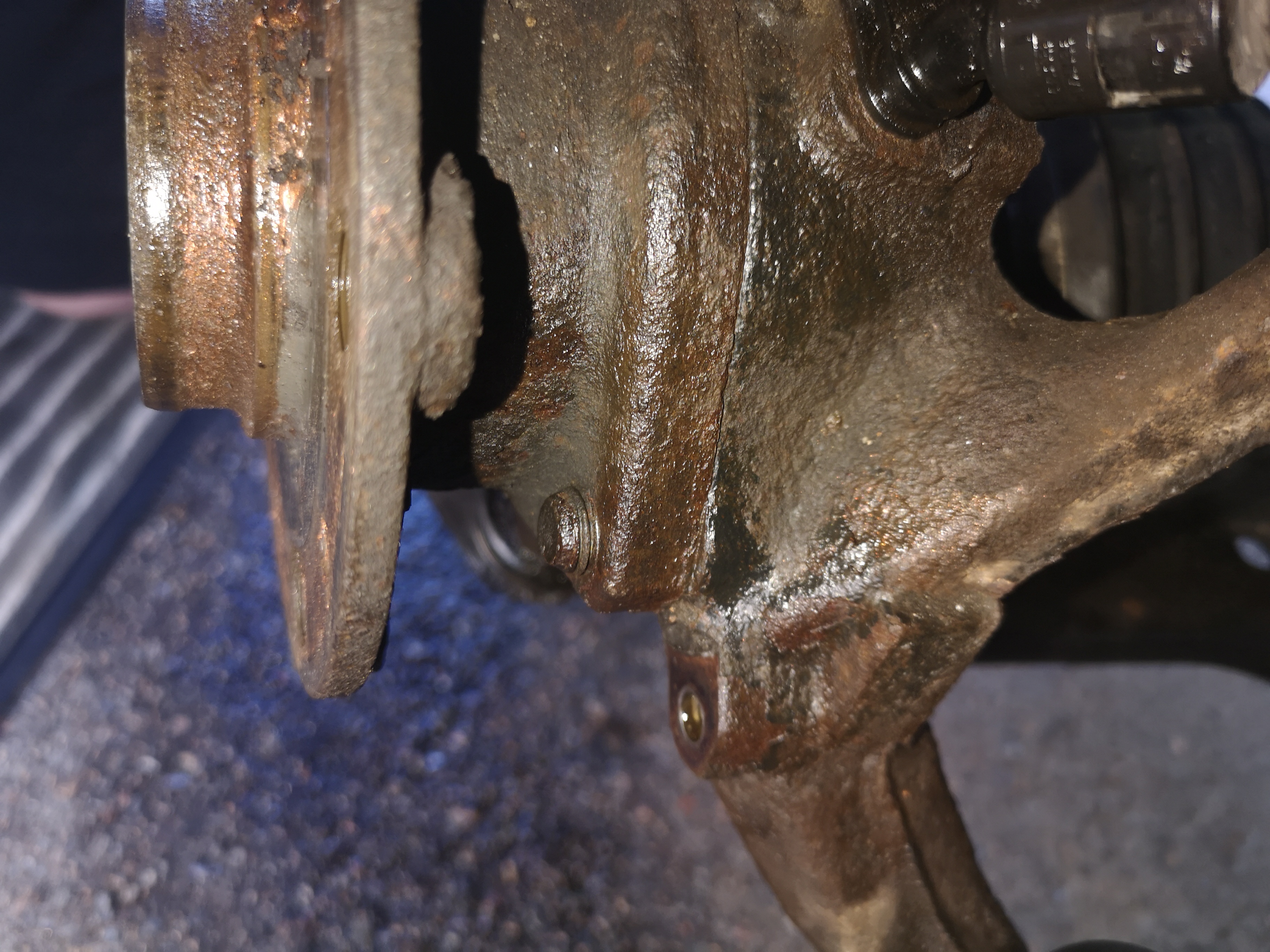

  1. Thanks all for feedbacks il will try again tomorow if i cant undo it then i think il go for the cutting , il keep you all updated whit more pics to come =) , one qustion if i chose to cut , would the fastner still be stuck ? after i cut in the bearing hub ?

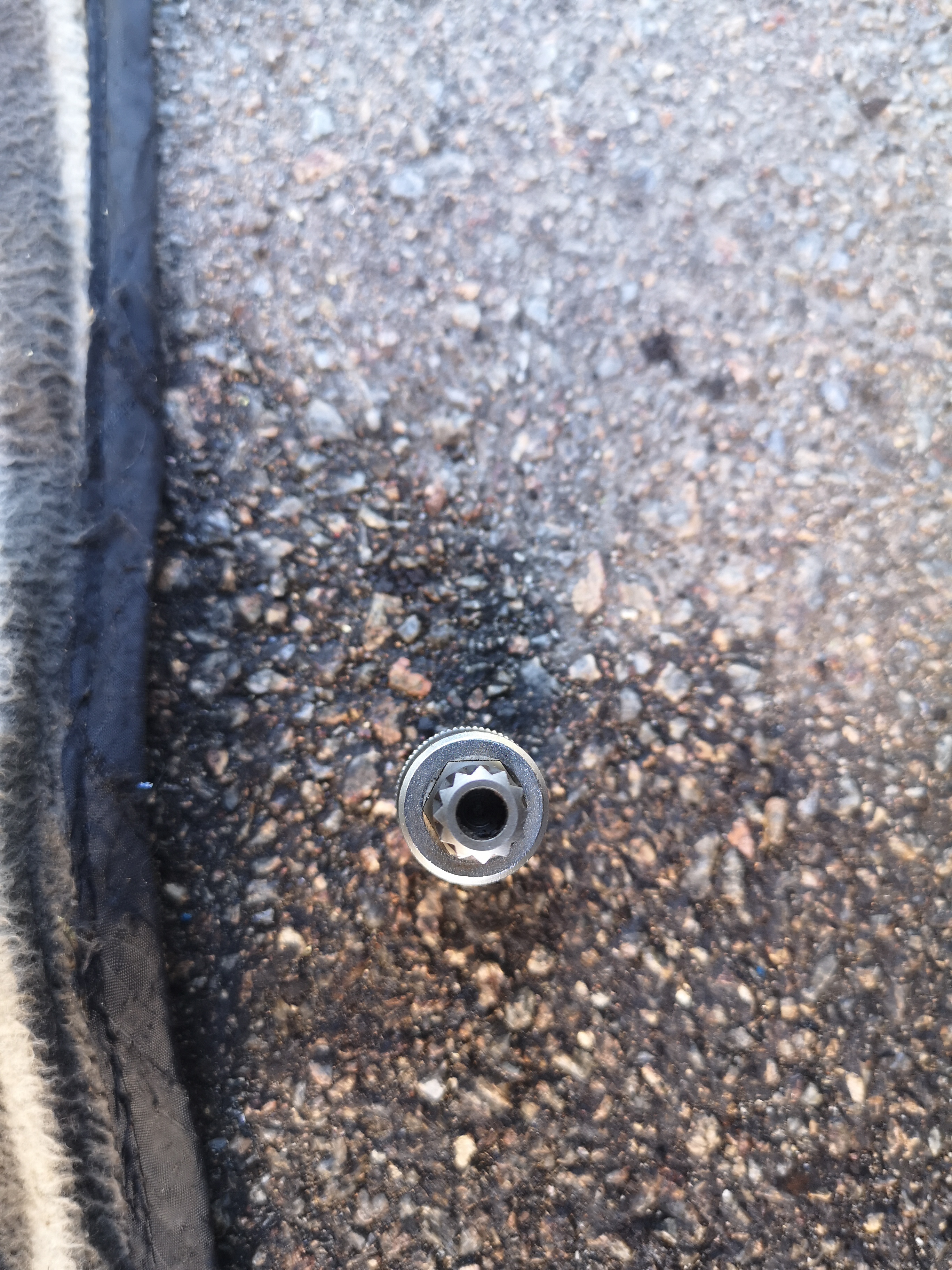

  2. its ok m8, its just this fastner is driving me crazy !!!! i manage to change 3 wheel bearing hubs and got stuck on this ONE screw that wont just come out !!!! and its head is all rounded :( cant get a grip

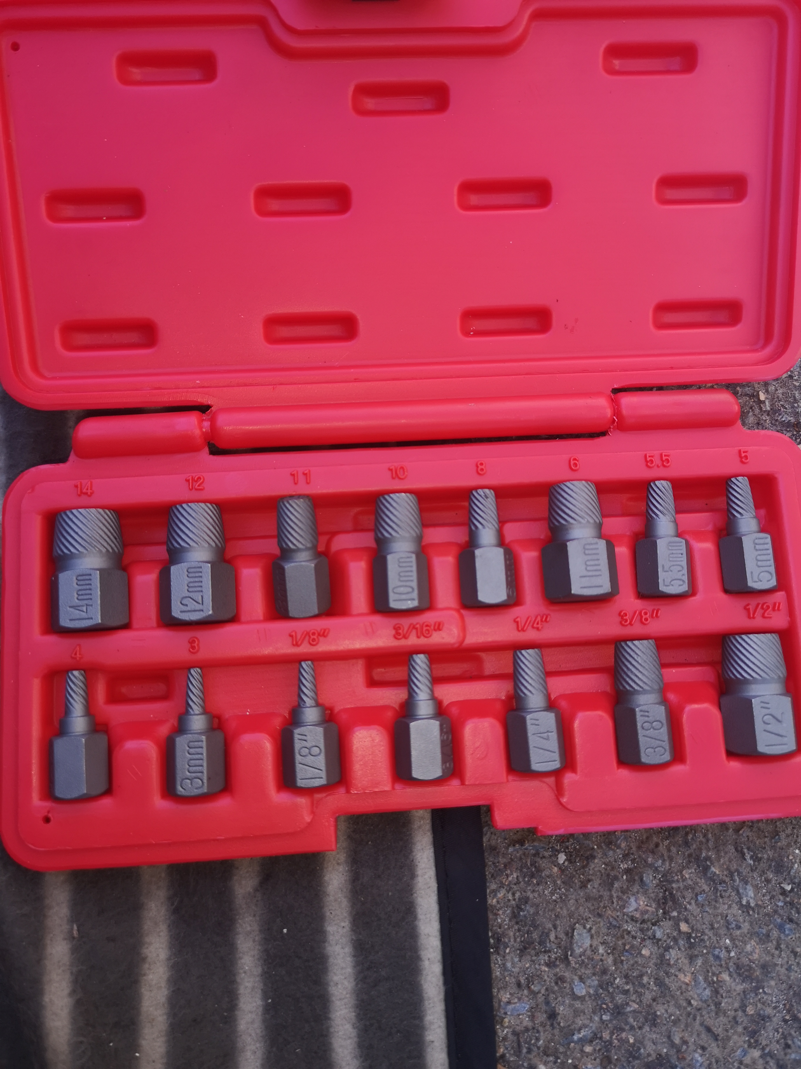

  3. Got these but not sure if i should use them or how

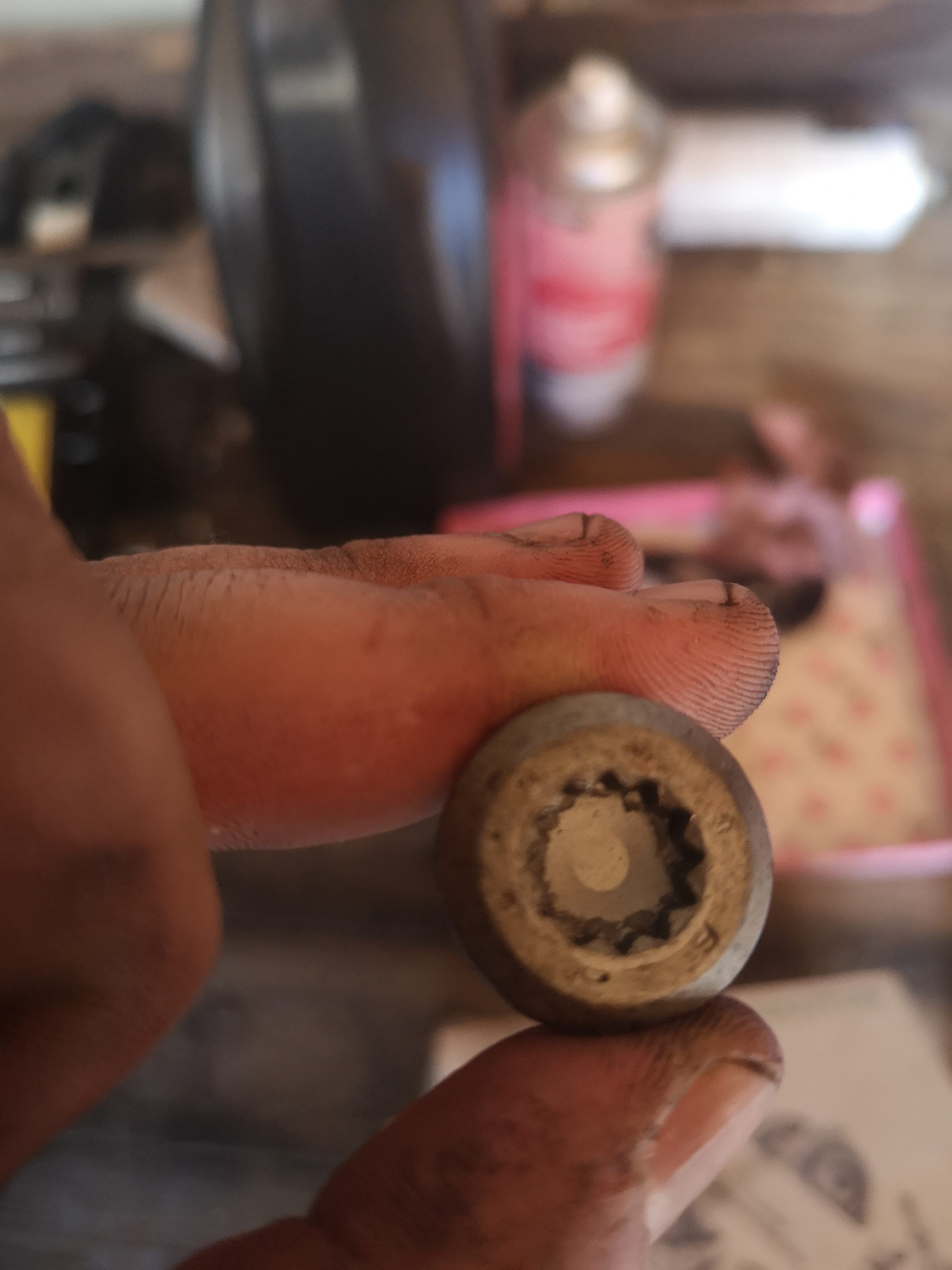

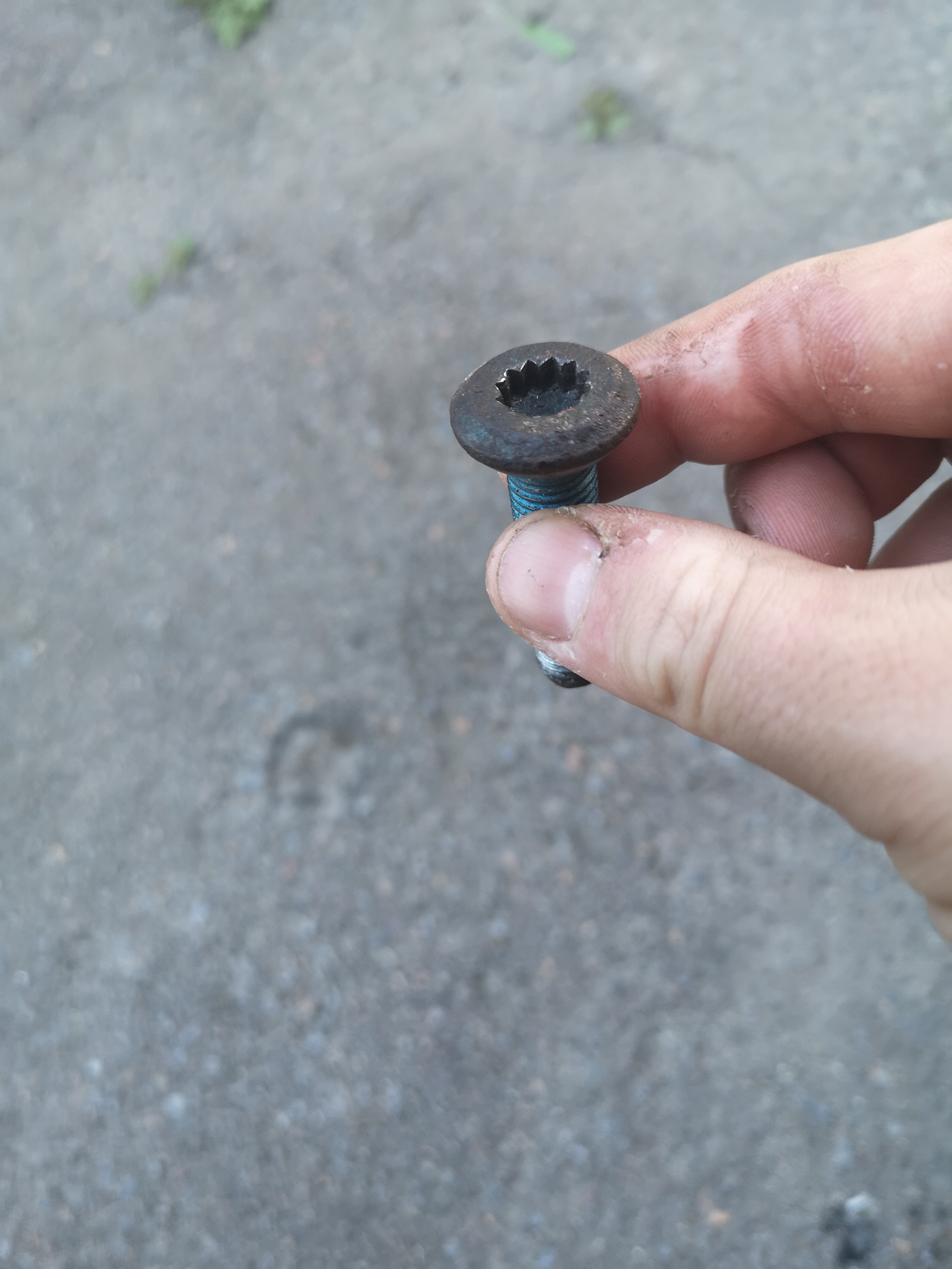

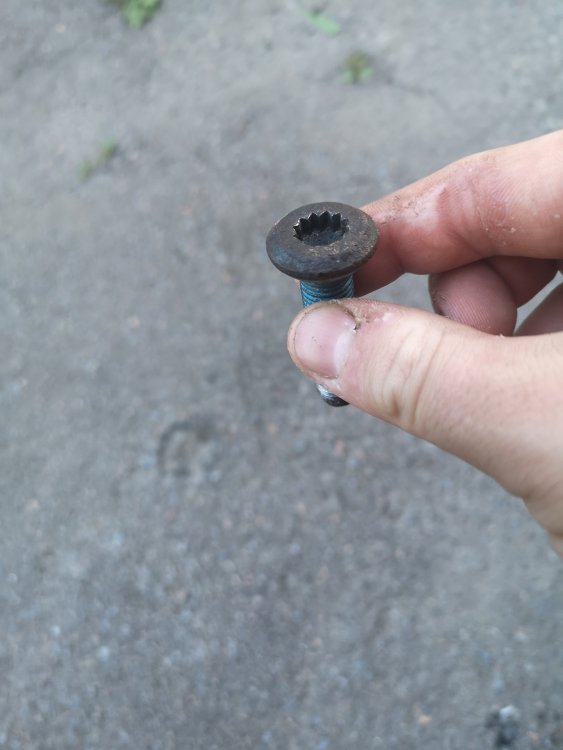

  4. Thats the ruined bolt :(
  5. sounds like a solution for me , could you please exsplain more , where did you start to cut ? at the end of the bolt ?

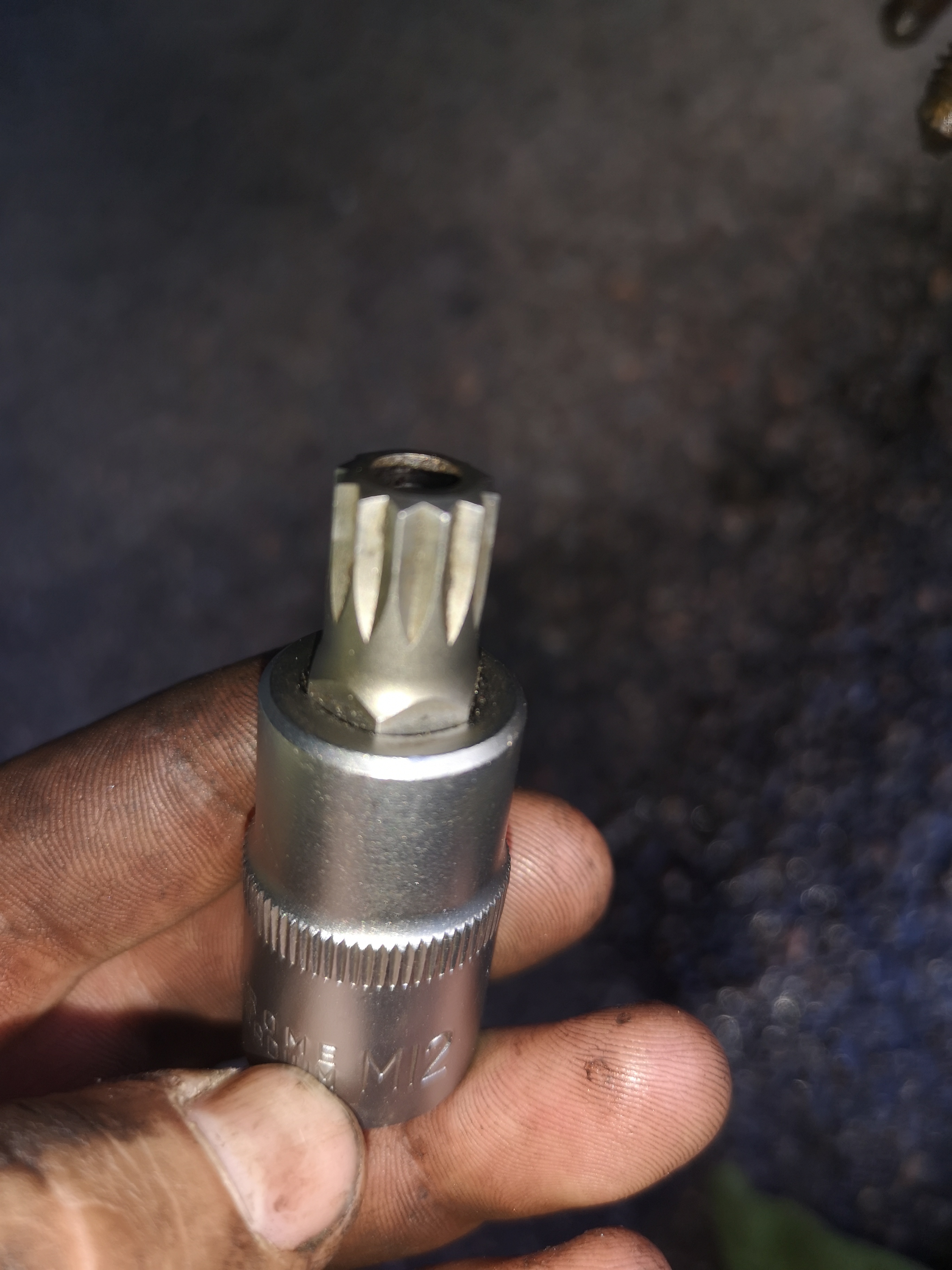

  6. Was using 3 spline one

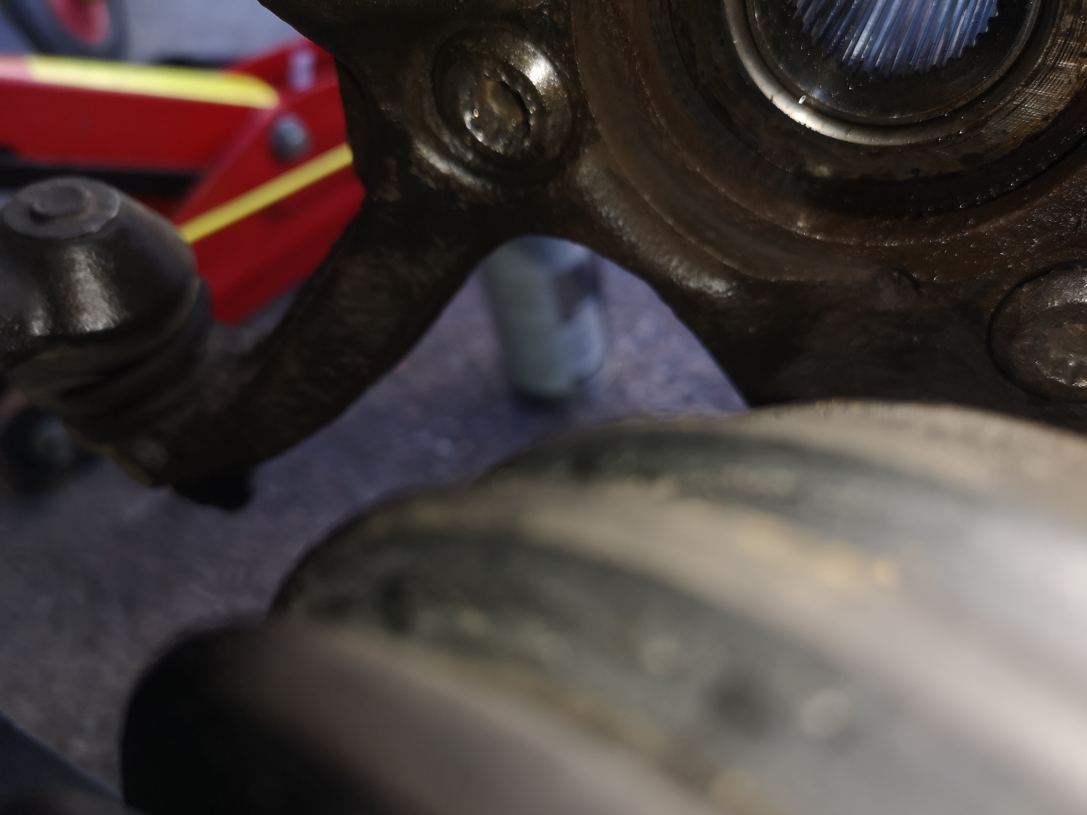

  7. All help is appriciated. Got one of these bolts real stuck on my wheel bearing hub and its head is all ruined cant seem to get a grip.

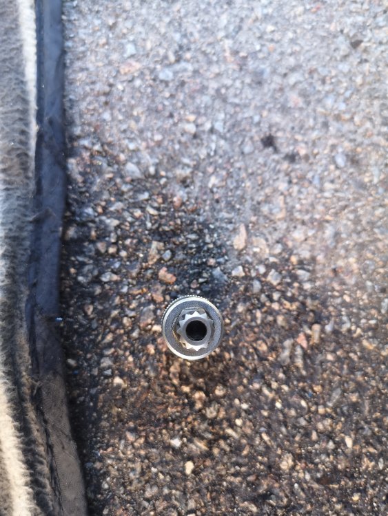

  8. Hi all. this m spline bolt is all gone wrong. Head is ruined cant seem to get good hold to get IT to move. Its stuck. Do anyone have any ides on how to exstract these m spline bolts that hold the wheel bearing hub?
  9. Bolt exstractor 22mm did the jobb. Good investment.
  10. Will ann bolt exstractors work on this kind of bolt?
  11. This is my case here csnt get this bolt to swing. Using an 12 point socket but IT Just keep slipping out :( any ides anyone how to get this bolt out?
