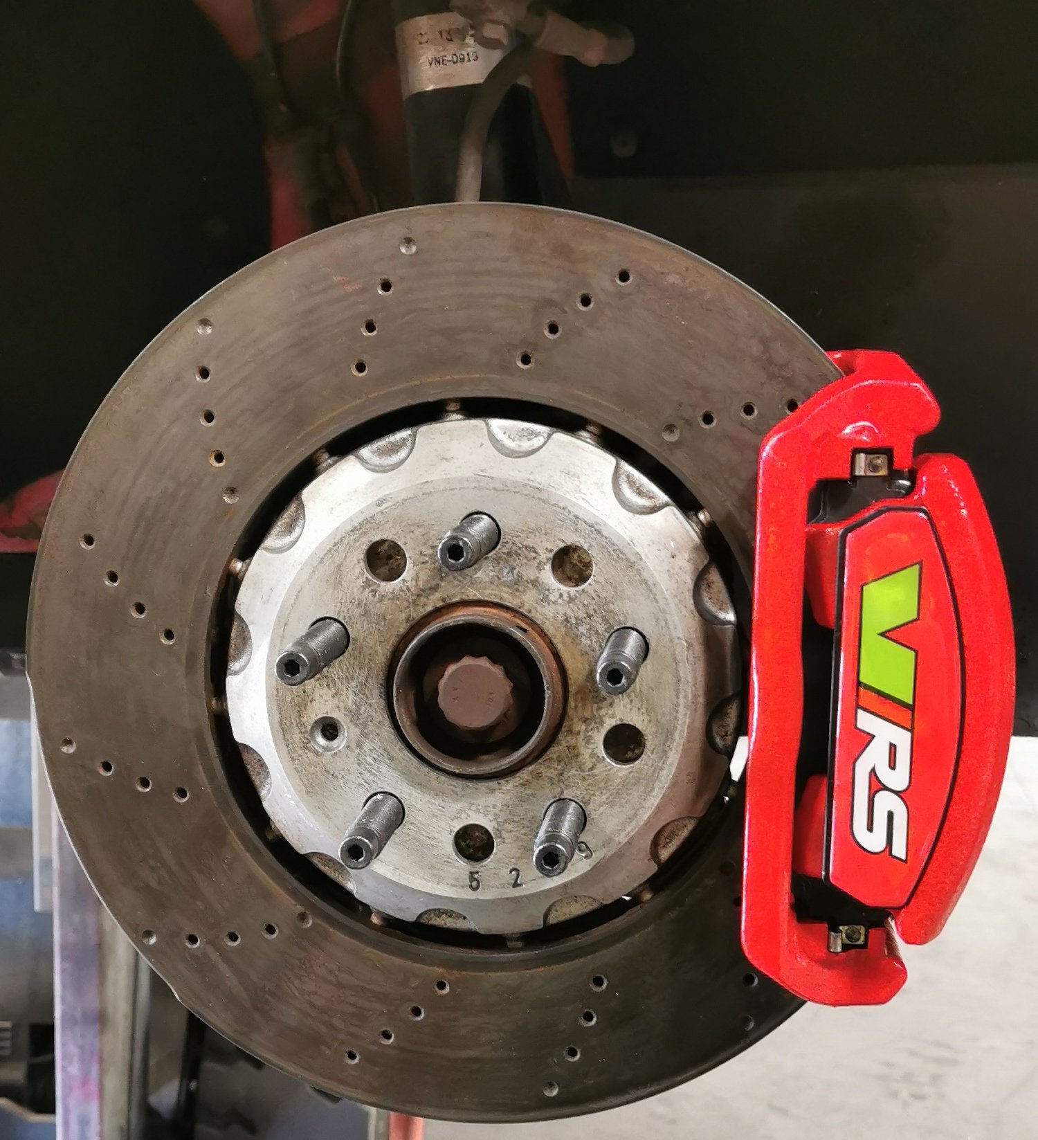

  5. Got Golf R clubsport brakes on mine.... Work very very well and all directly bolt straight on, loads of room behind 18's.
