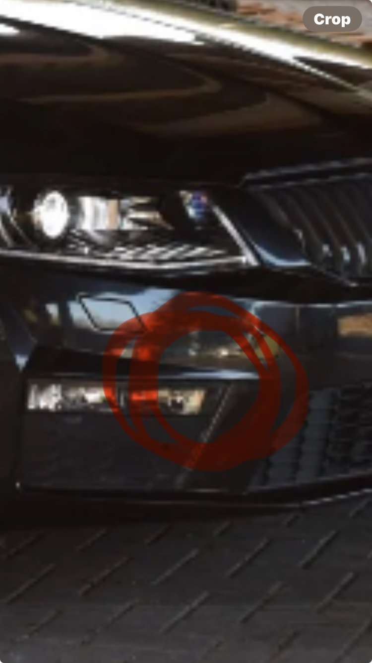

What bulb is this please?
Hi there,not with the car atm,need to order pre mot,from the outside it looks like a fog light but could be a side light ? it’s a 2014 vrs estate thank you

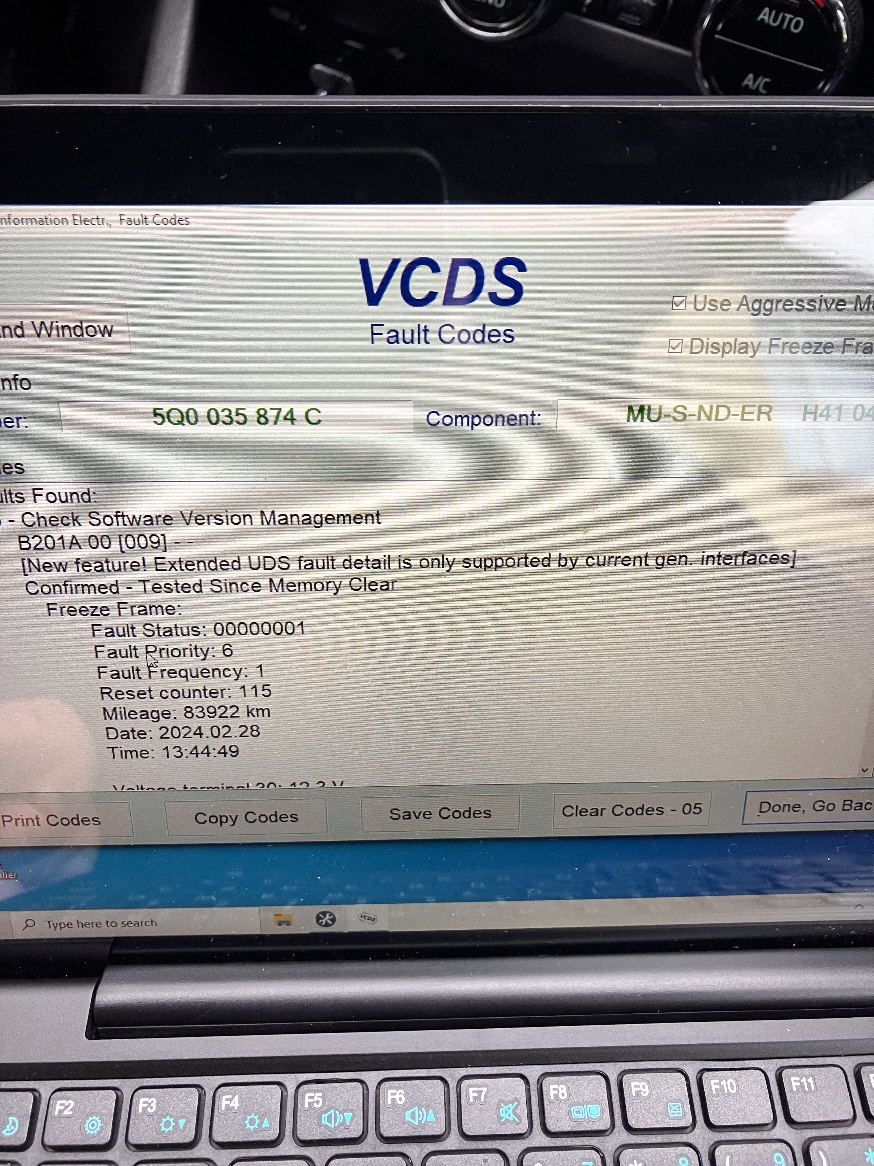

Tpms no option to “set” on infotainment
Note to self * DO NOT LEAVE MY GENUINE HEXv2 vcds in my Audi TT in Uk. Here in Ireland with my MQB vrs Skoda estate,the borrowed Chinese clone ****e will spit it out. TPMS code cleared with Snap On at a local mechanics for €40. This will accept and update the genuine article only.Heres what shows on Chinese crap and cannot be corrected.Also the “Set “ function will not show on the touchscreen,I presume until a full Autoscan and clear all fault codes has been accomplished,which it won’t with a knock off. Thank you to everyone for all of your help in following this problem
