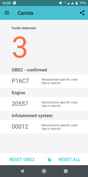

  4. I plugged my Carista OBD2 Bluetooth Adaptor into Zebedee for the first time today, mainly to check if it was still showing fault code P16C700, which is what the VAG Roadside Assistance man found about ten days ago when my emission control system warning light came on and stayed on (it's since turned off 😣). The good news (FSVO "good") is that it's still showing the code (or at least the short form of it), despite the warning light having gone off. It's good news as it's booked into Inverness Skoda on Wednesday for a warranty repair and they'd said if they couldn't see the code using their diagnostics now that the dash light was out they wouldn't be able to replace the support heater pump (which code P16C700 was telling them is intermittent) under warranty. However as you can see it's also showing two other fault codes: 20557 on the engine and 00012 on the infotainment system. My Google Foo is weak and I can't find any identification for 20557 or 00012 ... so I thought I'd ask here if anyone could help me identify what they mean. TIA.
