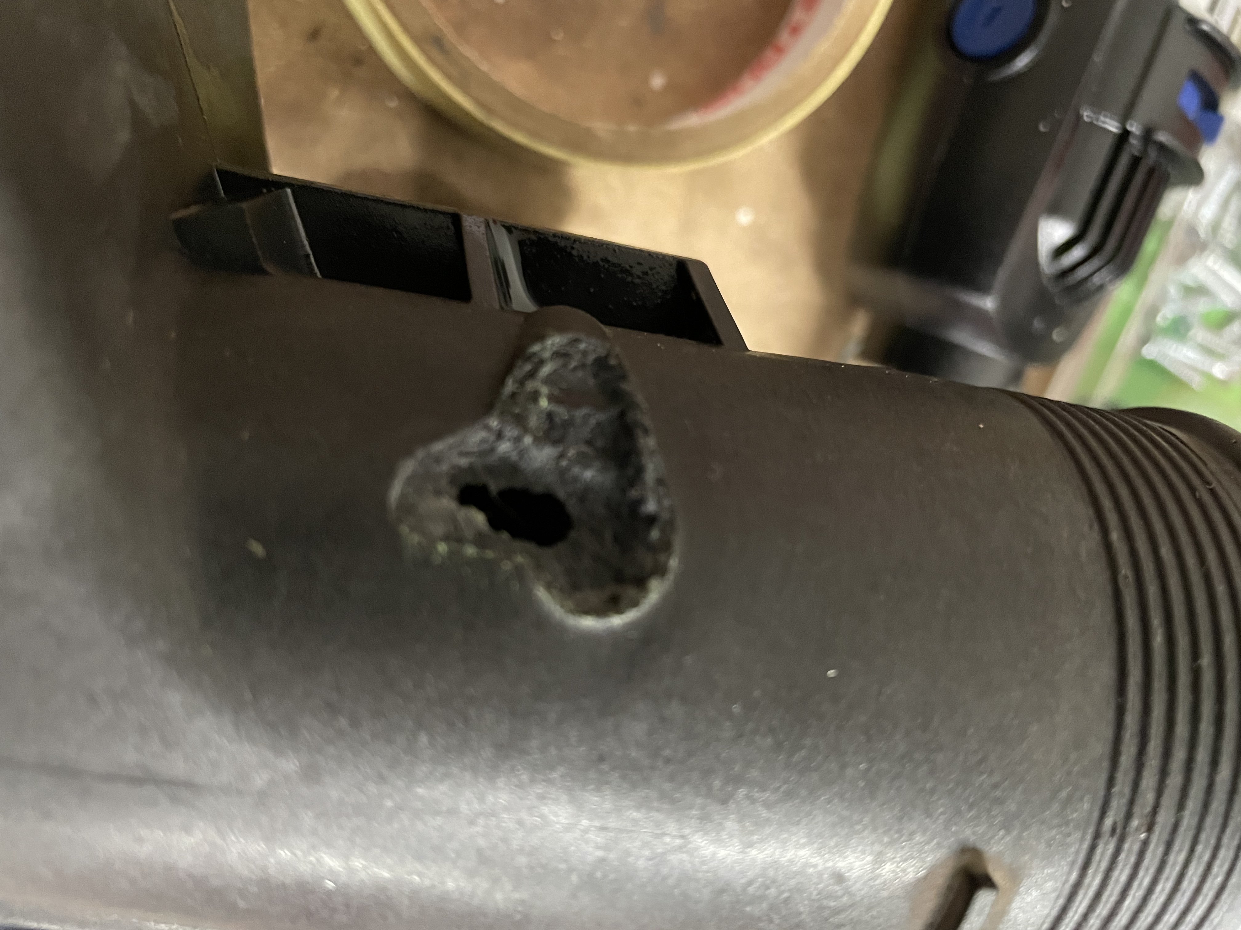

  5. Thanks for all the suggestions everyone. I found the culprit! After a hard hit (partner hitting a speed bump hard) on of the plastic tabs broke off the intercooler and out a small hole in the plastic pipe. Hopefully I’ll be able to repair it with some plastic weld
  6. Thanks mate. I think I’ll try and get the front bumper off to assess any damage around the intercooler. From the cabin, if definitely sounds like the whooshing sounds is coming from the left hand side of the car, near the firewall, but I’m also aware how the engine space can direct noise around and can confuse
  7. Ok thanks! I’ll keep looking! I just had the entire air box out and couldn’t see anything odd, and that gave me a good view of other pipes , all look fine. Hmmm
  8. I’d love to have a really good look at the intercooler but it’s behind so much stuff!!!
  9. Yeah standard. Not blow off like a regular BOV but when u hear the pressure bleed off after lifting off throttle. It’s really weird, performance is kinda fine, no engine lights or anything bad, just increased air rushing noise. It started yesterday after my partner apparently hit a speed bump really hard and damaged the bash plate underneath, but there doesn’t seem to be anything else damaged or missing etc.
