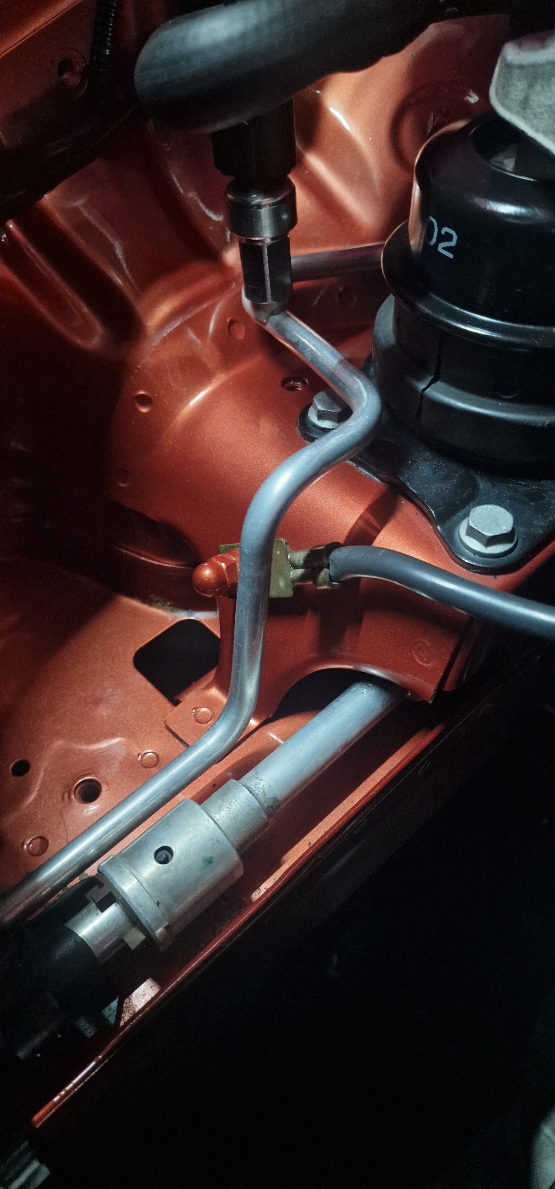

Hi, i found some oil under the preasure sensor, changed the sensor and the o ring but no succes still find some oil, what could it be?
  • Sponsor
Dunno, maybe the weld has cracked between pipe and sensor fitting?
