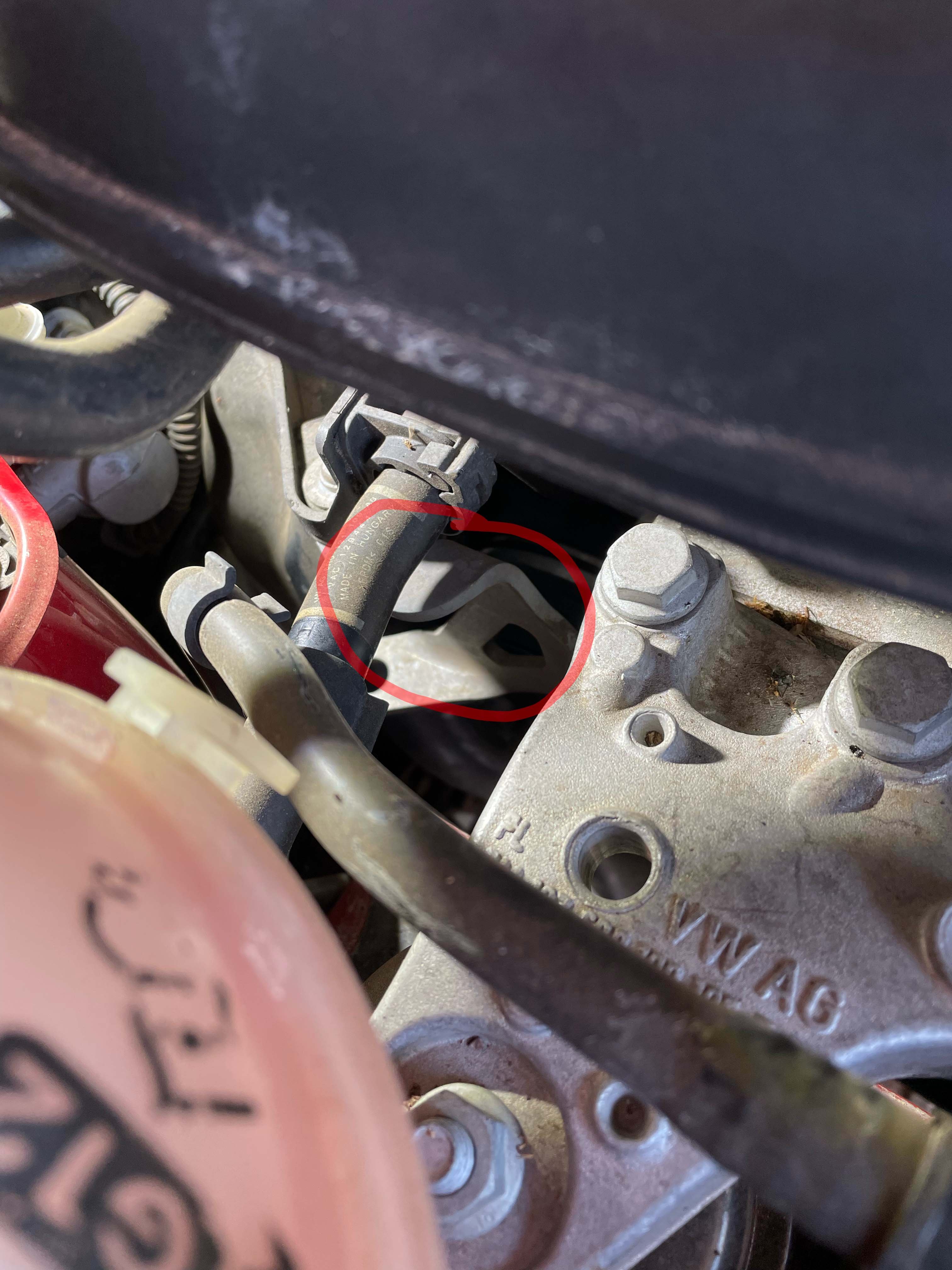

Hey guys,

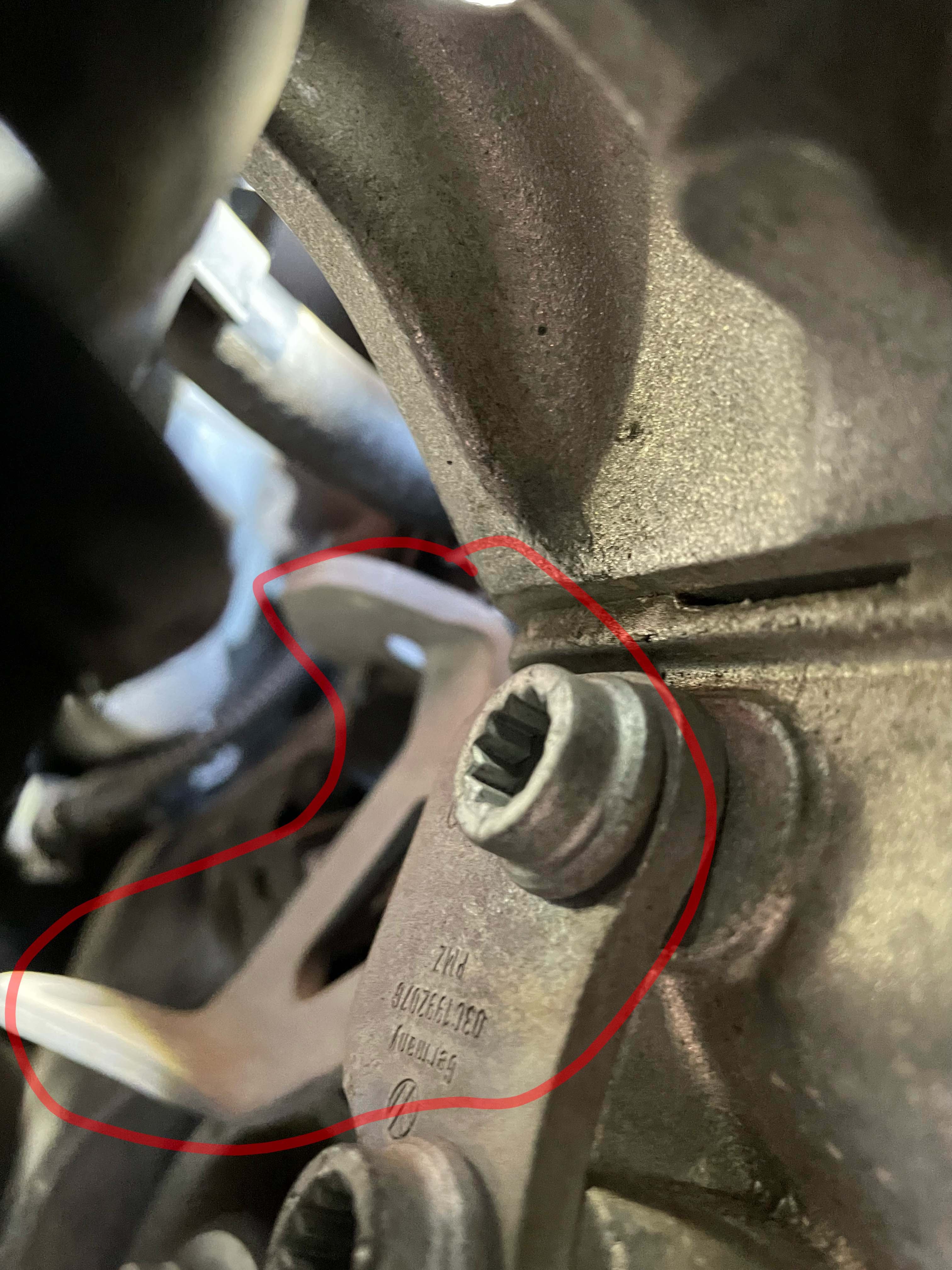

So im trying to replace my serpentine belt (alternator belt, whatever its called), and I cannot get it out, the very top pully near the supercharger belt has a metal bracket that is in the way, like its right up close to the pully and the belt cannot be removed from it. I have attached pictures, and I cannot find any other topics about getting this belt off!
Thanks,
Nic

Thats just a mounting bracket, pops off by undoing those 2 spline bolts.  If you detention the top tensioner with a open ended spanner that belt should just pop straight off.

Ah thanks mate. I had another go today and managed to replace the belt no problem, just had to slip the belt through a narrow corridor between the bracket and the pulley. Those bolts holding the bracket are in a very tricky spot.
