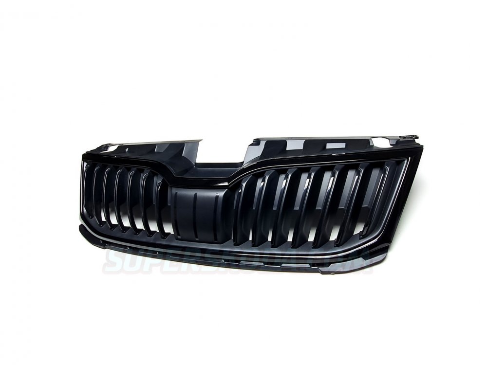

Grille mounted today. Took 1 hour and easy as FCK And the question about if its welded or not so NO its not on FACELIFT

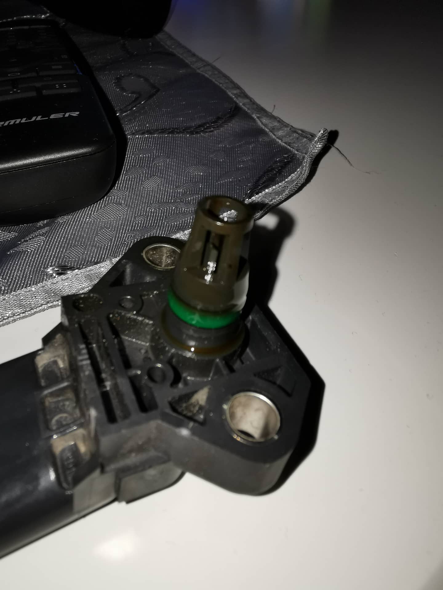

Update. After a while the code is back and pending but no check engine light on. I wonder if i replaced wrong sensor. What is this sensor for? OEM 05e 906 277a

There is alot of info but no photo of grille is welded or clipped in place . Removing bumper is not the problem for me, i just wondered if whole grill was welded in place on the bumper or not. I know that surrounding is clipped but not sure for the whole grill. But i found a vid on YT after my post so i got my answer. ITs not welded
Fit new grille without removing bumper
I will remove whole bumper and i did not order just surrounding i ordered whole new grille with surrounding on it. Its glossy black
Front grill removal
Verry old post but i ordered new grille 2 with black surrounding and if you look at this video on Yt from Germany it seems that gill is clipped in place not welded in. My car is Octavia MK3 Facelift 2019 I kind a **** my pants when i heard that i need to weld it in
Found this video is on YT and it seems not welded he talk about clips look at the video and it is clips not welded https://www.youtube.com/watch?v=UKMdeGbR4KA&t=686s

Hi I just ordered new grille black glossy with black glossy surrounding so complete grill. Do i need to remove whole bumper ro take off whole grille or can i do some other way? How is whole grille fitted on the bumper? Screws? Clips? My car is Octavia MK3 Facelift 2019

Ok i replaced the sensor this morning and before i replaced sensor every time the car was coldstarted rev goes up and down before car is warmed up then after 1 min it goes down to normal. Now when i start the car with the new sensor the rev counter did not do that anymore it is stable.

Sensor is replaced now. The seal was little bit worn out.
