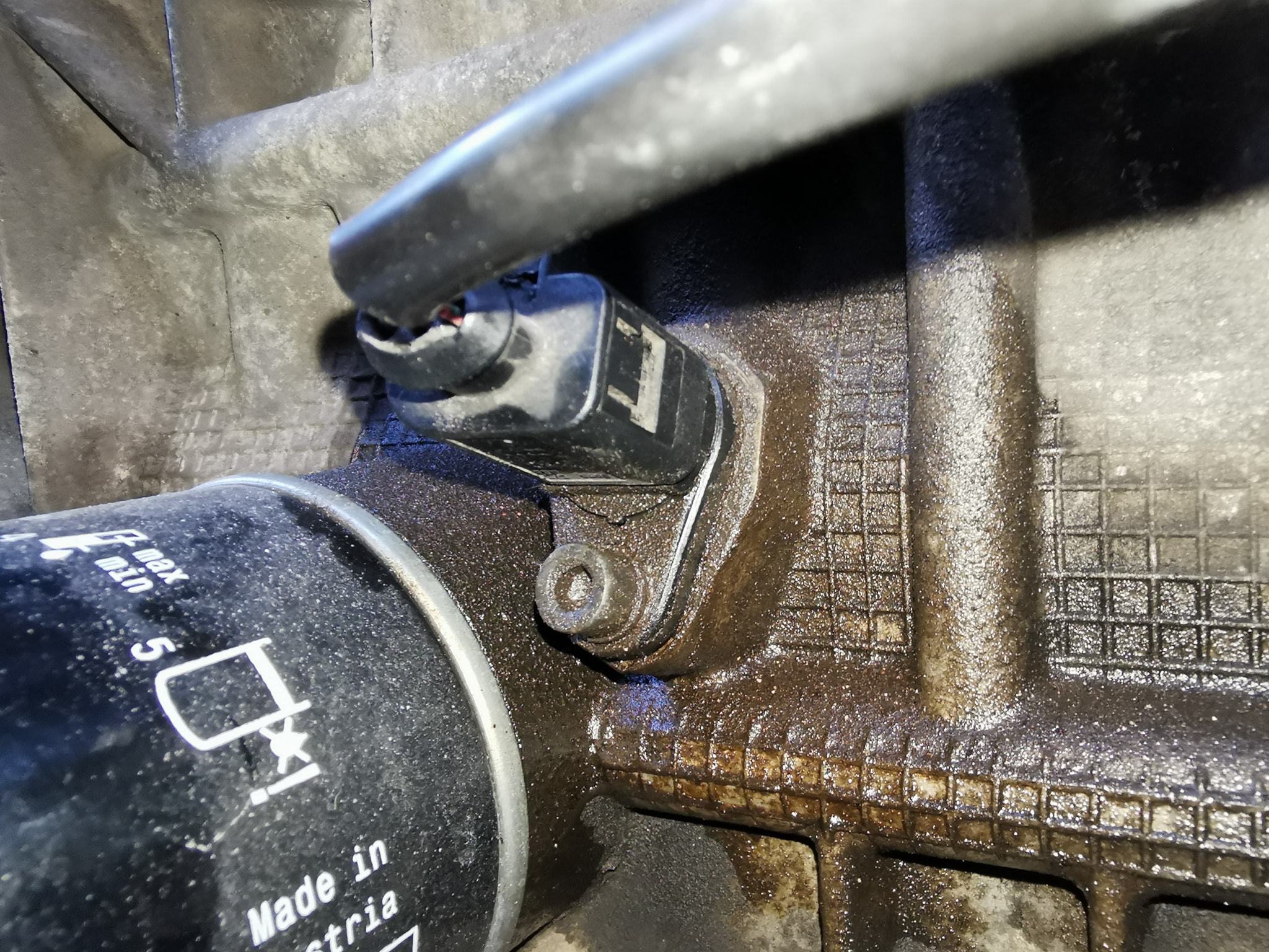

This sensor is leaking and i think its some kind of camshaft sensor but i cant find it online to buy new one. What is the original oem number for this one? Where can i find original oem numbers online?
My car is Fabia 2001 1.4 Mpi 8v
It looks like an oil pressure sensor.

Cam sensor; too many wires for an oil pressure switch.

Thanks mate. Im confused and dont know what to order because its called many names here in Sweden so im confused.

Its not the oilsensor is below on the right side of the cam sensor you cant see it on the picture but i found it. I bought an oil sensor because i thougt it was leaking but it was cam sensor that leaks. You can se the oil in teh picture.

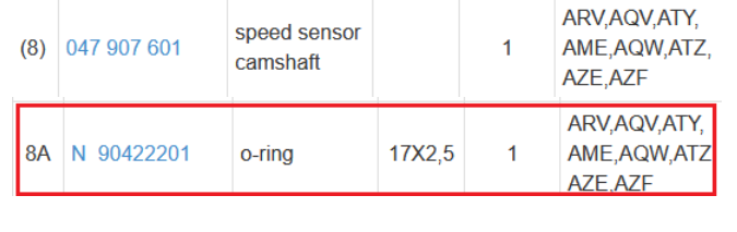

I seem to remember that the o-ring seal for the cam sensor is available as a separate part, which should save money.

Cam sensor and O-ring...

Thanks mate. I will check those. If they are not clogged then i will order new ring or sensor
I have checked the hoses now and none of them are clogged at all. So it mus be the rubberseal that is bad. So either i order new seal or i buy new sensor i need to check with my local workshop.

Sensor is replaced now. The seal was little bit worn out.
