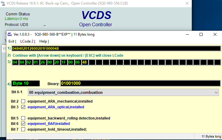

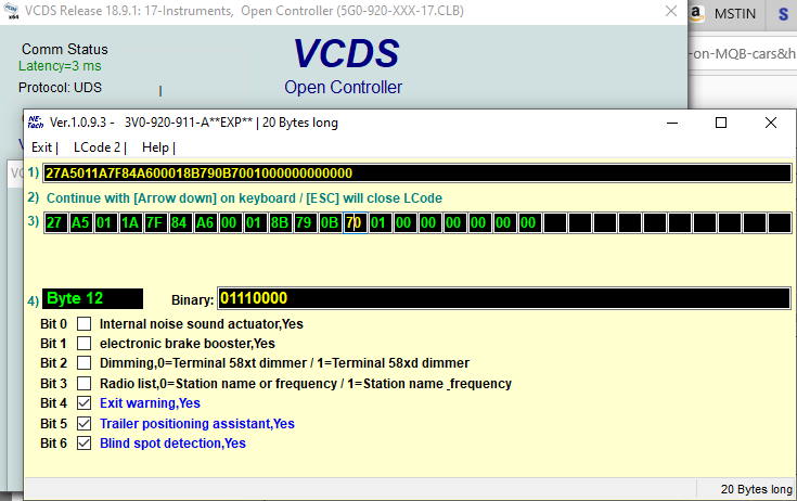

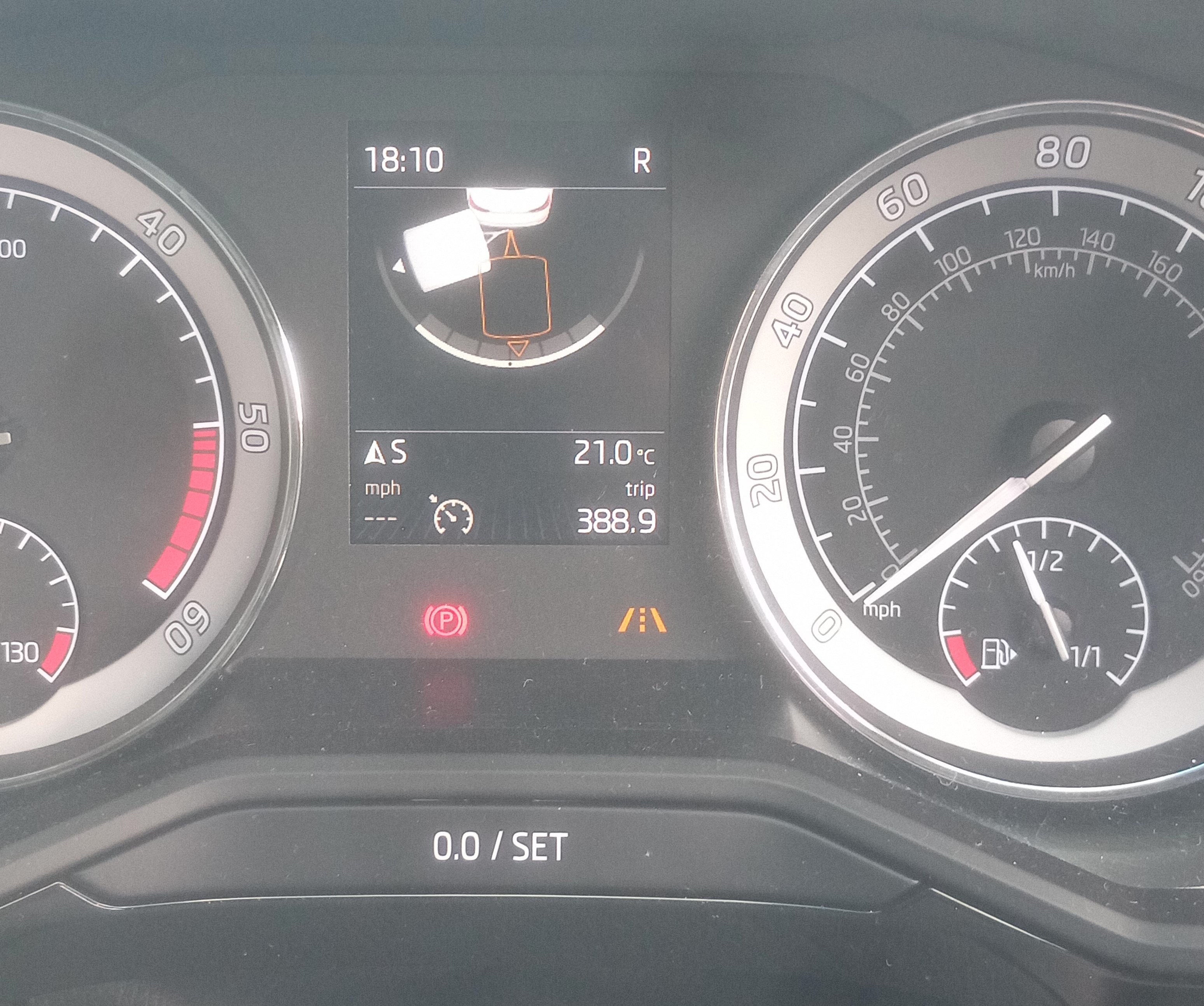

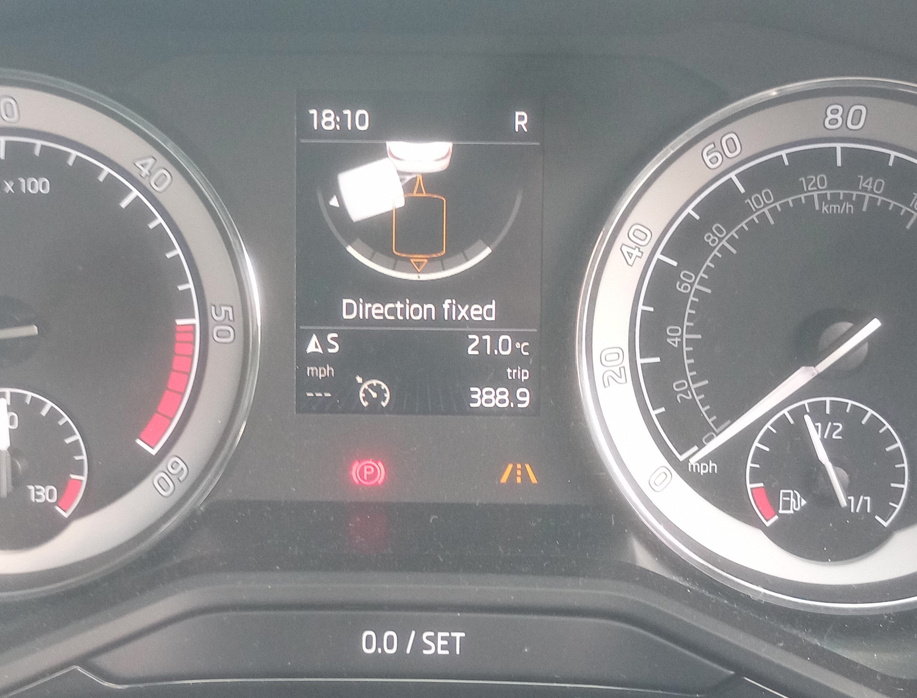

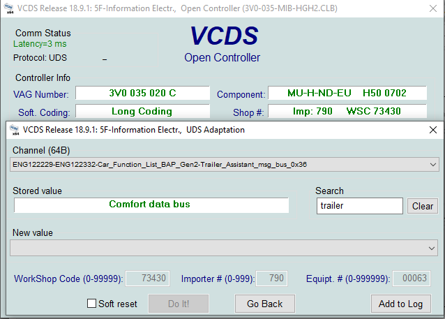

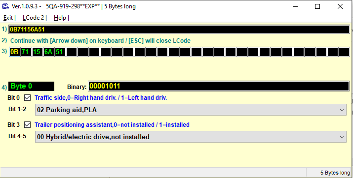

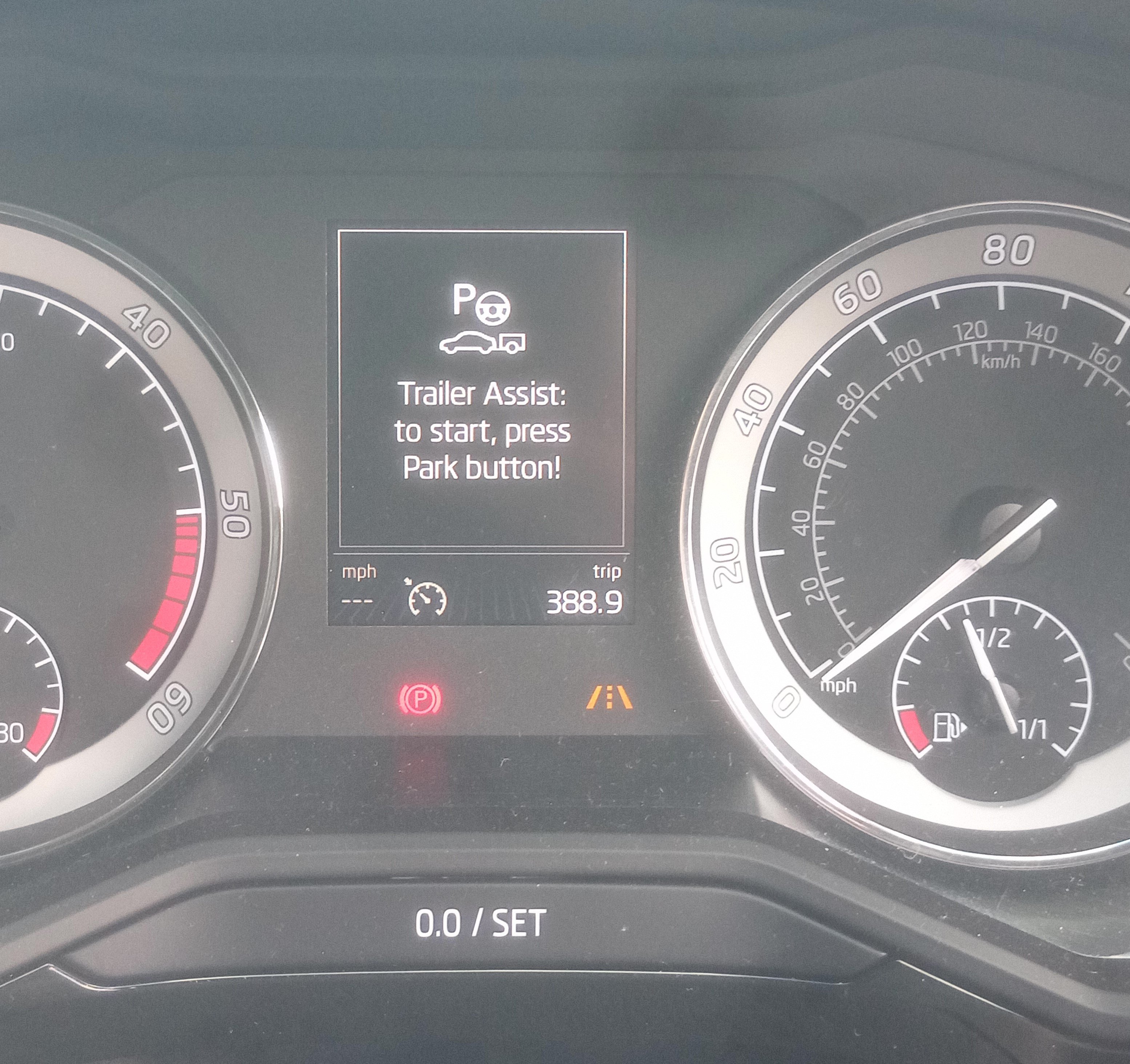

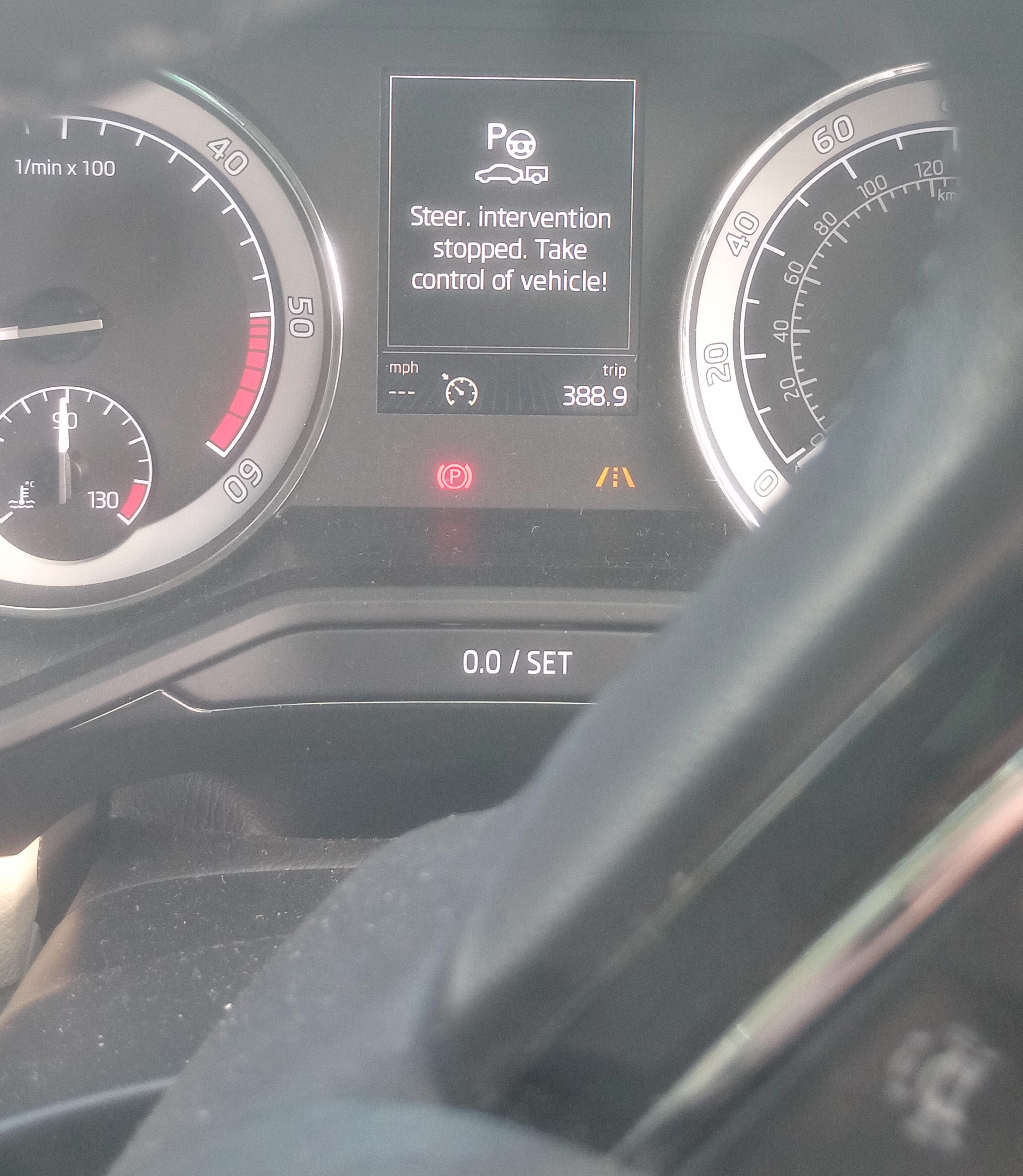

  9. My rear washer blocked up, tried cleaning the jets which didn't work. I removed the boot liner and tried to clean by removing the pipe, still blocked. Then I tried to remove the plastic 90 degree bend into the motor, I've cleared the blockage but snapped the plastic piece. Ooops. Does anyone know if it can be replaced? It's the inner part of the clip, not the outer. If so do you know the part number? Thanks
