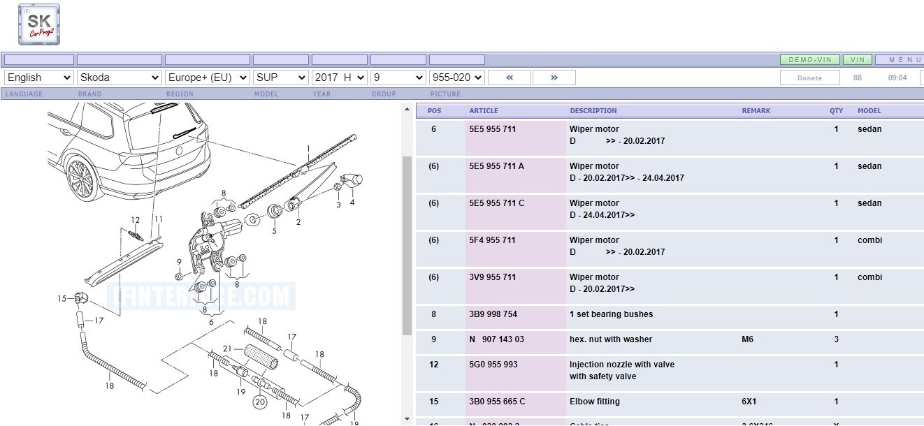

May be this can help... I didn't catch which part, you want to replace 🤔.
Thanks for this, mines the hatchback which sprays from a different location, I don't suppose you have the picture for the hatch do you?
@PhilD2 No sorry. I don’t have specific view for the hatchback. But they rarely give specific view for hatchback or Combi version on this online ETKA.
Nevertheless you can check on the last column on the right, whether the P/N applies for Combi or Hatchback version.

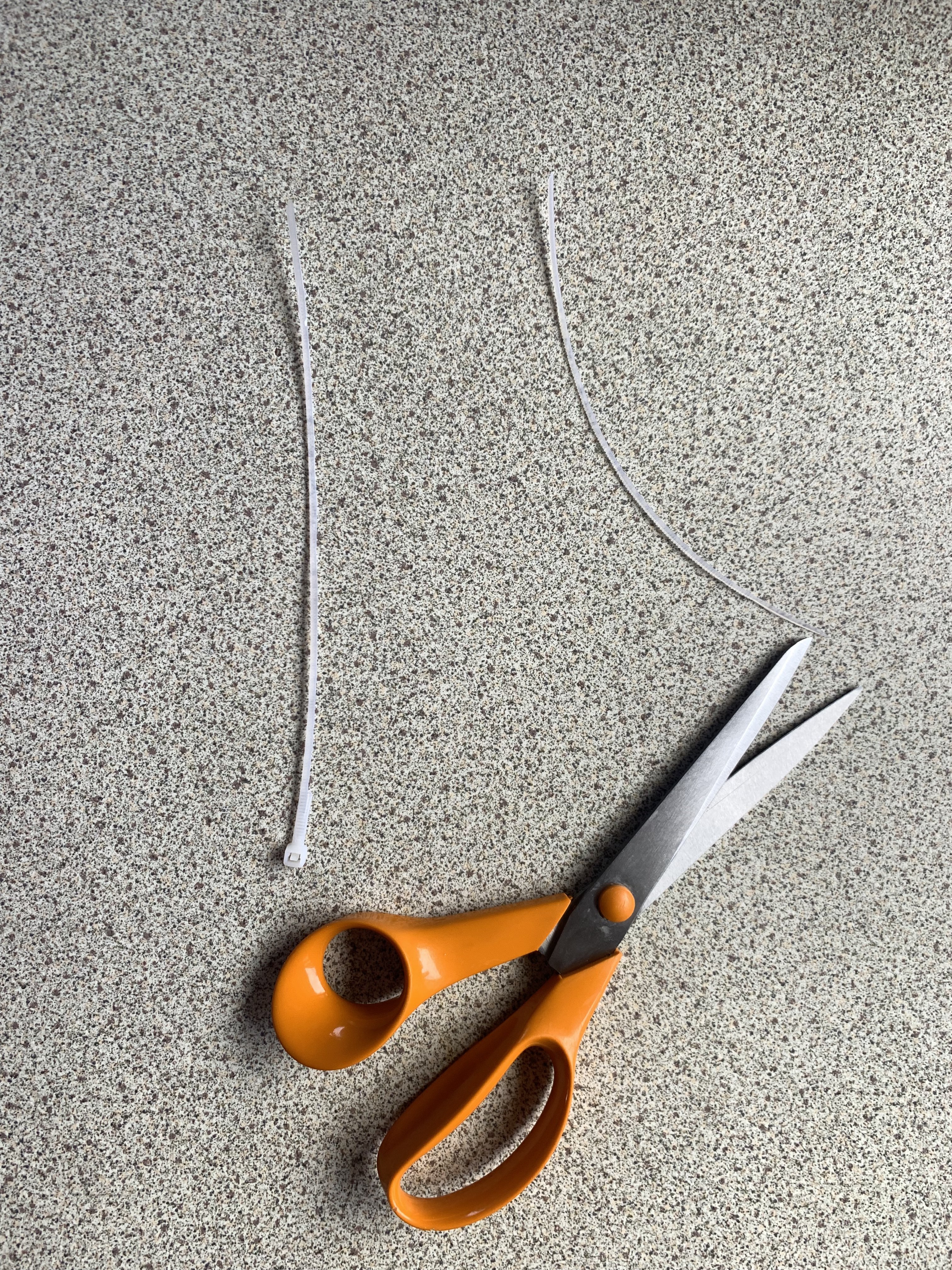

So I removed the jet unit and poked a thin cable tie down the feed tube but it was too short to reach the bottom. I got a much longer but thicker tie and cut it down the centre to reduce its width. I poked this gently up and down the pipe hitting the bottom of the 90 degree angle and after a few goes, hey presto, the water bubbled-up the pipe and out of the top! The car had been standing for 6 months following me
rescinding my license following a suspected stroke, so I’m sure it was just blocked by the screen wash crystalising at the bend. Anyway, works perfectly now and thoroughly soaked a couple of people on the NS and OS pavements earlier this afternoon; oops… I really must re-adjust them jets!
Edited by numskull
Well done numskull. Great result. At least you didn’t have to open up the rear tailgate.
Yeah that filled me with dread! At crossed my mind when looking at PhilD2 pic was that the 90 degree joint was probably at the lowest point of the pipework, so it was probable that any blockage was there, so just a lucky guess really.
