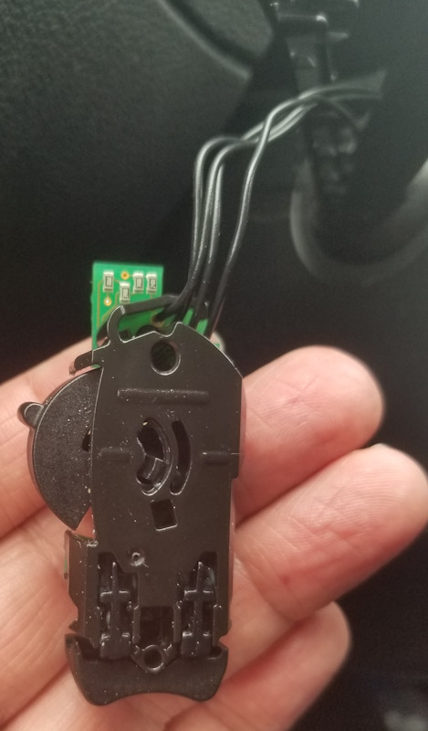

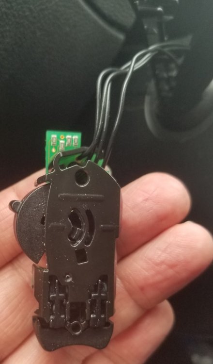

Cruise Control Switch Cleaning MkII
I'm following the excellent Octavia guide to clean my Superb cruise control switch, but it's different and doesn't look like it comes apart to clean! Any ideas please?
