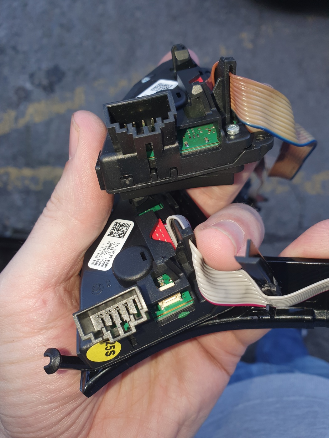

  1. Great thread @Tin82 The steering wheel buttons I got supplied with do not have the connectors for the DSG paddles. Part number 3VD 919 719 B The footprint for the connector and associated circuitry is on the button pcb just unpopulated

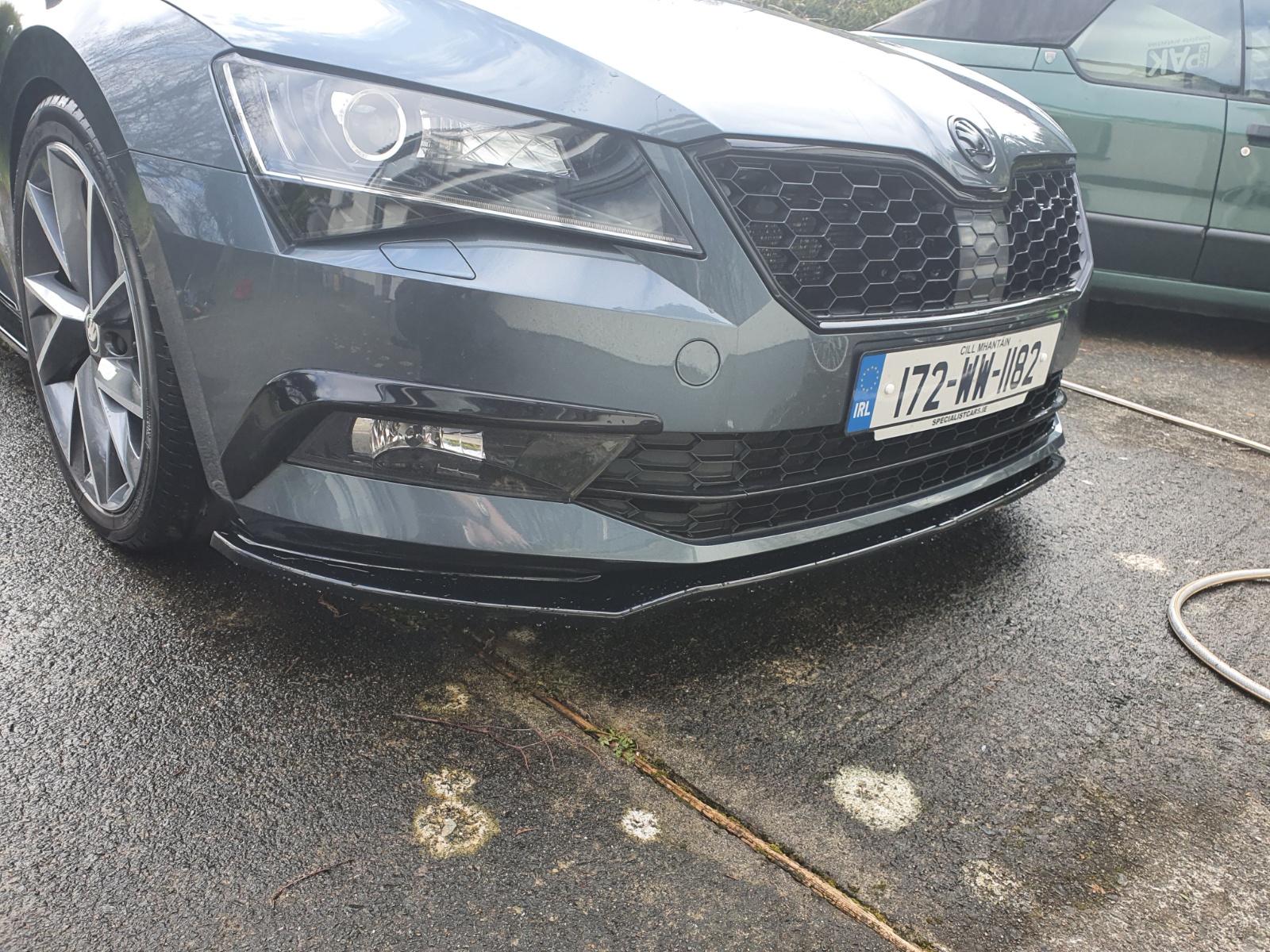

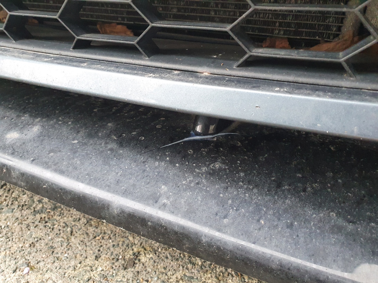

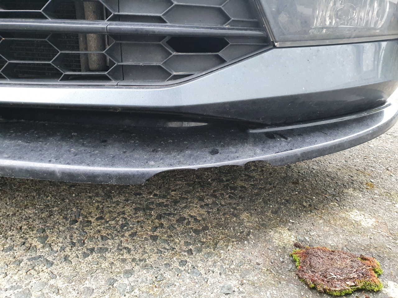

  2. New splitter fitted after the original one gave way at speed. I think i prefer the look of the new one and it should be a bit safer at speed bumps! The old one:
  3. While we're at it... anyone have the correct part number for the virtual cockpit steering wheel buttons with paddles. I went to fit mine and the paddle connectors weren't there 😔
  4. The trim I got/used isn't the carbon fibre of the dash and I was told the carbon fibre version wasn't available.

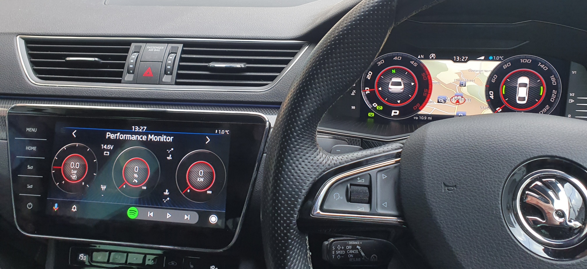

  8. After a bit of hoop jumping (and help from here) the virtual cockpit retrofit is done and all working. RS theme on the VC and Android Auto Performance Monitor ties together nicely

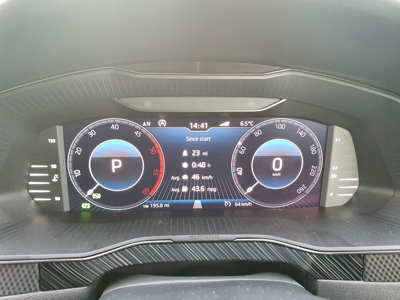

  9. Oh hang on its just updated to RS theme. I changed to 280kmph set the obdeleven app to classic theme then to RS and it worked!
  10. Speedo end (called tachometer end value in obdeleven??) was set to version 0 (260kmph) but I just changed it to version 2 (280kmph)

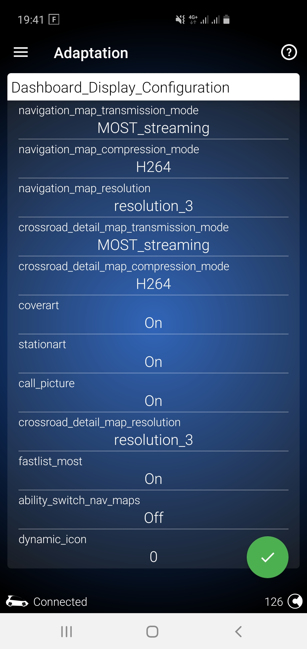

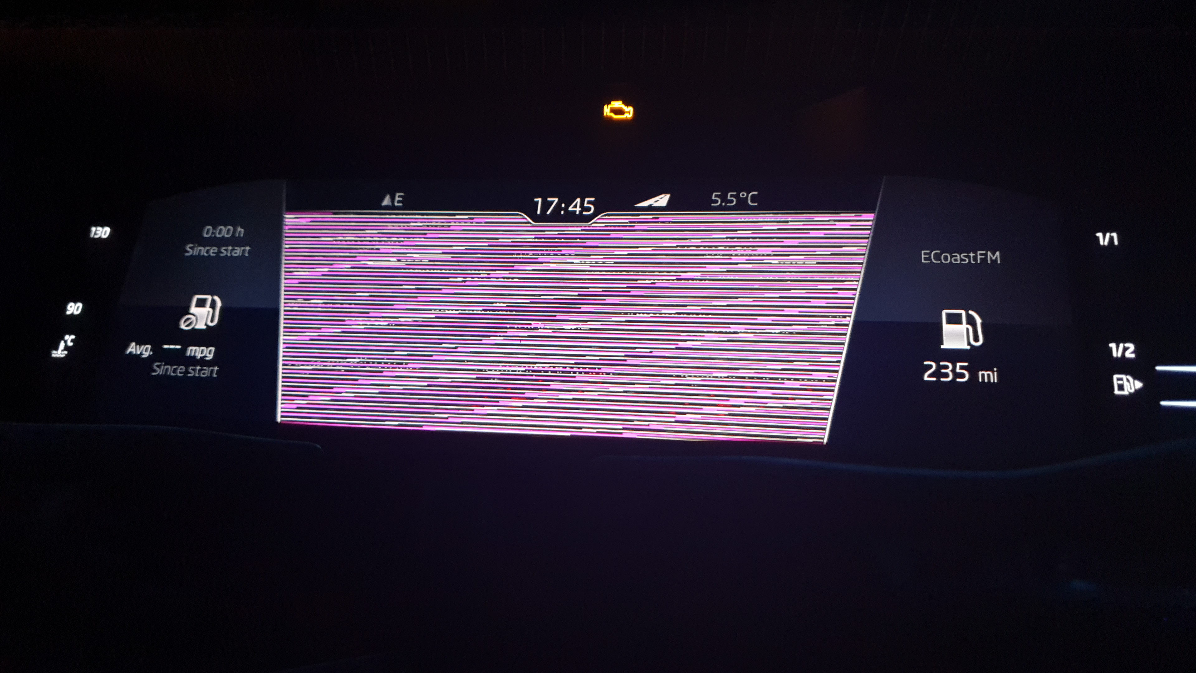

  11. As mentioned elsewhere I've recently retrofitted a virtual cockpit, all coded up and working with maps. I've tried to activate the RS theme with no success. Using both the obdeleven app and setting the adaption manually (tube and display depiction set to version 3). Anyone any clue (from searching I'm definitely aiming this towards @SashaGrace)
  12. @RomanB I left the resolution setting as you had advised above and parked up. When I started it after a few hours it was working. I had reset both the dash and mib via obdeleven but something about leaving it powered off has done the trick. Thank you!
  13. navigation_map_resolution was set to resolution_1 but changed to 3 and hard reset the MIB but no change Is there a suitable equivalent in obdeleven?

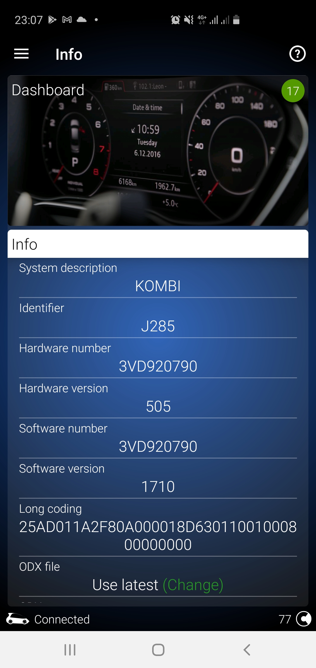

  14. Hi all. I retrofitted the virtual cockpit and had it coded remotely a few weeks back, all fine. I wasn't able to fit the fibre optic at the time because I have the Canton sound system so needed to buy/make a fibre optic splitter. I installed the fibre optic and splitter yesterday but am having trouble with the maps displaying all messed up. Sound is working fine and the map display is changing as I move so I'm happy the physical installation is OK. I spoke to the guy who coded the cluster in and followed instructions to disconnect cluster power attach fibre to MIB and then cluster and reapply power. All combinations of connections result in the same output on the clusters MIB firmware is v1440, cluster firmware is 1710 Has anyone any ideas what to do here??
