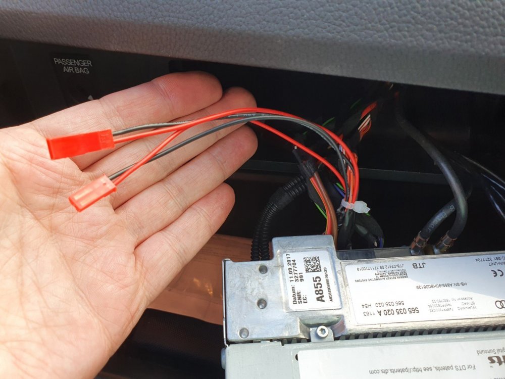

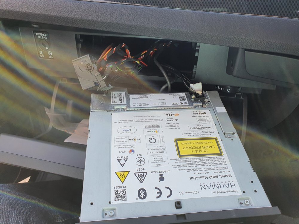

I used Tyrone at Cartechnics (https://www.facebook.com/cartechnicsuk/) VC and steering wheels buttons were supplied for £850 and £120 respectively. This included the coding etc. Had i been local to him he would've fitted for the same price. As i have the Canton sound system i needed to buy a fibre optic splitter which was about £15 on ebay. Fitting is fairly easy if you're used to working with your hands in cramped dashboards! The hardest part was running the fibre optic from the cluster to the MIB in the glovebox. You'll also need a working vas5054 if getting coded remotely

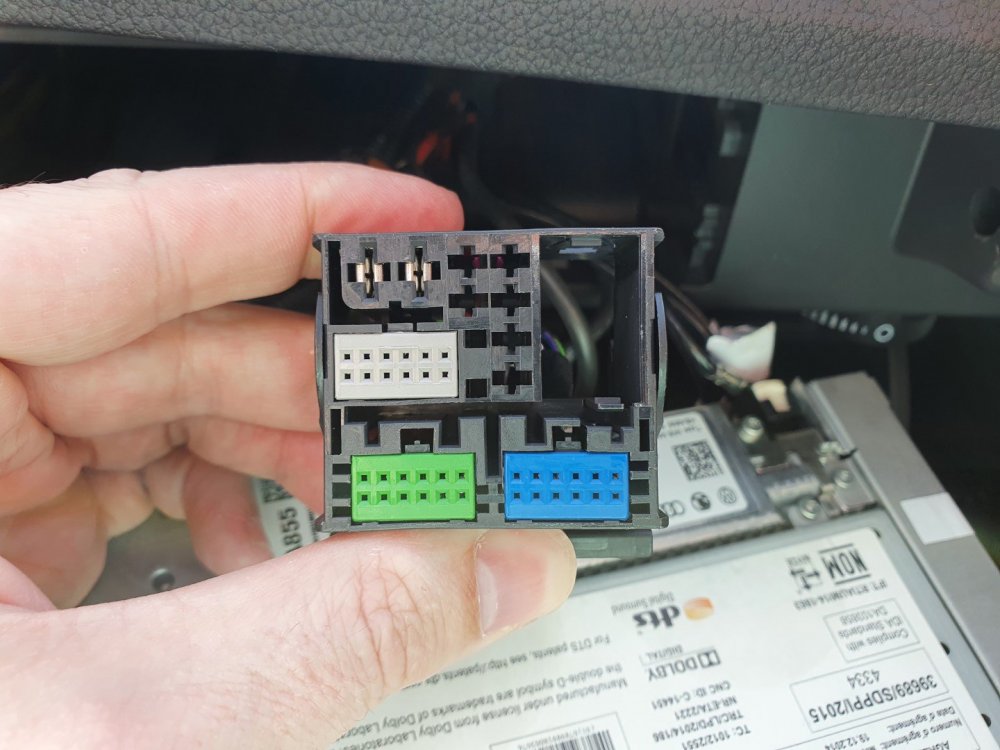

@RomanB I left the resolution setting as you had advised above and parked up. When I started it after a few hours it was working. I had reset both the dash and mib via obdeleven but something about leaving it powered off has done the trick. Thank you! -

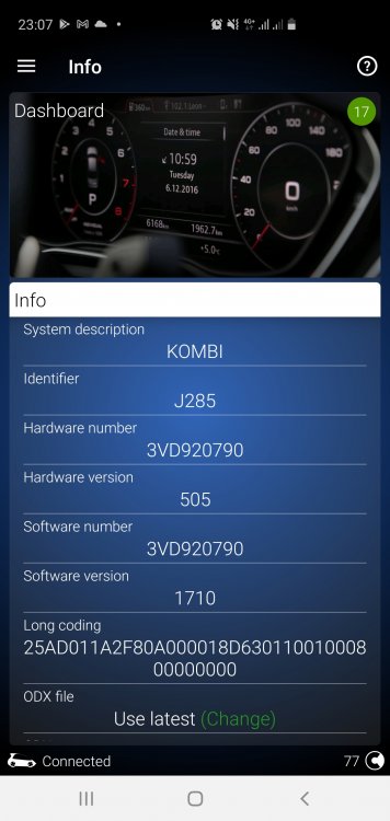

Hi all. I retrofitted the virtual cockpit and had it coded remotely a few weeks back, all fine. I wasn't able to fit the fibre optic at the time because I have the Canton sound system so needed to buy/make a fibre optic splitter. I installed the fibre optic and splitter yesterday but am having trouble with the maps displaying all messed up. Sound is working fine and the map display is changing as I move so I'm happy the physical installation is OK. I spoke to the guy who coded the cluster in and followed instructions to disconnect cluster power attach fibre to MIB and then cluster and reapply power. All combinations of connections result in the same output on the clusters MIB firmware is v1440, cluster firmware is 1710 Has anyone any ideas what to do here??

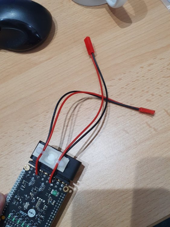

I bouht myself a Macchina M2 and wanted something to play aorund with. I tapped into the two CAN BUSes on the MIB (convenience andinfotainment) and with a little bit of pointing arounf using SavvyCAN i was able t isolated the packets teh MIB was sending to the BCM. Attached is a video of the ambient light colors cycling by themselves (well with the help of my laptop ). Originally i was going to go for the LIN BUS directly but at least this way i get the colours on the screen/dash instead of just the hardware lights. Possibilities from this poking around are controller for normal 12v RGB strip that is linked to the ambient lighting or bluetooth app with RGB colour wheel for maximum colours - any other ideas? ambient.mp4 -

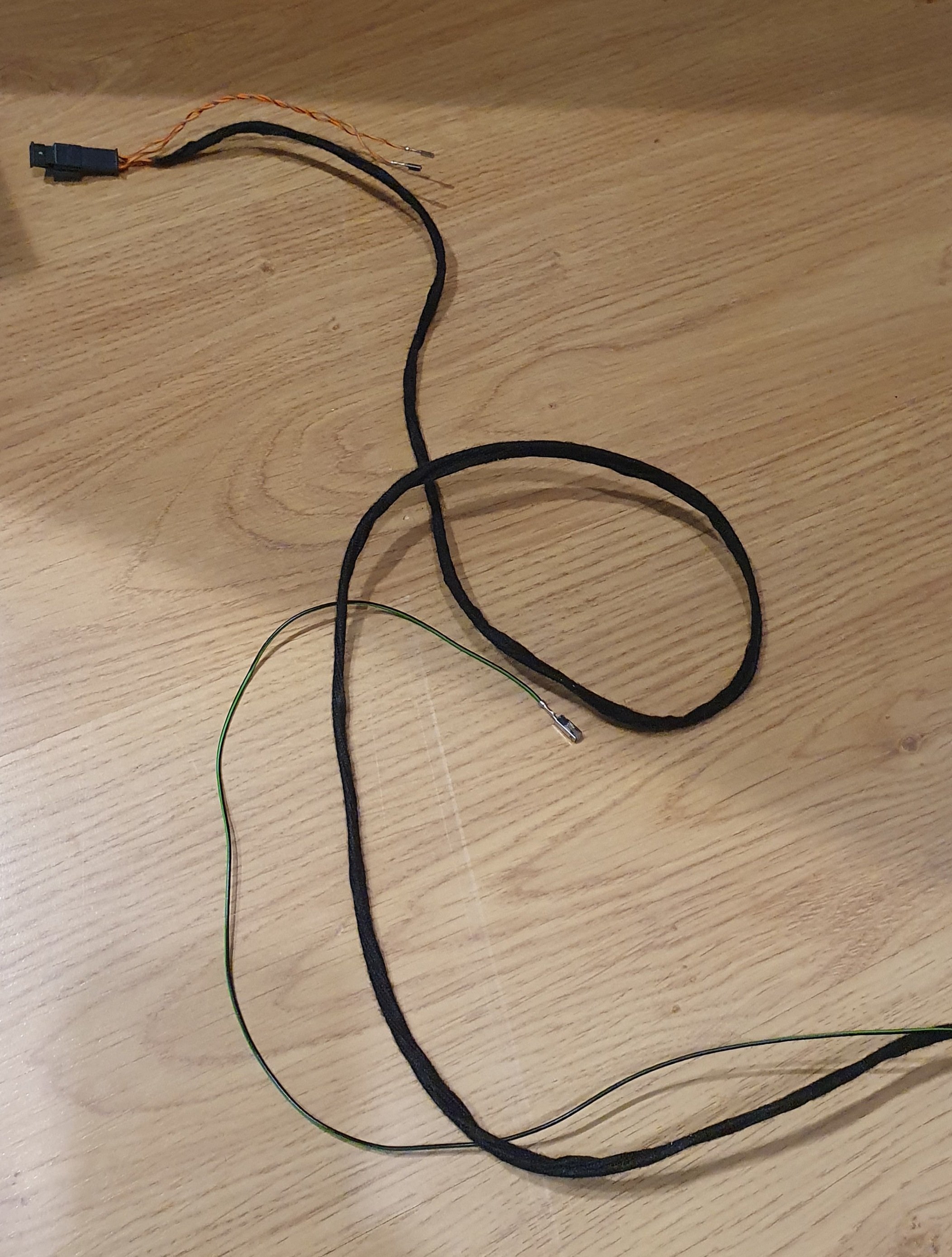

Hi @Camarao69 I have my cable and am looking to start wiring, my loom has this extra terminal that yours doesn't. From looking at wiring diagrams I think it is a 12v feed? Can you tell me where you wired into the CAN extended bus? -
