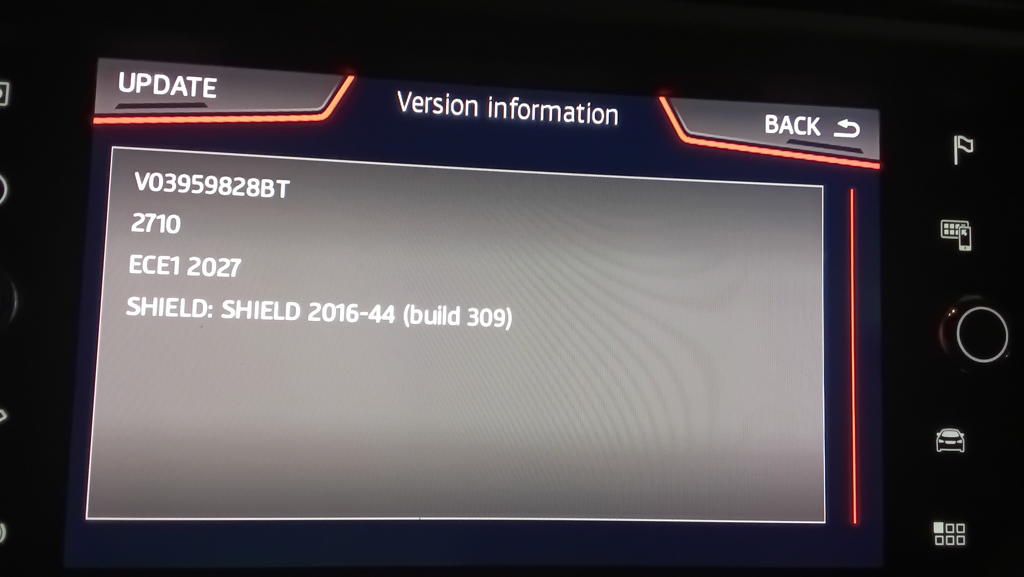

    I can offer you post 1 for Seat which is the same where I have distilled what's said here. Use the link you are using, not the old link in post 1, but it does tell you how to give it a poke to start it off, gleened from you good Skods folk. From a Skoda Mib3 user "Step 6: on the Navigation screen, on the bottom row, press "Settings" > “Version Info“ > "Update (SD/USB)“... the car engine does not need to be running, and if the ignition shuts off before the update finishes, just press the engine ‘start’ button once and repeat the above procedure from Step 6. The Update Progress Bar will resume where it left off so you don’t have to start updating from scratch.... When complete the YY.MM will change. Photograph before and after." This is where the usb with led light come in since they flicker when data is being copied. Skoda folk like them. You arent thinking its not working when it is and the reverse. https://www.seatcupra.net/forums/threads/updating-the-inbuilt-mib3-mib-4-satnav-offline.472408/ The manual pdfs I put in post 1. Getting the files in the route unzipped and a blank USB in exfat is the key. Pesky Macs leaving dross on the drive is another issue. But as said there are a few people where technical issues have prevented the map update working. Details on those Briskoda map posts. If its a car not in the region where it hadnt been sold, then you need a retrofitter. Turkey and the Middle East and Africa are candidates for that one.
